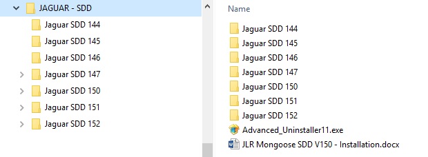

I've been stuck with disappearing SDD files before and made sure it won't happen again.
Send me a PM if you can't find an online source to download V1.50.
