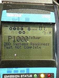

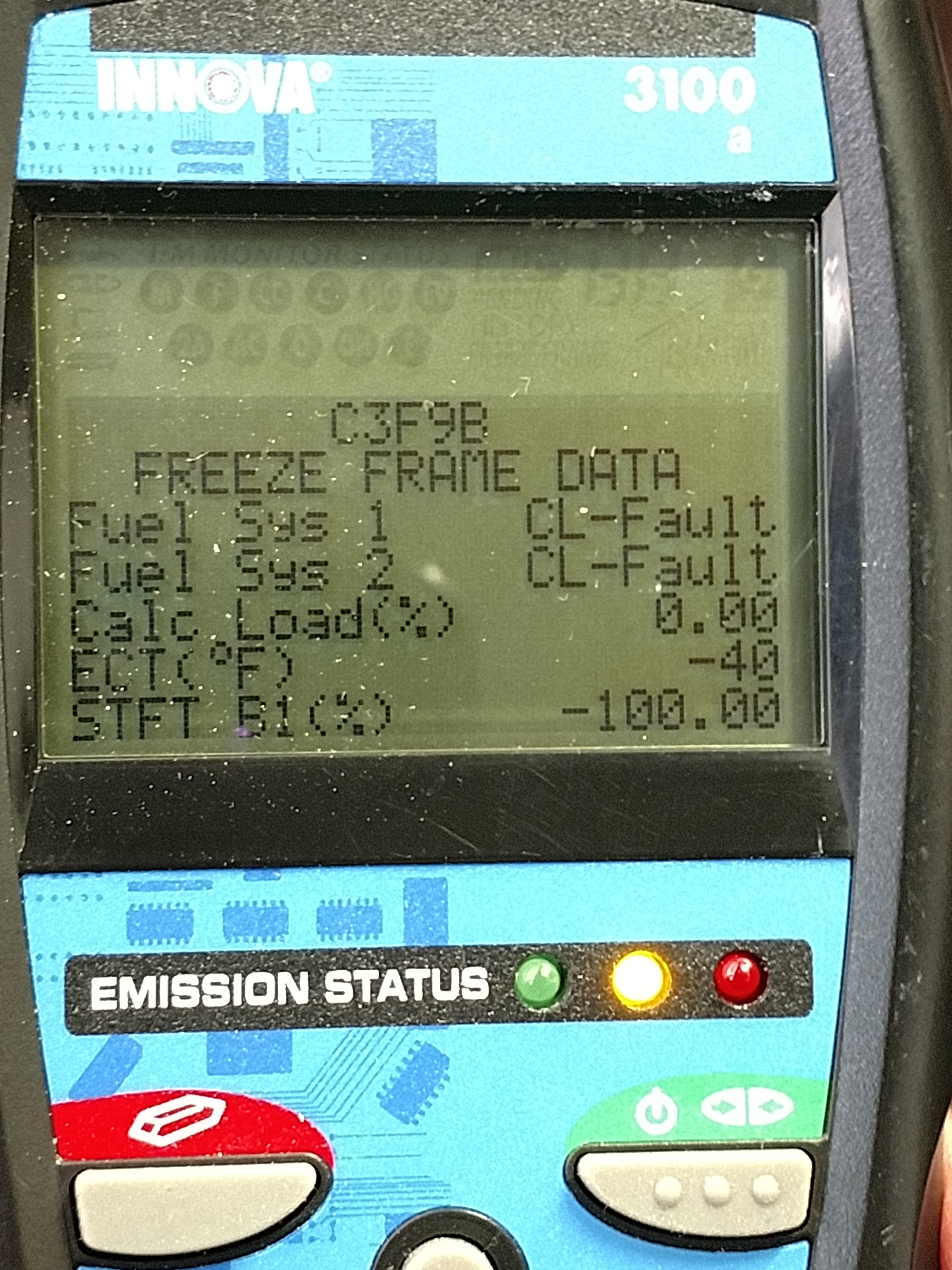

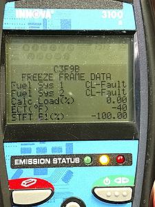

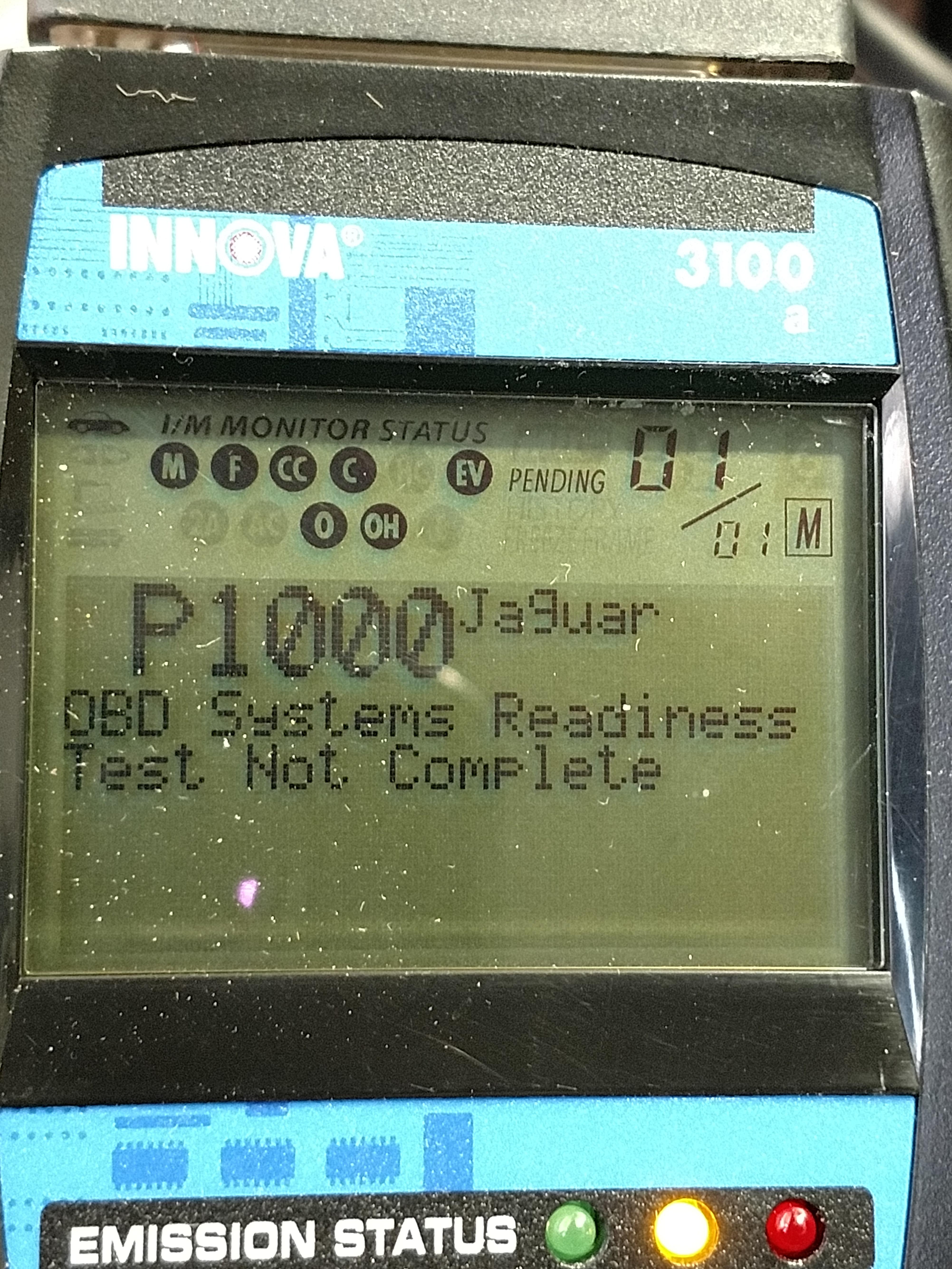

The OBD2 Reader shows the Catalytic Converter monitor is "not ready". It shows a stored code, "fuel system 1 and 2". Here are photos:
Attached Thumbnails Some help for CA smog and "incomplete monitors"-img_20171112_113234214.jpg   Some help for CA smog and "incomplete monitors"-img_20171112_113205897.jpg
Old Nov 13, 2017 | 01:06 AM
  #49
JagV8's Avatar
Posts: 27,546
Likes: 4,924
From: Yorkshire, England
So it's got or had fault(s). What were they and were they properly fixed?
Check what live data show for such as fuel trims (& anything else you can figure out).
