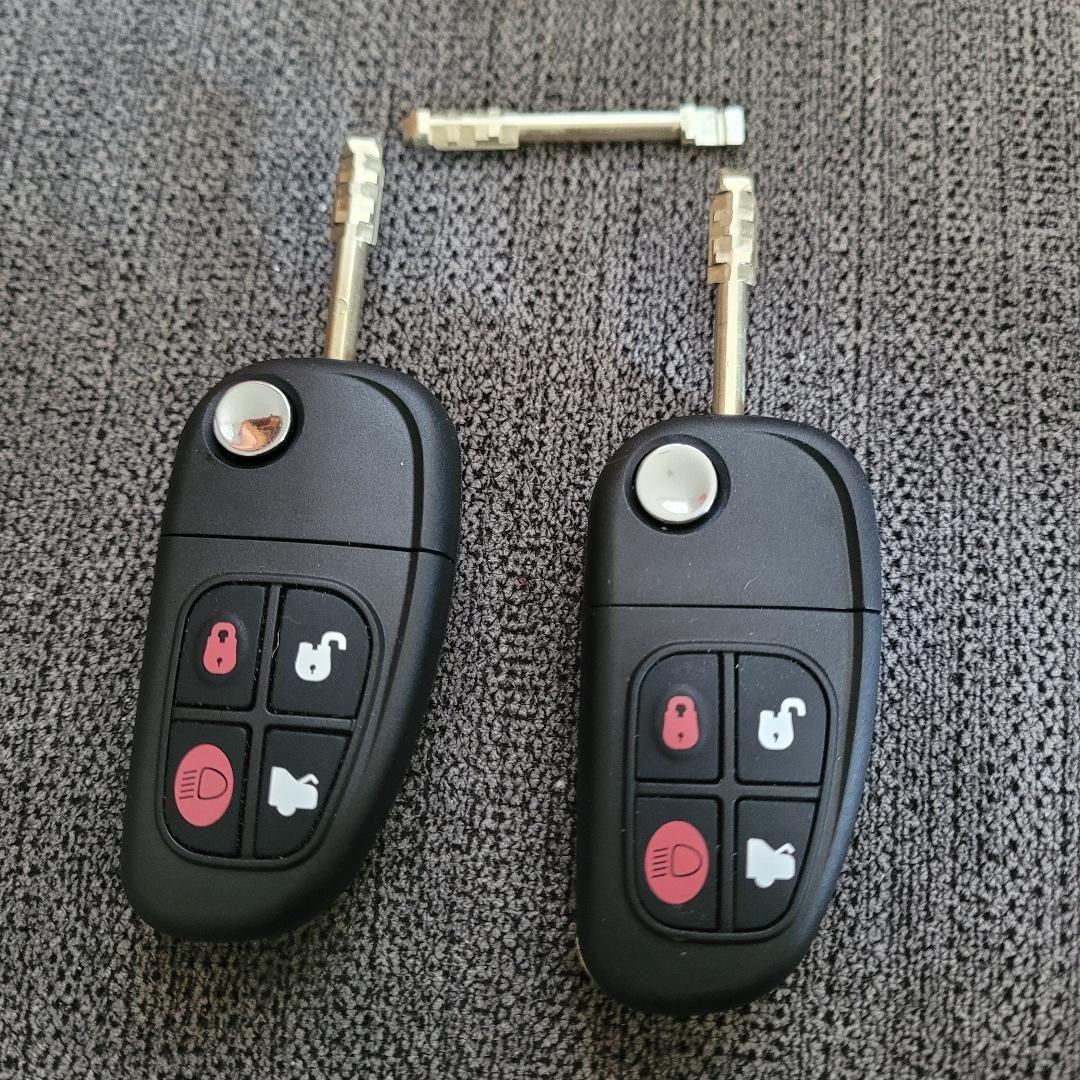

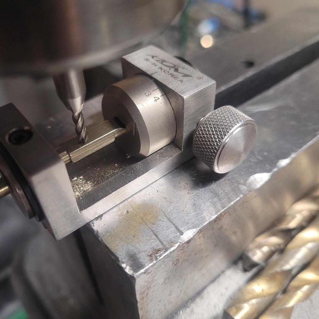

FYI. Due to losing my only key to my 05 X-type, and not finding anyone within 300 miles that can cut a key, and didn't want to go the much more expensive mail route) I figured out an easy way to cut my own keys. I purchased a "Klom Key Code Machine", mounted it on the vice on my mill, inserted the mill bit supplied with the kit, and was good to go. It initially made a few bad cuts on a few blanks keys. then figured out a good technique, I can cut a Tibbe key in 10 to 15 minutes max.

Look kind of like the long away around, but it works. Technically, any key cutting is done either by snipping metal (not doable on a Tibbe key) or by milling.
It's the ANGLE on the Tibbe key that sets the cut. This acts against a sliding disc. The most common code-cutting systems are the Blitz (which uses a spinning wheel) and the type that you are emulating. Your adapter isn't intended to do 8-cut keys, and the key blank in the pic is NOT a Jag ignition key (it's missing the profile cuts that separate Valet key from ignition key).
Great observation regarding the key I show in the image. It is a Ford FO21T7. I purchased 10 of them, at a great price, for learning/testing my cuts. It was/is very easy to reshape the front of these keys to match the front of the the Jaguar key, for testing in the door and ignition. As you can see, the Klom adapter, has the cut angles pre-set, 1 = flat, 2,3,& 4 for the angles. This hack worked well for me. There is enough space in the "U section" of the rotating angled Klom adapter to cut an 8-cut key, since all my Jags are only 6-cut this works for me. (The other adapter that comes in the Klom kit is 6-cut specific.)
