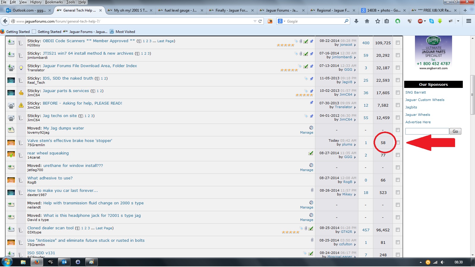

......... and to prove 57 others have read it too!
Attachment 94435
Attachment 94435
