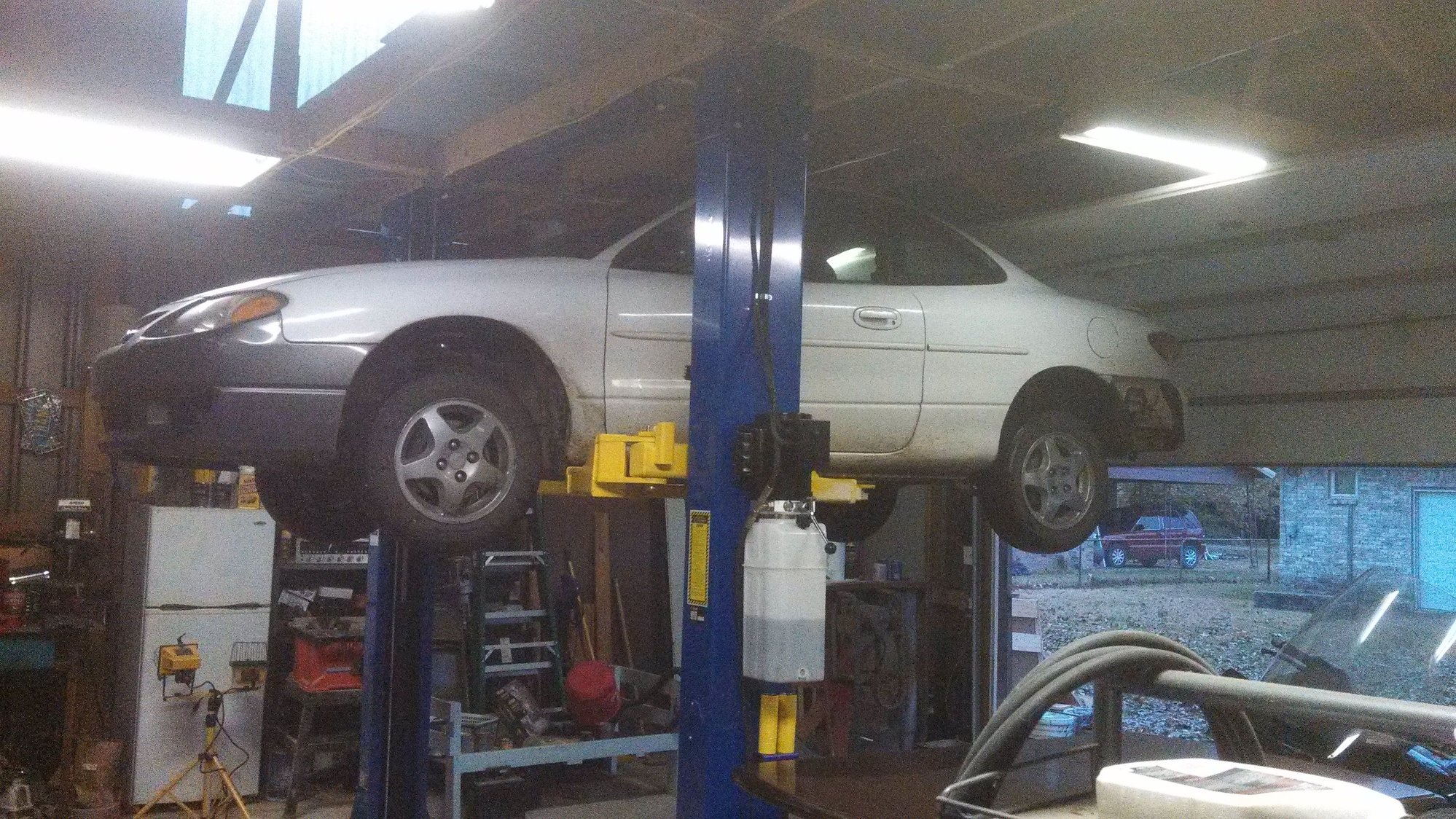

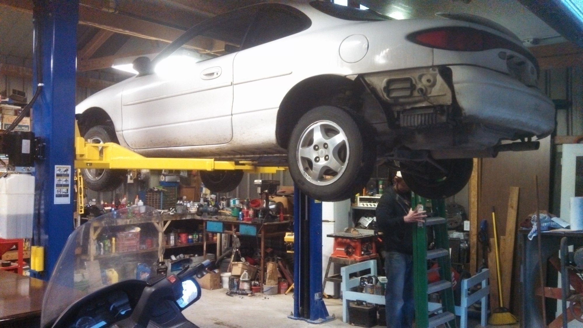

I bought a 2 post overhead, and wouldn't even consider anything else. And yes I've worked on a 4 post lift as well and it made several things more difficult. To name one try removing the whole rear end at once. Just my observations. I bought a 9000lb Atlas lift from Gregg Smith equipment out of Indianapolis Indiana, several years ago and it was $1845.00 delivered to my work, and I unloaded it with a fork lift. My boys and I assembled and installed it ourselves. I had purposely poured my Garage floor to about 6 inches where the lift was going to be. But they recommend 3+ inches of 3000lbs concrete. Which is an industry standard. So if the floor was professionally poured, It should be at least 3000lb concrete. Hope it helps
Jack

The photos are much appreciated. Your lift was a great investment. I anticipate that my costs will be about twice yours.
