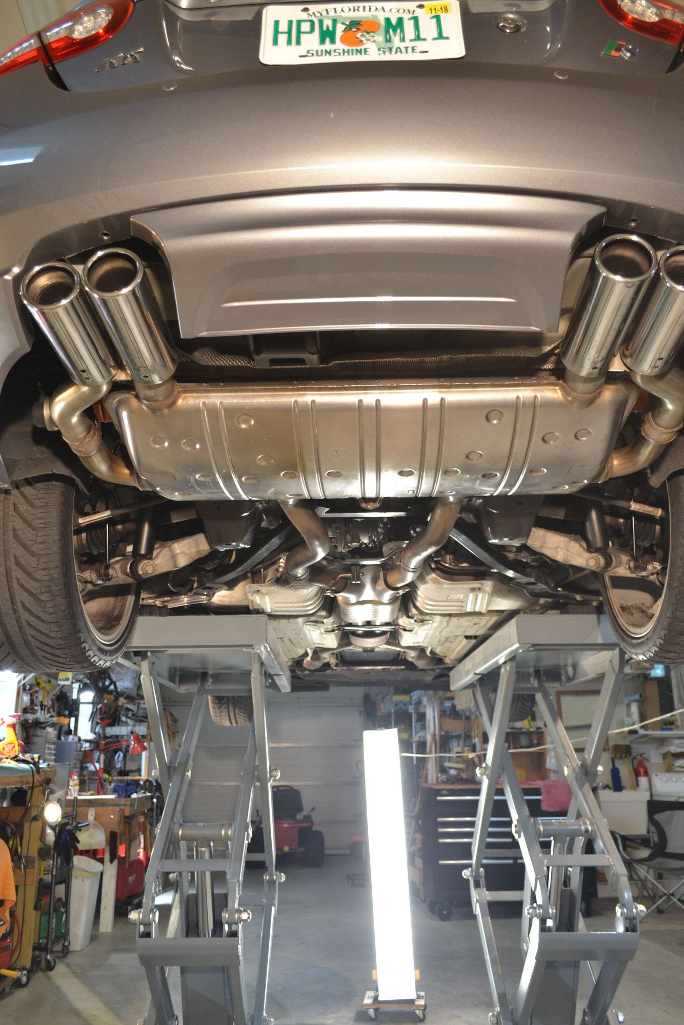

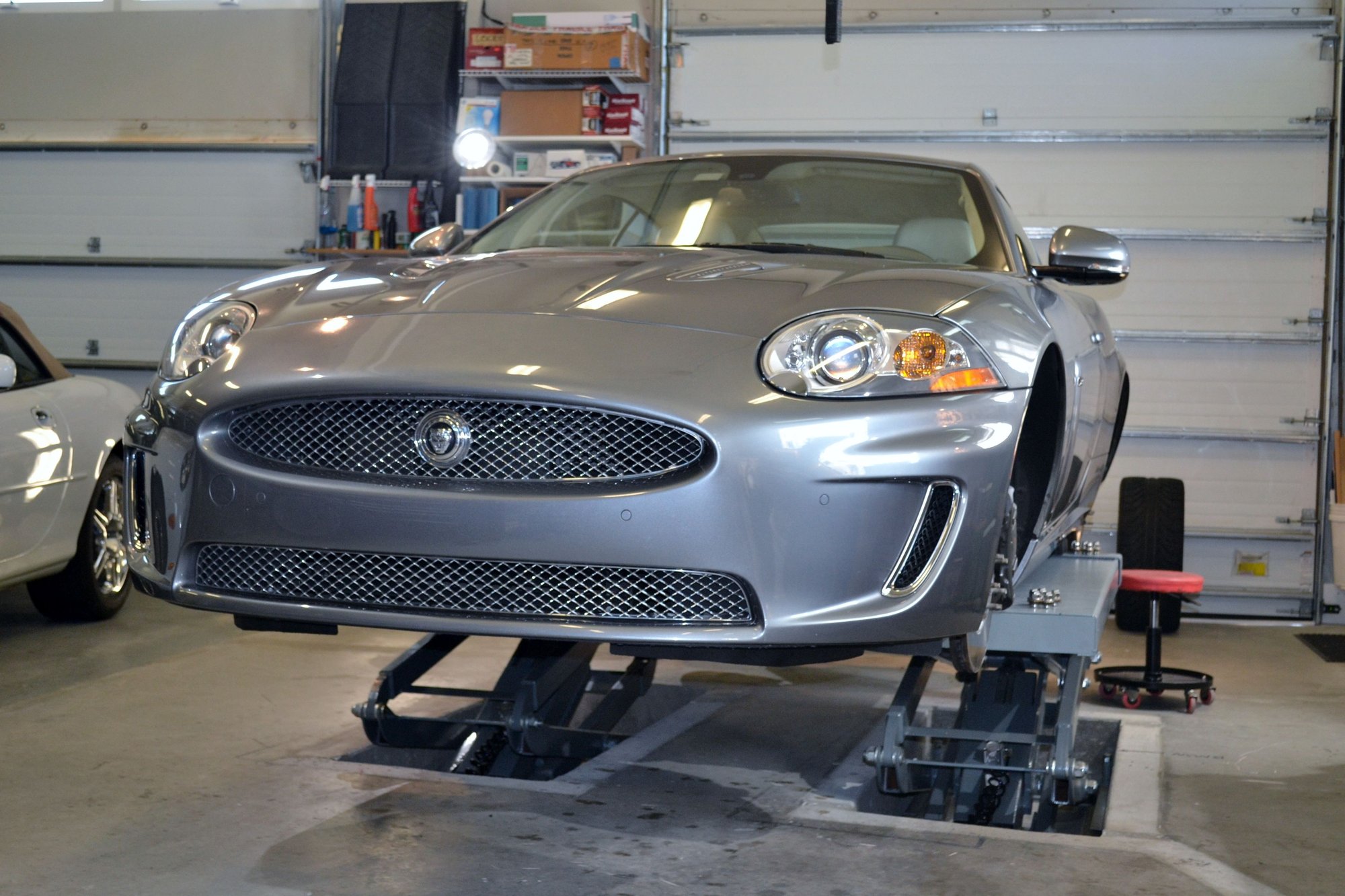

Default I have been lifting like this on all my cars using four rubber cushiions
I use four rubber blocks 2x4x6 , Two each on either side of the chassis rail, I try to get as close to possible to the lift points, but on the Coupe it is always resting on the molded rocker panel being supported underneath by the unibody chassis. I 've done this for years on all of my cars and never had an issue... even on cars with pinch welds.
