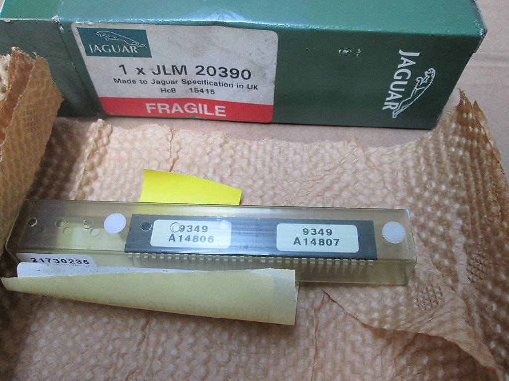

What is this? Maybe I need?
Old Nov 13, 2014 | 05:42 PM
It's a control chip - most likely from an XK8 or X308 ECM.
Old Nov 13, 2014 | 09:19 PM
motorcarman's Avatar
Posts: 13,753
Likes: 9,698
From: Wise County,TX
I am almost sure that they are for S676 (service action #676) or maybe one of the others??? in 1997 or so for the X300 sedans. There were several PROM kits for various maladies in the engine management.
The R493 superseded all the previous PROM replacements so the 'chip kit' you have is useless. All the later PROM kits have LNAxxxxxx and LNBxxxxxx part numbers, NOT JLMxxxxx.
