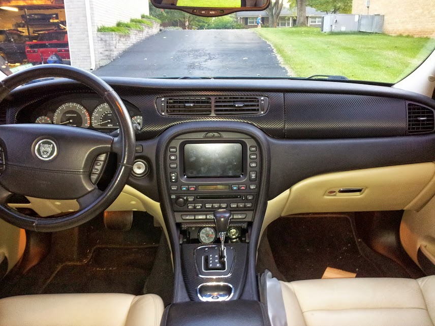

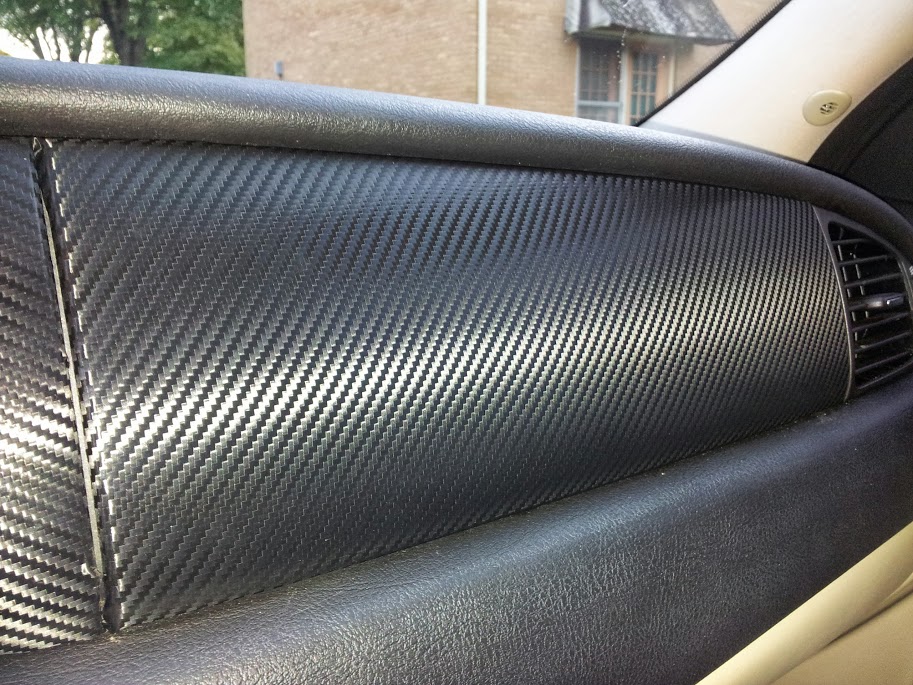

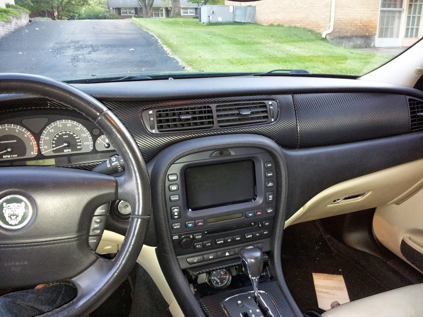

Attached Thumbnails CF vinyl over wood-img_20130930_181347.jpg   CF vinyl over wood-img_20130930_181456.jpg   CF vinyl over wood-img_20130930_181517.jpg

Looks pretty good Michael, nice one

Nice one Mike!
But i'm gonna kick you now...sorry...
Why didn't you keep the grain on the airbag cover in the same direction as the rest of the dash?

lol I was thinking about that. At first I was like "hmm, this might be cool", but now I am more meh. I have plenty left to change the direction though.
Old Sep 30, 2013 | 07:36 PM
Well spotted eagle eyed Cambo.......I would do the change Michael, it'll finish the look for sure.

A few tips for anyone doing this:
- This isn't like traditional vinyl. Don't use soapy water it seemed to make it worse
- Bubbles are pretty easy to get out without using soap/water combo
- It is thicker than other vinyl, so getting it around the edges is tricky
It lays down very easy and looks good with little effort. I used 3m scotchprint 1080
