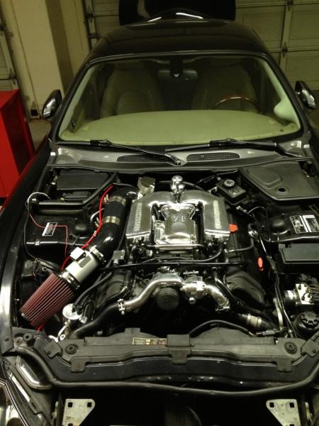

This is the seperator I use.
JLT Oil Separator (2005-10 Mustang GT 4.6, passenger side) [JLTOSP-GT05] - $119.00 : JLT PERFORMANCE, Home of the JLT TRUE COLD AIR KIT

Man there is a lot of spaghetti in there!
But I never get tired of looking at that engine bay.
thanks for the info.

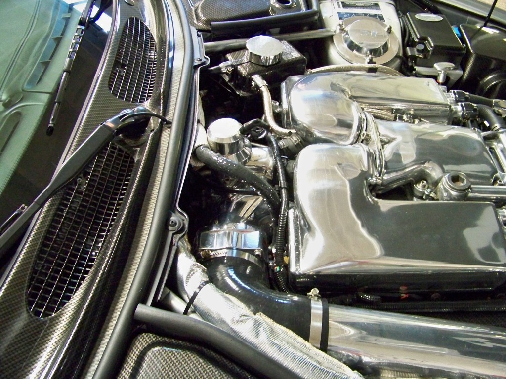

I opted for a catch can from RX Performance. Haven't got many miles with it yet but it seems well made and was easy to plumb.
RX Catch Can w/ Single Check Valve
Can is next to the air cleaner and I replaced the check valve with a fitting that has a hose connection. It's a 4.2 so the part load breather is on the right side.
It's not the greatest pic, just one I took with my phone while assembling. And please not too much grief about the filter being in the engine bay, I don't plan to leave it that way.

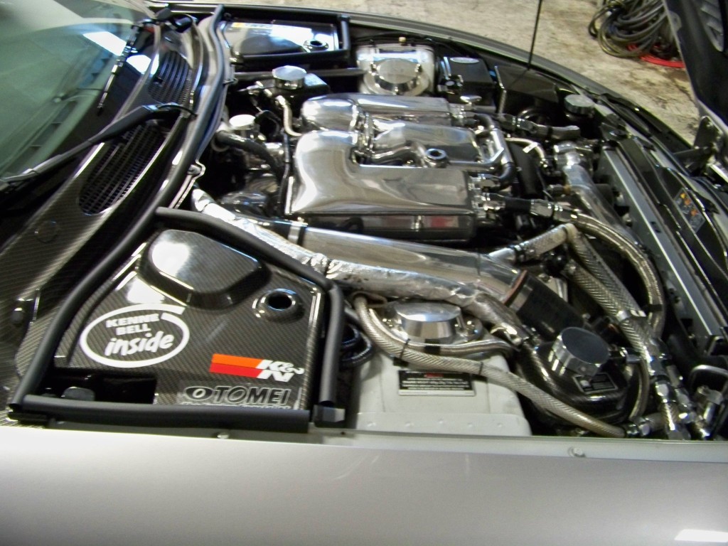

Is your throttle body on upside ?

JgaXKR,
90 deg rotation from "standard". There isn't enough room between the AC line and the wiring harness that comes off of the top of the bell housing to get it in there the other way. The stepper motor shouldn't care about orientation, and I have it all back together now and the car drives great. Chasing another issue at the moment with the fuel trims but Avos has a hunch it is MAF related.
Plums,
Those of us that are of such questionable sanity as to put Andre's twin screw kit on do have a side mount TB, that is correct.
Technically yes, there should be a can on both loops but 90% of the junk comes through the part load breather side. When I had the intake off there was no oil at all in the full load side after 10 years and 70k miles. Between those two things I was swayed to put the can on the part load breather side only.

After fixing my P0102 / restricted performance today I was driving around without the wall separating the intake from the engine hotter air and noticed a loss of power, so I thought I would re-install the cold air shield, and then went one step further and insulated the intake tube with some aluminized blanket and HVAC tape. I was originally thinking the air goes by so fast, so how much heat could it pick up, but then I thought, the air goes by the charge coolers that fast too, and they still cool the air significantly.
Question is:
Should I paint it flat black? or leave it looking like an aluminum foil hat that keeps the alien mind control devices from working?
The rubber bands are temporary
Attached Thumbnails 92mm MAF installed.  Yeah baby !!-2013-05-14-21.04.50.jpg   92mm MAF installed.  Yeah baby !!-2013-05-14-21.04.32.jpg
