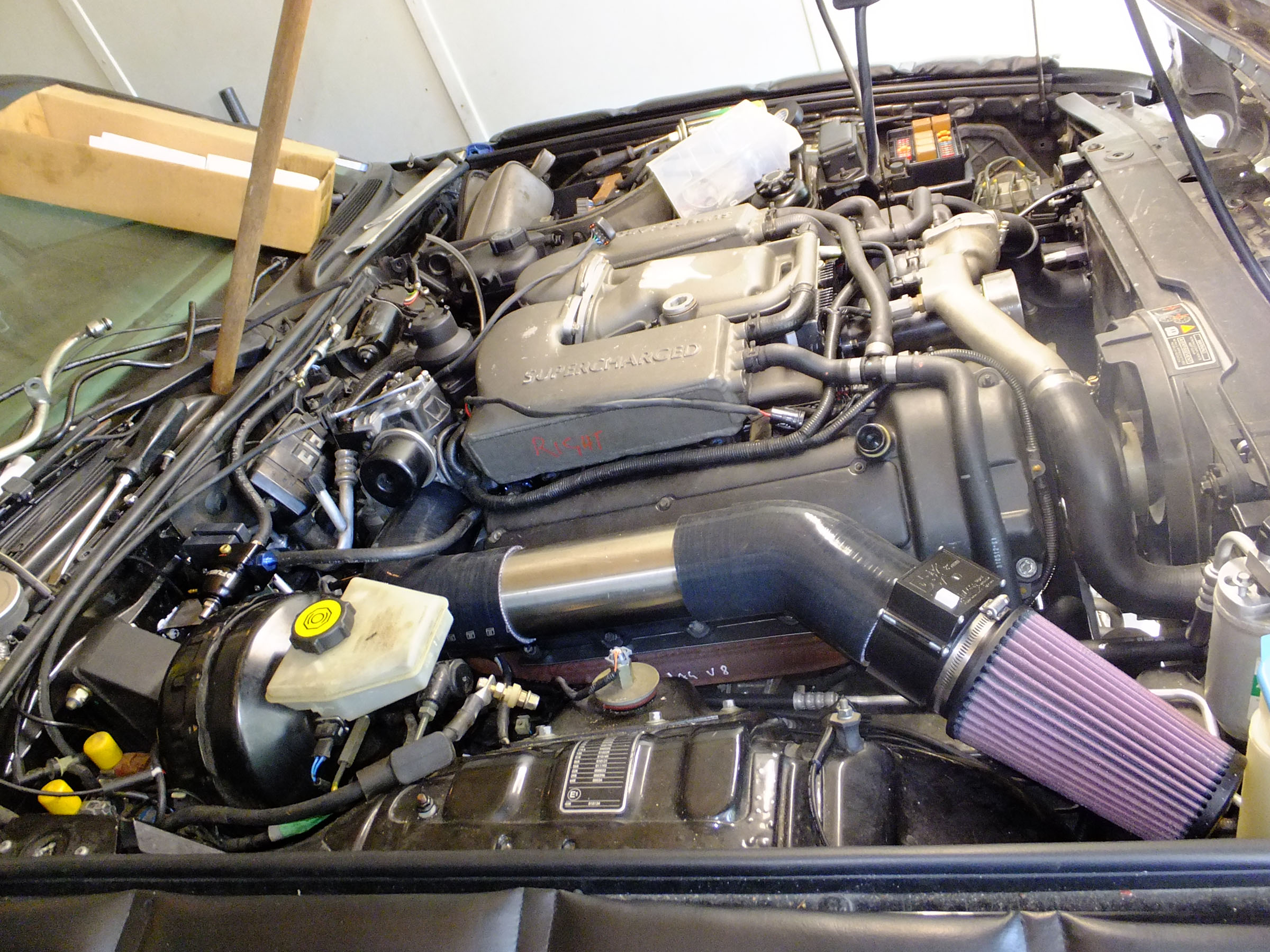

Hi - here is a different solution to the same prob, mine is a 1999 XJR with a Andre Supercharger - Adeco Maf and a maxbored 81 mm TB - and a adjustable fuel pressure reg. - I am in the mock up assembly at present, my biggest drama seems to be the heat shields I had to make -

Old Jun 30, 2013 | 10:51 AM

I originally posted the pic after seeing the other 2 posts - depicting intakes - Somebody should take a big stick to MIna - My intake will also be properly insulated when the job is completed. I noticed your mounting of the AIT sensor - I intend to thread mine inside the intake, and insulate the MAF and aircleaner from the engine bay.
