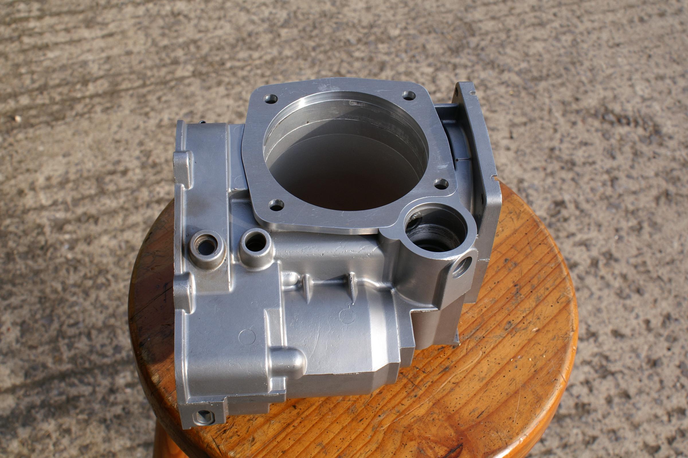

Hi,been a while since i posted here, did not want to be caught out again with incorrect info about TB mods possible(ET said 90mm but really meant 85mm!). I have a 1999 XKR and have just received pictures of my TB which has been modified to 90mm. TLJaguar has been working with an engineering company and have managed to complete the mods required so i get the best out of the kennybell being fitted. Should be some pictures below if i have done this right..

Wow, this is exactly what I've been wanting to do and have been looking into with several machine shops. Would they consider offering this to others? So I don't have to reinvent the wheel. Price?

im sure if you contact Tom at TLJaguar he will be able to help. I have no idea of the cost as its all part of a Kenny Bell upgrade but if you supply the TB i can't see it being more than £350.

Hi just wanted to give you guys a an update on this small project. I will be writing it all up in a new thread, eventually... The price was way more than £350, way more.. the company (Roger Bywater of AJ6 Engineering) made a new TB from scratch, no boring out an old one! Once fitted to my 1999 model it caused loads of issues with tuning, It was impossible to get the fuel/air mix ratio correct, even with the bigger fuel pumps fitted. The ECU could not be programmed to work with this much bigger TB.. the work around was to reduce the air intake to 80mm, which was not the goal of having a bigger TB.
So my advise is unless you have a later model than mine and the ECU does NOT use air flow to regulate the fuel mix and your garage can modify the ECU, stick to boring out the TB to a reasonable size and don't push your luck like i did..
Someone dropped an extra zero from the above estimate, lol. I inquired about this throttle body from TL.
Were the problems at idle or throughout the rev range? I would think the MAF and O2 sensors are responsible for the air fuel ratio and not the throttle body. Do you think an aftermarket programmable MAF would solve the issue?

Hi. The MAF was programable. But no luck. The issue was not being able to get enough fuel in to make the mix correct. We up the fuel pressure to force more through but still needed about 21% more fuel to make the mix ration at 90mm correct. To do this we need to leave the injectors open for a split second longer which was not possible with the ECU I have. There is a fix coming, new after market ECU, but it's still a way off. I'll find the calc we did and post so you can see the maths behind the requirements.

Hi bigger injectors were not tried. I had decided I want to use the car while a solution other than injectors could be confirmed. I know that Tom was playing about with a new ECU, looks like he is nearly there with it now.
Calcs below..(my email to Tom)
I got one of the guys today to do flow rate analysis on an 80mm pipe vs 90mm pipe, see below
Results:________80mm_______90mm______Flow Rate % increase
ft/min (LFM)_____400_________400___________0%
m/s____________2.03________2.03___________0%
miles/hr (MPH)___4.5_________4.5____________0%
ft3/min (CFM)___86.57______109.57_________21%
m3/hr_________147.08______186.15_________21%
L/s____________40.86_______51.71_________21%
You can see that 21% more air flows through the 90mm duct.
What does this mean? i not exactly sure but i think it is this...
optimum air to fuel mix 14:1
If with the 80mm you are getting 14:1, the engine is performing as it should be. With the 90mm your mix will be something like 17:1, which ties in with you finding of the engine running lean.
Flow rate of standard 4.2 injectors
CC CC
356 388
364 396
356 388
361 392
357 388
361 392
361 392
361 392
360 392
Average flow 375
https://www.jaguarforums.com/forum/x...jectors-83425/
Based on this and the air flow rate it would suggest to me the flow rate of the injectors needs to be 21% bigger to match the 90mm air flow rate ratio, so 453 cc/min would be my guess.
When Tom measured the mix and air flow he calculated I needed to add about 20% more fuel in.. This is the plan. This year should see it happen...

This is a bit odd. Stock AJ26 SC injectors can give well rich side mixture up to 20+ PSI and 580bhp. AJ27 engines with 90mm aftermarket TB and stock injectors have had no problems at all ( better to confirm this by Avos ). My AJ26 injectors were tested at the same place than Waterdragons ( WD: AJ27 vs mine AJ26 ) and they were quite close each others. Please remember that the test is provided by another fluid than fuel. Fuel gives 3% better flow numbers. The safe AFR at these boost levels should be 11.5-12 . 14 and you blow your engine if run normal 98 ( EU ) or 93 ( US ). I have used 46PSI base fuel pressure and AFR 12.0 throught the whole rev range. 48PSI and it's almost too rich to run well at high revs.
I do not know what's your pulley ration, but I guess it's very high if you are in fueling problems with stock injectors and higher fuel pressure.
btw. 90mm flows 26.6% more than 80mm, but the good question is that is 90mm really needed with 4.0.....

I am still waiting for feedback from Tom as I only advised to go with the DBX85 MAF which is tunable, am pretty sure with this MAF you can get it to work properly. Tom was working with a MAF not known to me, so couldn’t help there.
Worst case would be that you are already pegging the MAF, if that is the case (you would get fault codes), then you need for example adjust the fuel pressure, i.e. go from 43 to 55psi max (which gives about 10% more flow), and again adjust the MAF table of the DBX85 accordingly (lower the voltage output by 10%).
What airfilter setup do you have? If you go for the DBX85, I would certainly just add a plain K&N RE0920, that one gives a good flow also over the MAF itself.
