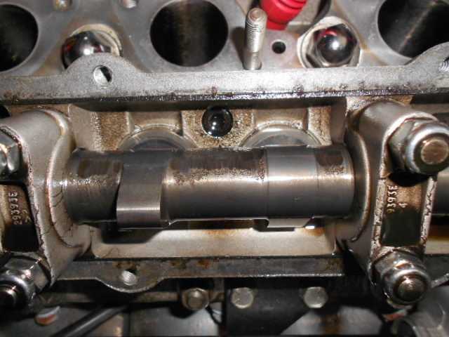

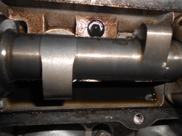

when i had Crane Cams Florida regrind my Jag V12 cams (2 pieces) SOHC, i honestly had no idea what profile to use!
i talked with there head cam engineer(ex employee of Smokey shop), we talked about what i expected, and use of vehicle!
he had them done in couple days, OK they are still in the engine 22years later,kinda old tech.
i also knew Harvey Crane owner, at his home he had a cam profile machine all set up, so he did a run and overlaid the results into a computer against other known profiles , he gave me a CD disc, with all sorts of stuff on it,(which promptly got lost when moving).
any way Harvey said the closest profile was to a 1975 PORSCHE N/A race engine!
had covers off a while back(oil leak), and cams and followers were perfect, Nitrided surface perfect! NOTICE the slight polish on the follower,more room for a bigger base circle, and more lift.
cost at that time $150. each, lot of work getting valve lash set up tho.
Attached Thumbnails Camshaft specifications AJ-V8 4.0L & 4.2L-jag-engine-inside-006.jpg   Camshaft specifications AJ-V8 4.0L & 4.2L-jag-engine-inside-005.jpg
