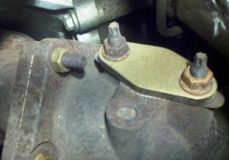

Happily, I found that my EGR tube had already been deleted by a previous owner...I've just had the car since summer 2011.
The openings on the EGR and exhaust manifold were nicely capped off.
I cleaned the electrical connector, but I'm still getting the codes. I'm going to have the intake manifold and throttle body off soon for other business...I'll poke into the EGR a bit more while I'm at it.
