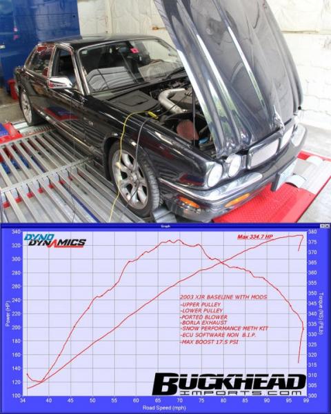

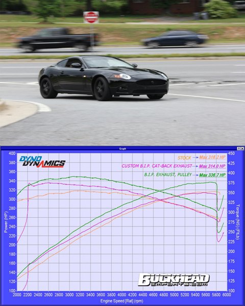

Attached are 3 dynos, although this type of dyno gives lower rwhp (due to the 2 small drums per wheel), the value of these are they were all made on the same dyno. Examine them and the mods I would say.
