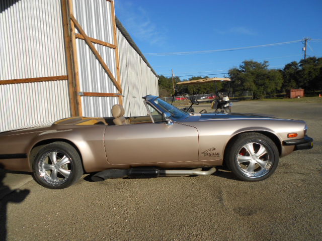

i have many good remarks about my V12 , custom to my specs, ALL 12 cylinders exit from one driver side outlet!
yes little loud but no other car sounds like it!
2.5" down pipes ,no cats, large glass pack mufflers, but 3 ft long 5" diameter turn down outlet!
starts out rumbly(Crane cams) around 4500 rpm goes into torque range, gets attention, then after torque peak, just screams/whines, to around 7000RPM. ALL 12 cylinders.
cars that have exhaust outlets on rear side of car , and you only one side, if behind, 1st your ear hears one side then the other ear other side ,,Mixes up the brain waves! LOL.
