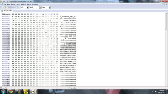

So I got my spare ebay ecu the other day. Wanted to clone my current ecu so as not to worry about downtime in the event of a problem. Opened it, located the 93C86 SOIC-8 eeprom (bottom of the board) and after cleaning the protective layer off, read it.
New guy with a Range Rover. Performance questions inside (not your typical whatnot).-sslugj9l.jpg
Did the same for mine, but wrote my eeprom to the ebay ecu, and started the truck up

Is the PCM using 7052, 7055, 7058 or other CPU(s) and how many? (Some of the S-Types are twin cpu.)
Hi-definition pic may help
Stock tunes are (or were) on IDS etc disk(s).

Single 7058. I have to find the cable for my digital camera, then I'll snap some pics. The stock files on the IDS discs are need to be converted to a standard binary before they're of any use to me

Sounds like what Jag call the PanPAG PCM.
The earlier S-Types (about 2002.5MY-2004?) use twin 7055s and have a Denso part # on the PCM label along the lines of MB079700-9123 (last 4 digits vary).
RR ones may be along the lines of MB279700-9240 I think - what's yours?
PCB white silkscreen may be 279721-9161 - vaguely right?
If you figure a way to use the IDS file format then you can also use IDS to reflash the PCM. And so could anyone else with a cheap Mongoose clone.
