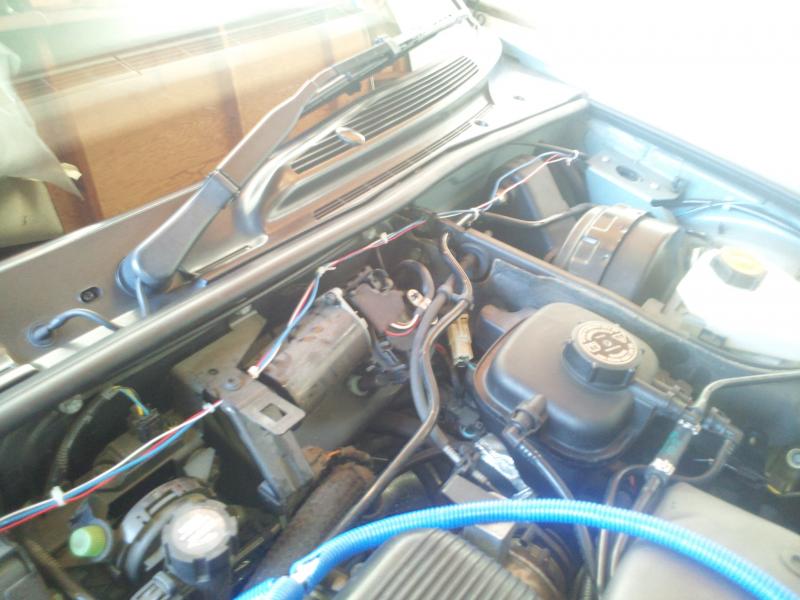

OK,
Got the Snow stage II wired how I like it.
See photos
I'm going to mount the control unit in the cold air box after my new intake arrives, for now it lives in the orange rag. Later I'll move the ground wire,and relay out of sight too.
I used a relay. I took the main (big) power from the large wire that feeds the fuse boxes (with inline 30A fuse) and took the control wire by splicing into the rear cigar lighter under the center console (with 5 amp inline fuse). The rear cigar lighter wires are very easily accessed. This did not require running a wire from the trunk. The wires ran through an existing opening in the firewall (where the hood release cables go through) as seen in the photos. This made for an easy installation. The wires are easily accessible under the dash also.
I mounted the two tiny green (for when the system is spraying) and red (low fluid warning) lights in the crack of the driver's side pillar. You wouldn't notice them until they come on. I like this as it maintains the "stock" look but gives me the info I need in real time.
There is a noticeable increase in higher rpm power, my butt dyno is not well calibrated, so I'll wait to see what this does on the dyno and track once I install the 4lb lower pulley which is next on the list.
Feel free to thank me, send me chocolates, or lots and lots of money for being the Guinea pig for this installation
Again, I would be happy to help anyone in the SF Bay Area with their installation, now having worked out a good installation method.
