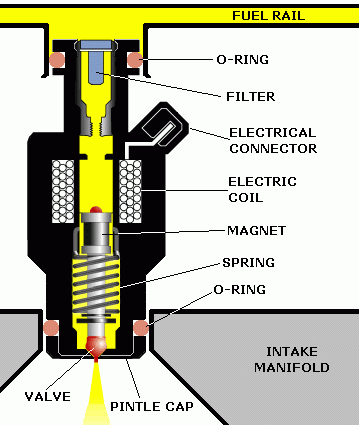

what iv been told, is to much fuel pressure can slow the needle movement when closing , and it can upset the injector characteristics, possibly cause a phenomena that locks the injector 1/2 open and 1/2 closed , engine instantly runs lean, and puff the magic dragon!
it can vary in % all over the map.
YES that could ruin the day, when you at full boost, and a lot of advance! and just when you are pulling ahead of that guy next to you, DARN.
A fuel injector is basically a solenoid valve that opens against the fuel pressure. They also have a spring to make sure the valves close completely when switched off. If you keep increasing the fuel pressure you can get to a point where the force of the spring + pressure is more than the coil can push against and the valve can't open far enough, or doesn't open at all.
The valves are usually calibrated to 3bar (40psi-ish) but Jaguar seems to run them at around a 60psi differential to manifold pressure.
Fuel pressure is one adjustment knob but you do need to be a little careful with it.
