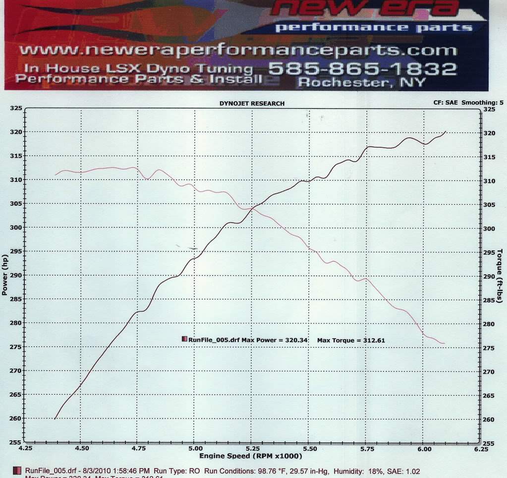

I though I would post my base dyno runs. I haven't dynoed the downpipes yet; the shop was busy. I am scheduled for the dyno on Sept. 1st and will post my results then.
Car is a 99 XJR 4.0 SC 370 hp 387 tq. factory numbers. I never dynoed it completely stock.
My only mods are a Macleod II X-pipe exhaust and my own intake.
It was nearly 100 deg. F that day. With 20% drive train losses, it comes out to 400-412 hp, not bad for just exhaust and intake and considering how hot it was.
The first two runs are in 3rd gear, because it kept downshifting, even though I unhooked the kickdown switch. 3rd run got botched. 4th and 5th runs were in 4th gear; they started these runs at a higher rpm to prevent downshifting.
1st and 2nd runs
4th run
5th run

I don't know what exact drivetrain loss is; could be 17%. Although that does seem low for an automatic. It's not only the transmission loss, but everything else as well: driveshaft couplings, differential, axles, etc. Like you said, only the wheel hp really matters.
As you should know, comparing numbers from different types of dynos is not accurate since they read differently. What is definitive are the numbers I ran at the 1/4 mile dragstrip: 12.996 @ 107.05 mph. This shows that I have even more power than the dyno showed. That was with the same mods as the base dyno; only exhaust and intake. Stock numbers are high 13's. The fastest stock time I have seen was 13.6something. Generally, one tenth of a second improvement equals 10 horsepower.

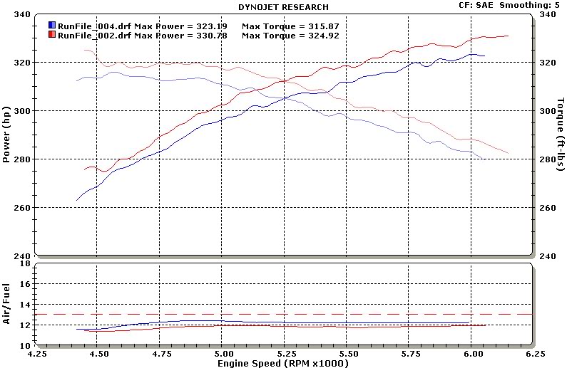

Well, I had the downpipes dynoed Wed. They did add some power.
The conditions were almost exactly the same. Temperatures were in the 90's again. Fuel from the same gas station and same amount, same tire pressures; everything was pretty much identical.
We did three pulls; 1st run downshifted to 3rd gear again, so we have two good pulls in 4th gear.
Here are the graphs. Last two runs of round two compared to last two runs of the base runs.
Round 2 run 2 compared to base run 4
Run 2: 92.06 deg. F. 29.63 in-Hg, Humidity: 25% SAE 1.02
Round 2 run 3 compared to base run 5
Run 3: 93.53 deg. F, 29.64 in-Hg, Humidity: 23% SAE 1.02

Thanks for sharing your experience, and it does seem to make a difference (although small). Not sure why a/f ratio is .25 to .5 richer, it might have given a slight advantage, still not bad. Where these the pipes without catalyst or the sports catalysts?

Yeah, the gains are less than I was expecting; only because other vendors that sell high flow cats for these cars claim 20-25 hp. Since these down pipes don't have cats at all, I was expecting that much at least. I'm still pleased with the downpipes, they're still a decent bang for the buck, very well made, well fitting, and much lighter.
The AFR is richer probably because there's no cats to lean out the mixture reading. I would think the richer AFR would be a disadvantage, since leaner makes more power?
I guess companies that claim 22-25 hp gain (Paramount Performance), for sport cats are full of it, according to only my data.
Next is get some runs at the drag strip to see how they perform when the weather is similar to the last time I went.

It fits with my experiences also that there isn't that much to be gained and I have yet to see any creditable dyno slips from the manufacturers that prove what they claim. Knowing how easy they pump up the expected values has made me very skeptical, and it is so easy for them to say afterwards that hp would depend on the condition of the car if you would complain.
The gains (or lower than expected gains) are also hard to prove, not many people will go thru the trouble to get comparable dyno runs, so a free run for the sellers... Last but not least, the extra noises will give you the sensation that you have more power, and that is on its own already worth something, just not so much for those who do like more actual power.
Still about 10 hp isn't that bad I would say, it's another 10 extra for not much.
