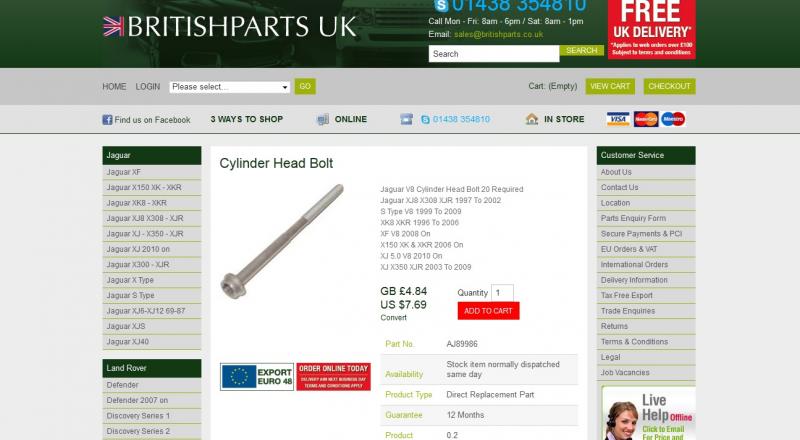

The XJR takes 20 cylinder head bolts but sit down before you read the cost.
I've found the details on British Parts UK website:
They have a US based distribution centre in Houston at:
Contact Us :: British Parts International
Worth entering the part number in your search engine to check for other suppliers.
Attachment 26252
Contact*Us*::*British*Parts*International
Thank you for the link,
Those are stock replacement bolts, I'll use those if I can't find studs, but I'm hoping I can upgrade to studs. I'll call ARP monday and see what they have to say.
