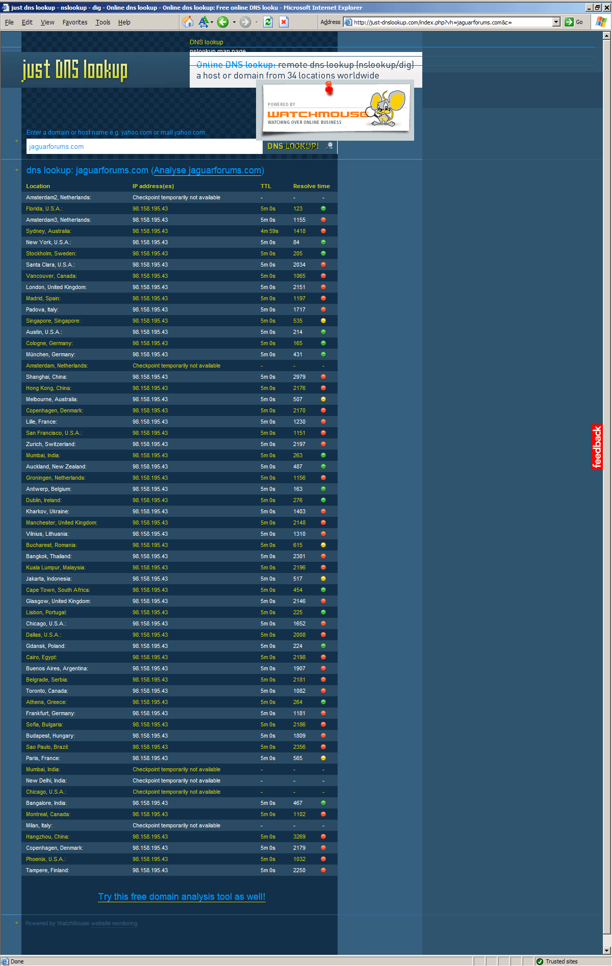

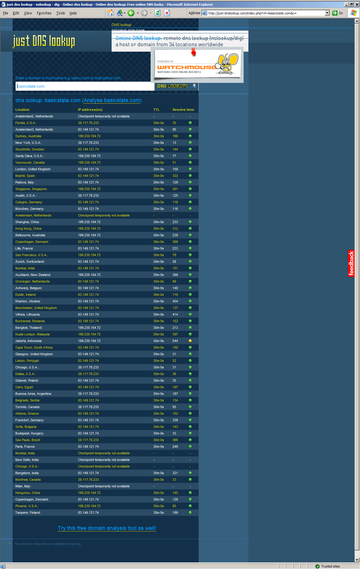

Lightbulb dns is part of the problem
Not all of the problems are external resources. One of the contributors is that the DNS for jaguarforums.com is not up to par.
The links below are to screenshots of tests run about 15 minutes ago. The tests were done at just-dnslookup.com who have 50+ monitoring sites sprinkled around the world. Their results have always been a very accurate overview of DNS performance.
Warning, they are not heavy but pretty big in terms of screen size.
jaguarforums.com
basicstate.com
exactstate.com
The DNS servers for JF are run by IB themselves, while the DNS servers for the other two are outsourced to managed DNS services provider edgedirector.com

BTW, the TTL value of 300 seconds, or 5 minutes is a disadvantage as it means anyone on the site for longer than 5 minutes is going to have to do a fresh DNS lookup every 5 minutes during their viewing session.
