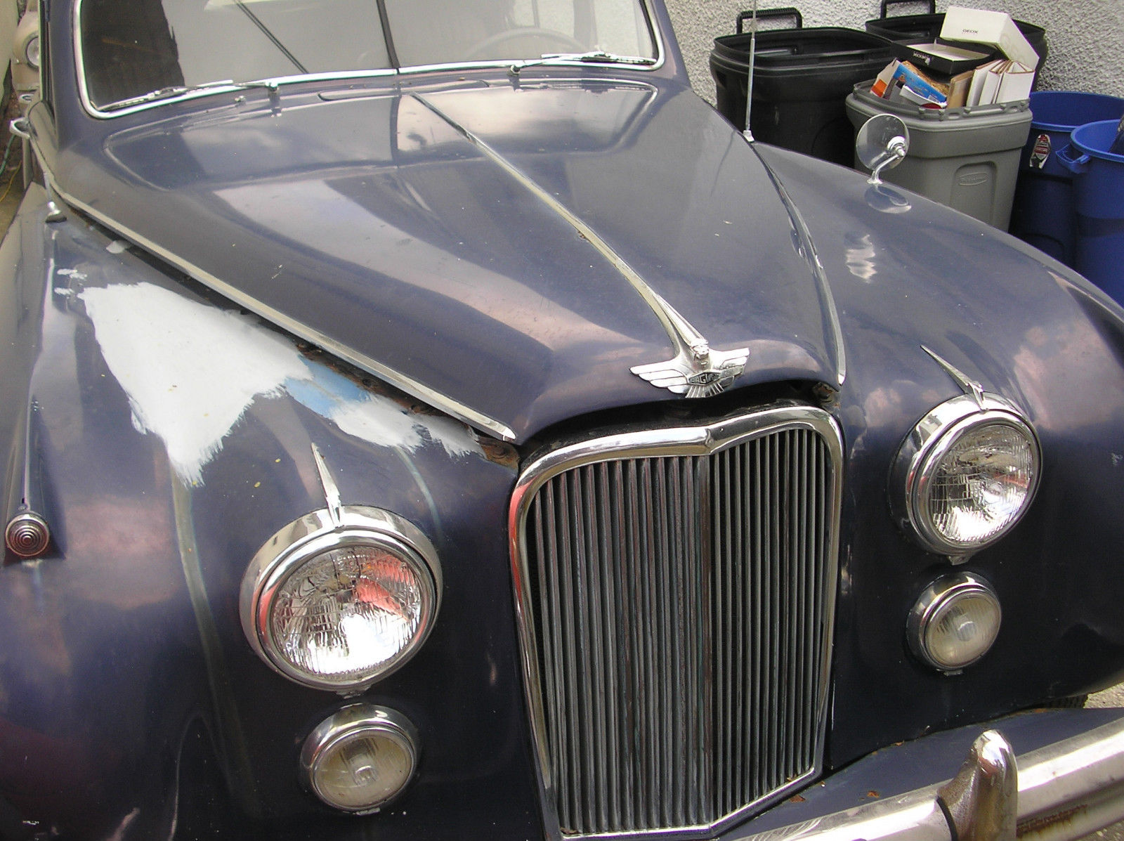

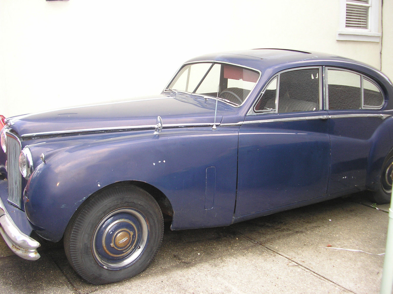

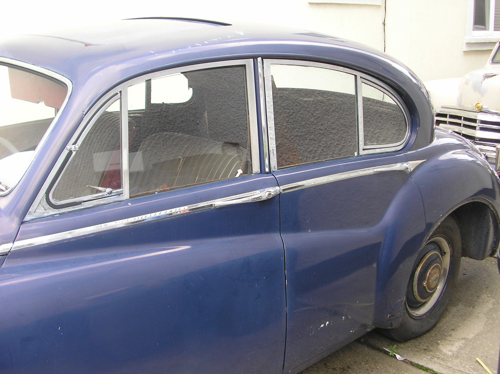

So I looked with rose-tinted eyes at the 12 pictures of the Mk VII. Body wise it looked OK. The interior was awful, but all there, and I thought I could redo that. Engine was supposedly running. Car was very complete. "some restoration needed" according to the seller.

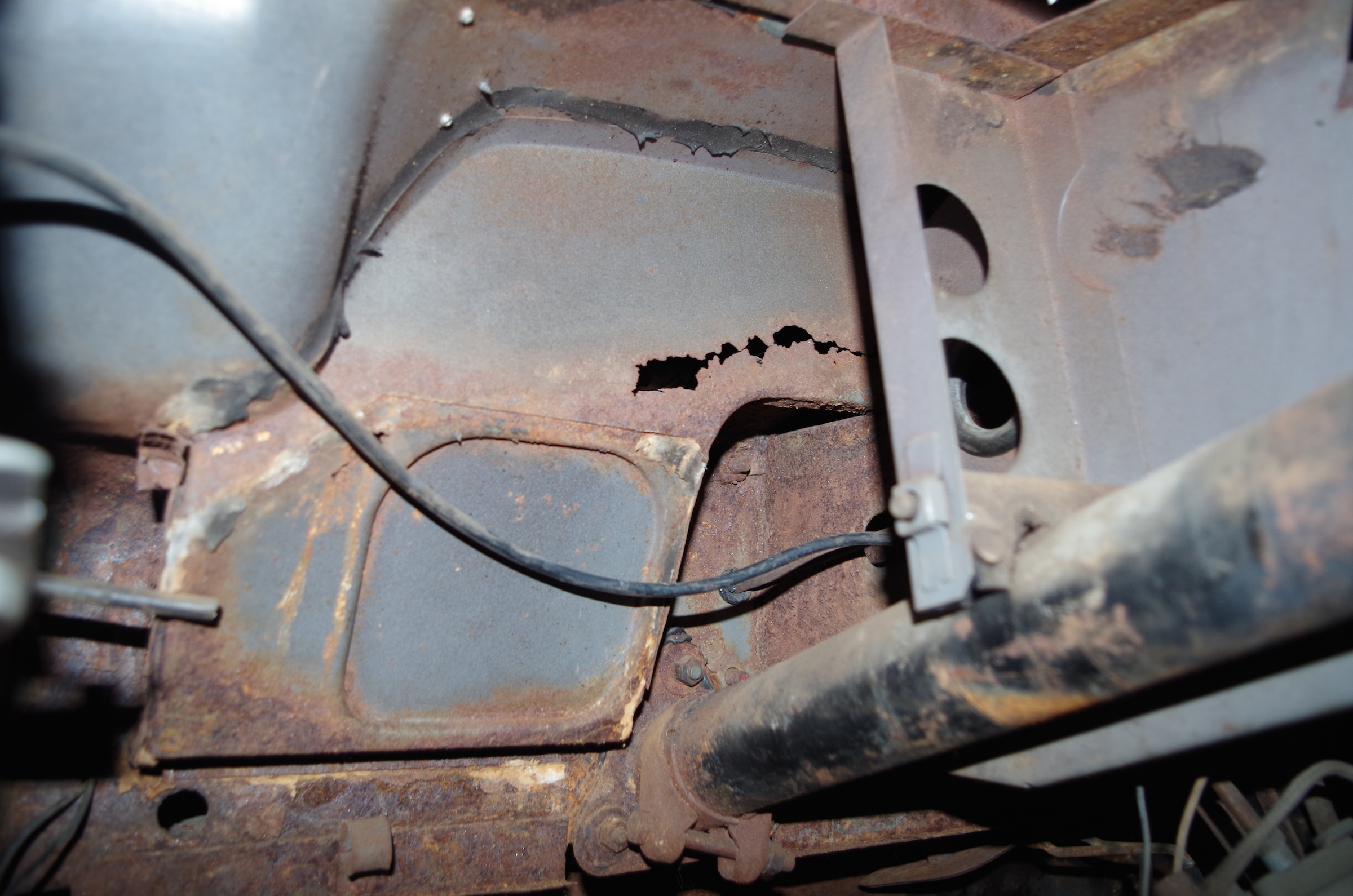

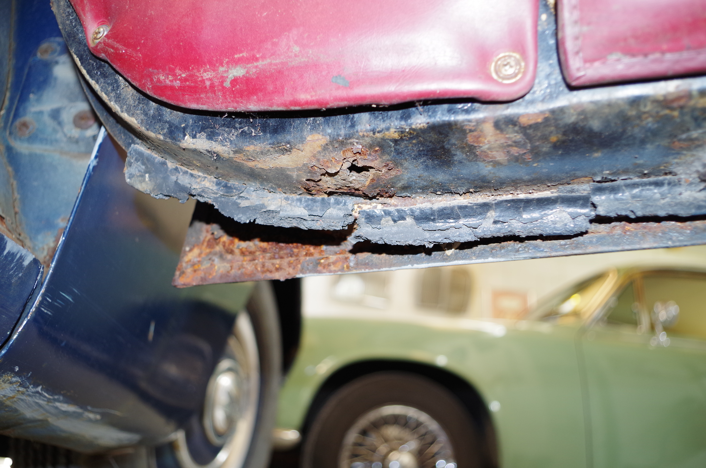

Yes rust. I had hoped to have a car with little rust. I do not mind repairing / welding if needed but it is not work I like most. When looking at the car just after receiving I saw that the floors in front of the seats are very bad. Big holes! Also two door bottoms need rust repairs, and what is that behing the dashboard?

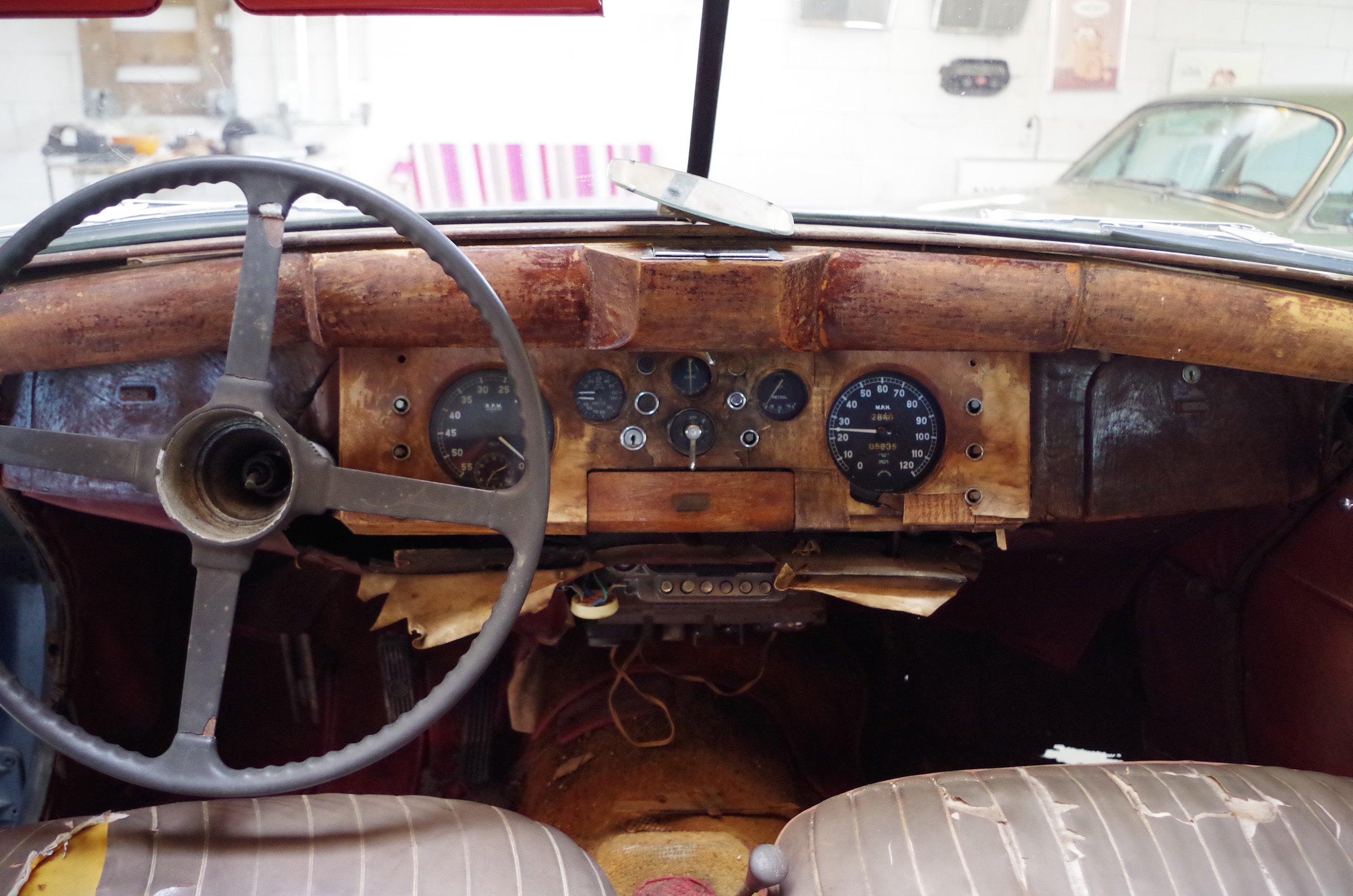

So the dashboard was removed - it is very bad. The wood has delaminated, especially the part which goes over the instruments. I am not sure the LH and RH parts are good enough to survive as well. Luckily all other wood is present - around the doors and around the sliding roof. All wood need veneering and varnish.

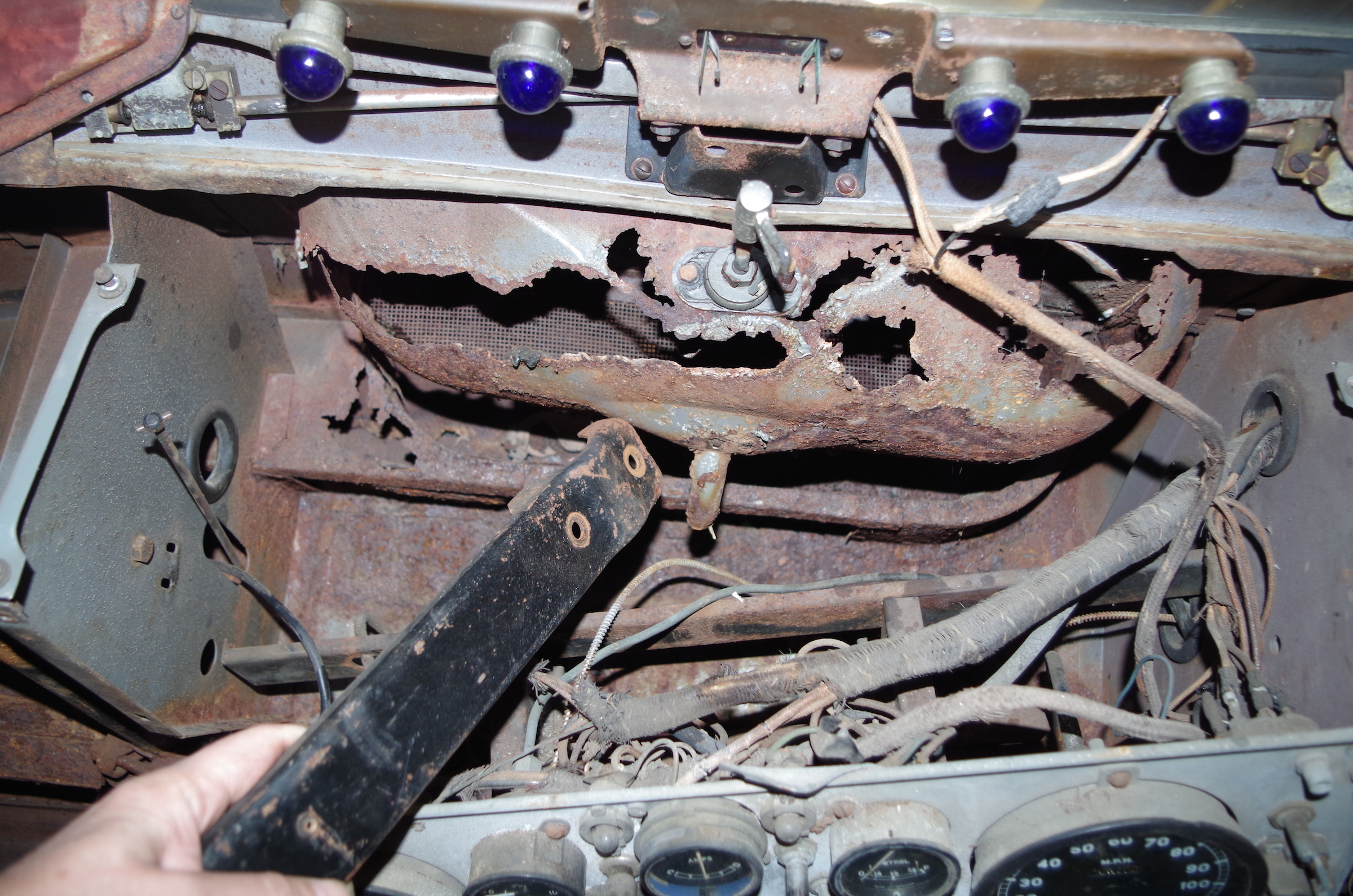

Now I had a good look at the rust behind the dash. The compartment below the scuttle flap is almost completely rusted away. I can only think this must have been full of water for a long period of time. It probably has leaked onto the floors which are very bad as well. The damp condition worked its way into the wood and also into the bulkhead itself. This contains rust holes.

Pictures: first three are from the seller in New York.

I too had the scuttle on the inside of the car under the wood dash all rusted. I didnt think twice i cut it out.
As the floor slopes towards the doors, you may find like i that the floor panels along the doors are rusted too. I sand blasted the entire car including chassis which i itself was also rusty from sitting for 30 years. Now its shiny like stainless steel.
Im to cut and weld some floor sections , boot floor, front passenger and driver floor areas and reweld some panels in. Did i mention the sills, i didnt llke them so i cut them out too, another weld job.

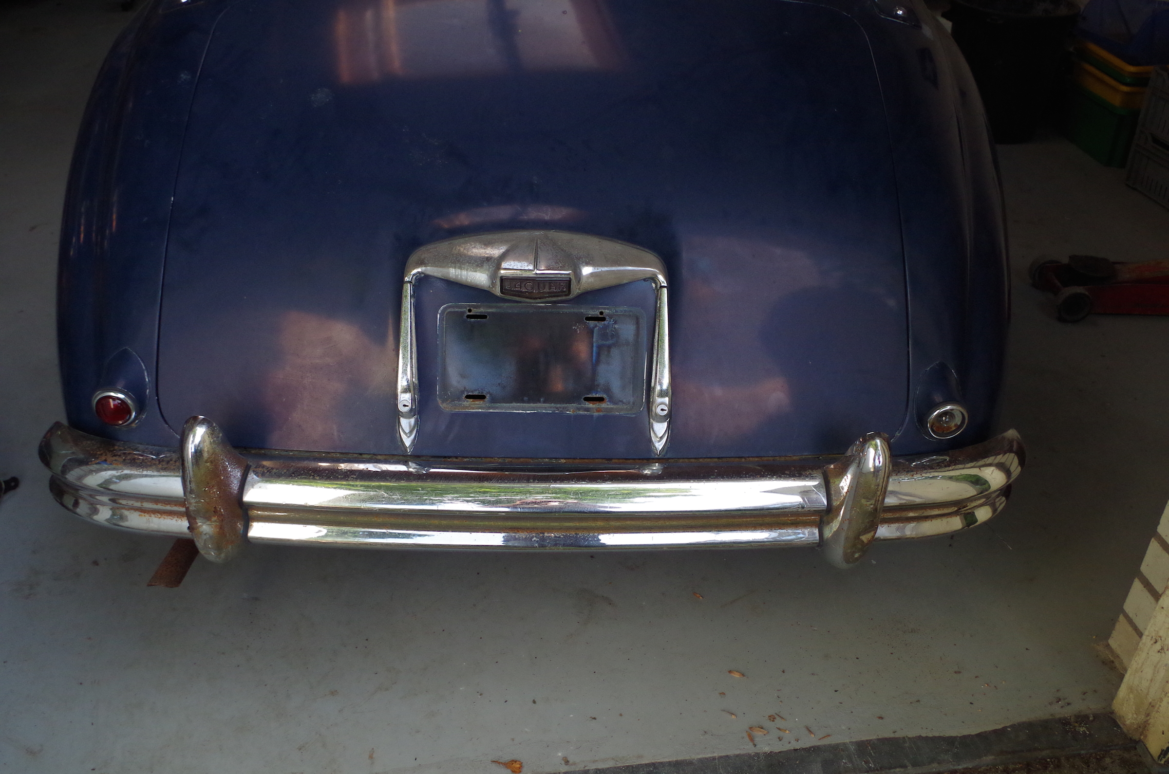

The bumpers were solid and straight but did have fairly substantial rust so they needed rechroming. Or??? I contacted Harrington in Asia who specializes in stainless steel bumpers. They did have bumpers for the Mk VIIa / VIII and IX but not for the early type Mk VII which has a different bumper at the rear. So I made a deal with Harrington. Sent them my originals which they keep as reference, in turn I got a duplicate set in SS for half the normal price. Happy with that!
