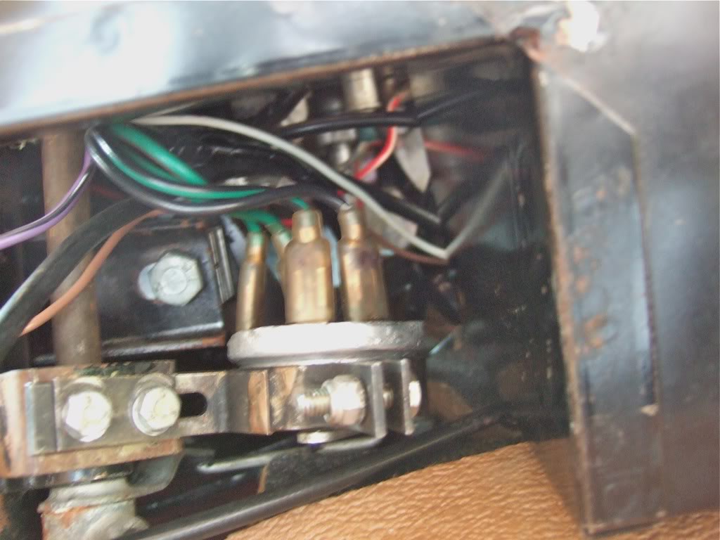

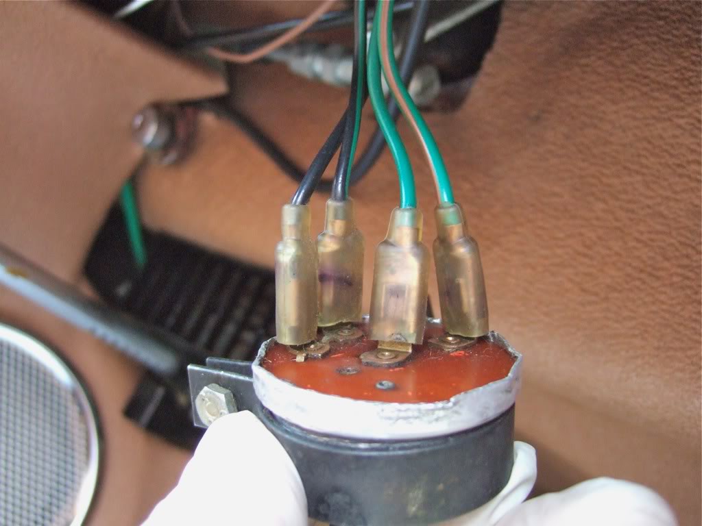

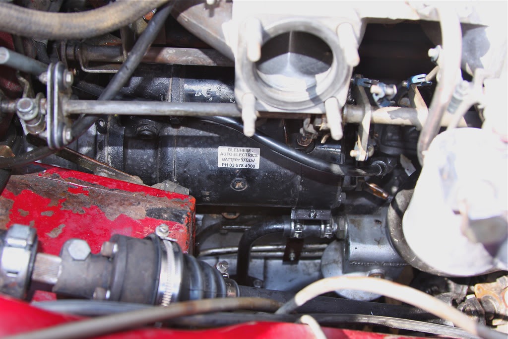

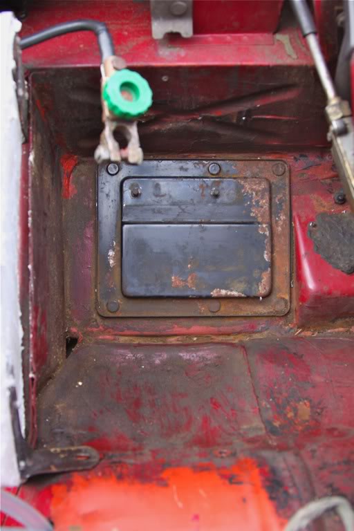

The first week-end I was going to start the car and tune the carbs was not a good one the car wouldnt start with a new battery on after stripping one off the carbs and checking the starter motor it still didnt start with it all back together we did get it started but by connecting a wire from the starter motor to the battery direct. When started it did throw out some black smoke
Just at that moment a neighbour arrived home to advise me they had had there windows cleaned last week
Anyway some pics:

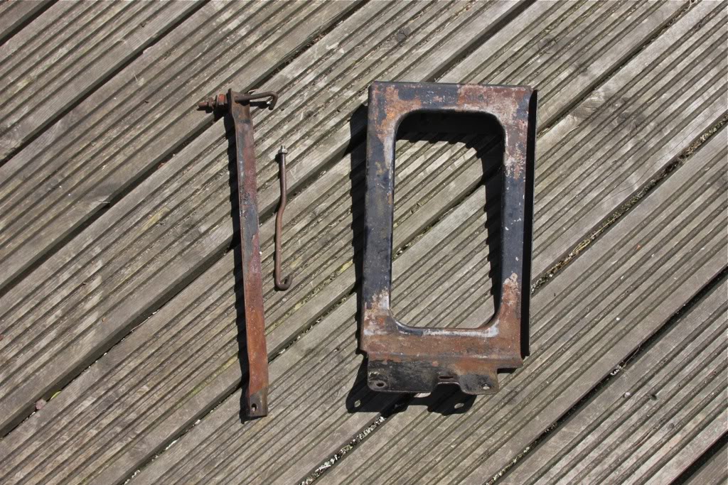

Even though we got the going after a lot of wasted time we found out the reason it wouldn't start was the inhibitor switch wire to the relay had been knocked off when I had put the dashboard wing back on.
I found there was little info on the tinternet re this switch so I hope these images help someone. For more info go to my project thread at:
The Jaguar Mk10 & 420G Owners Symposium

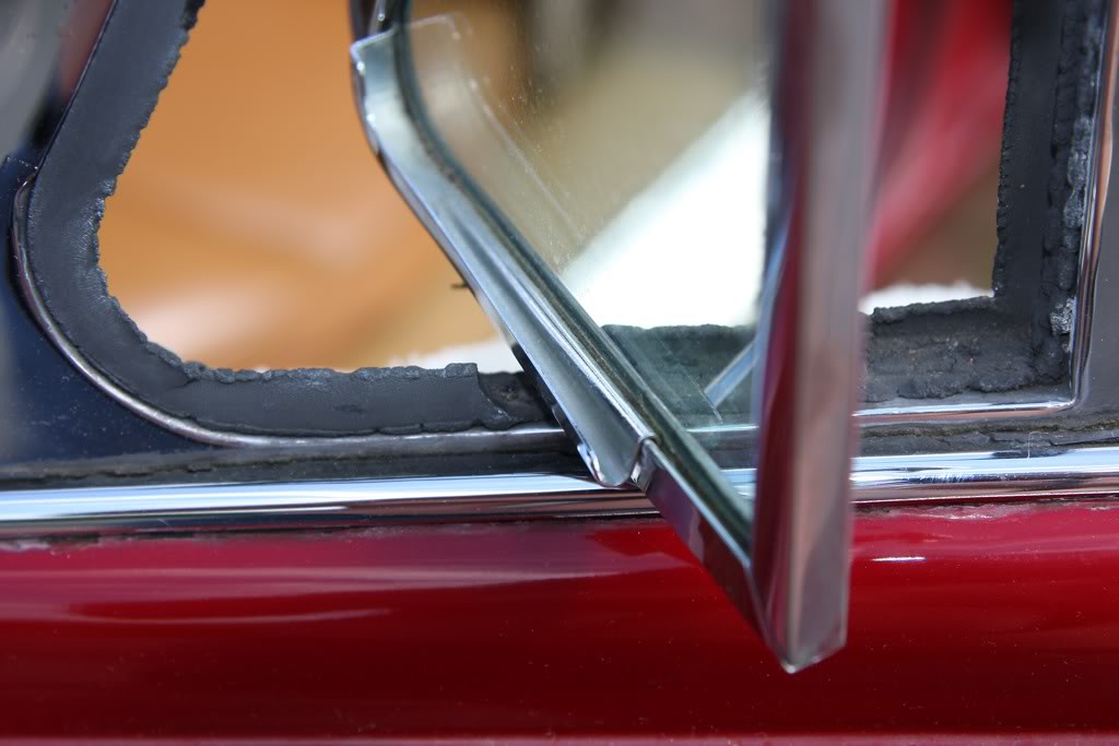

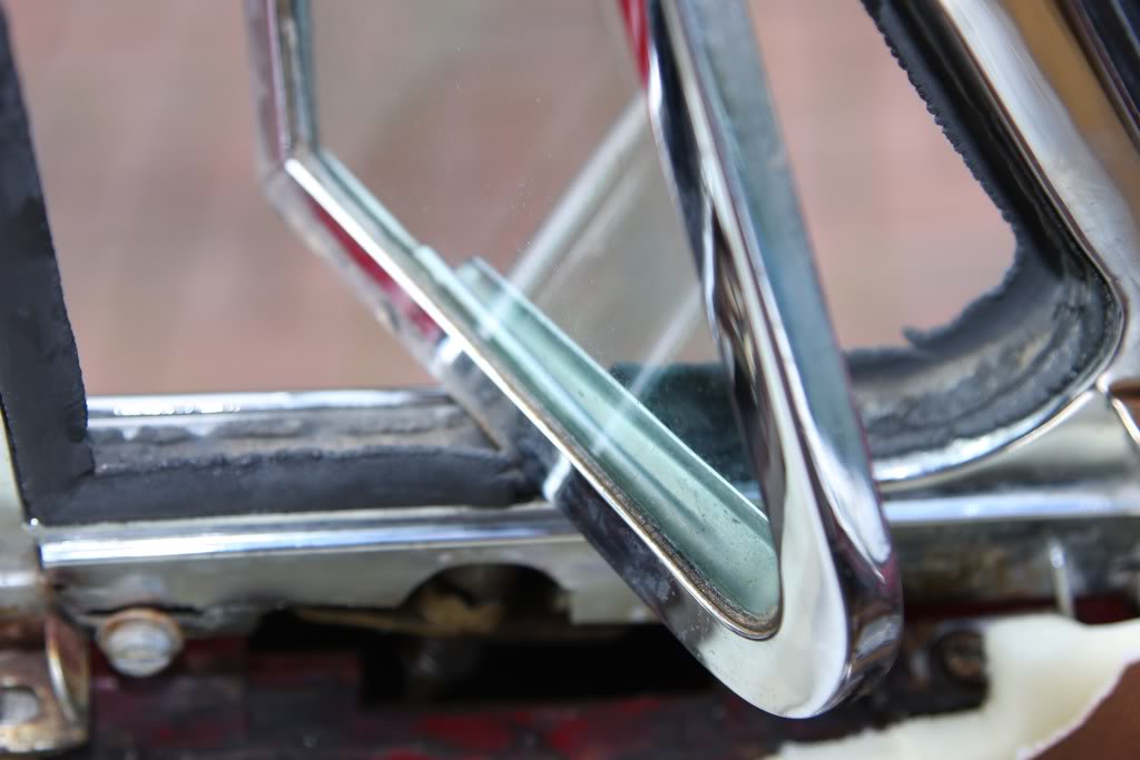

I have also been trying to source some seals
