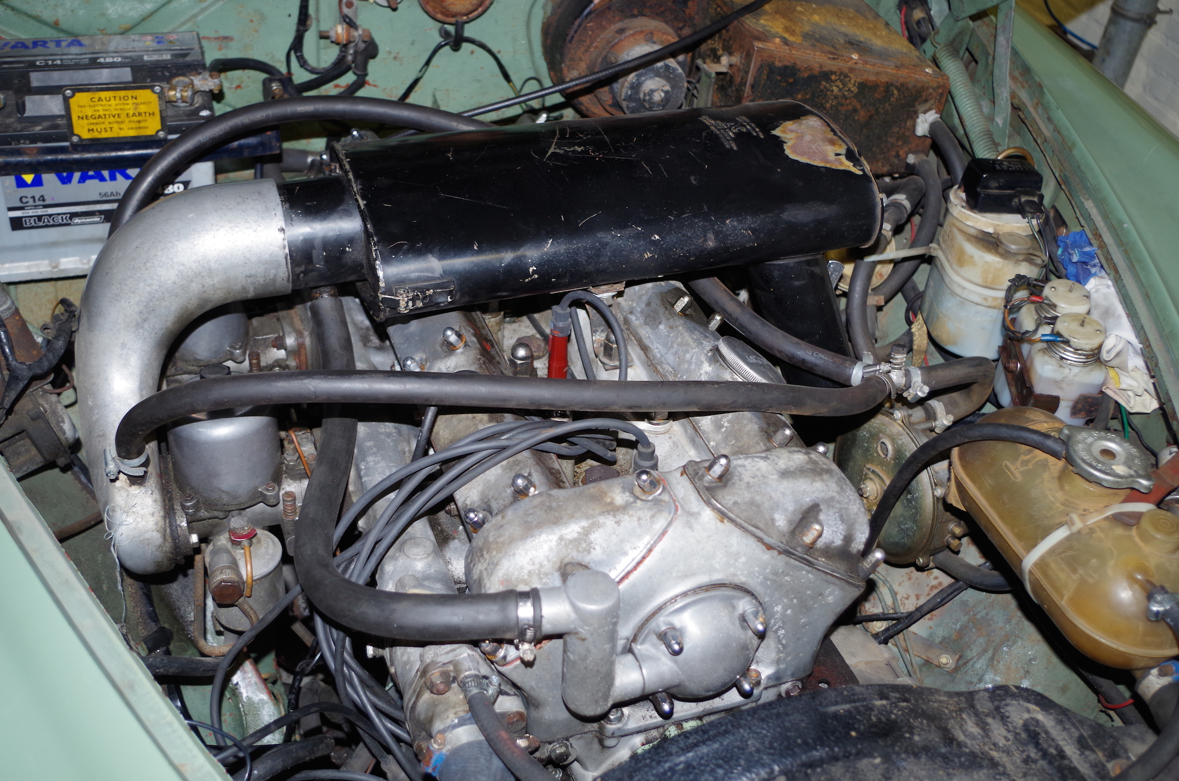

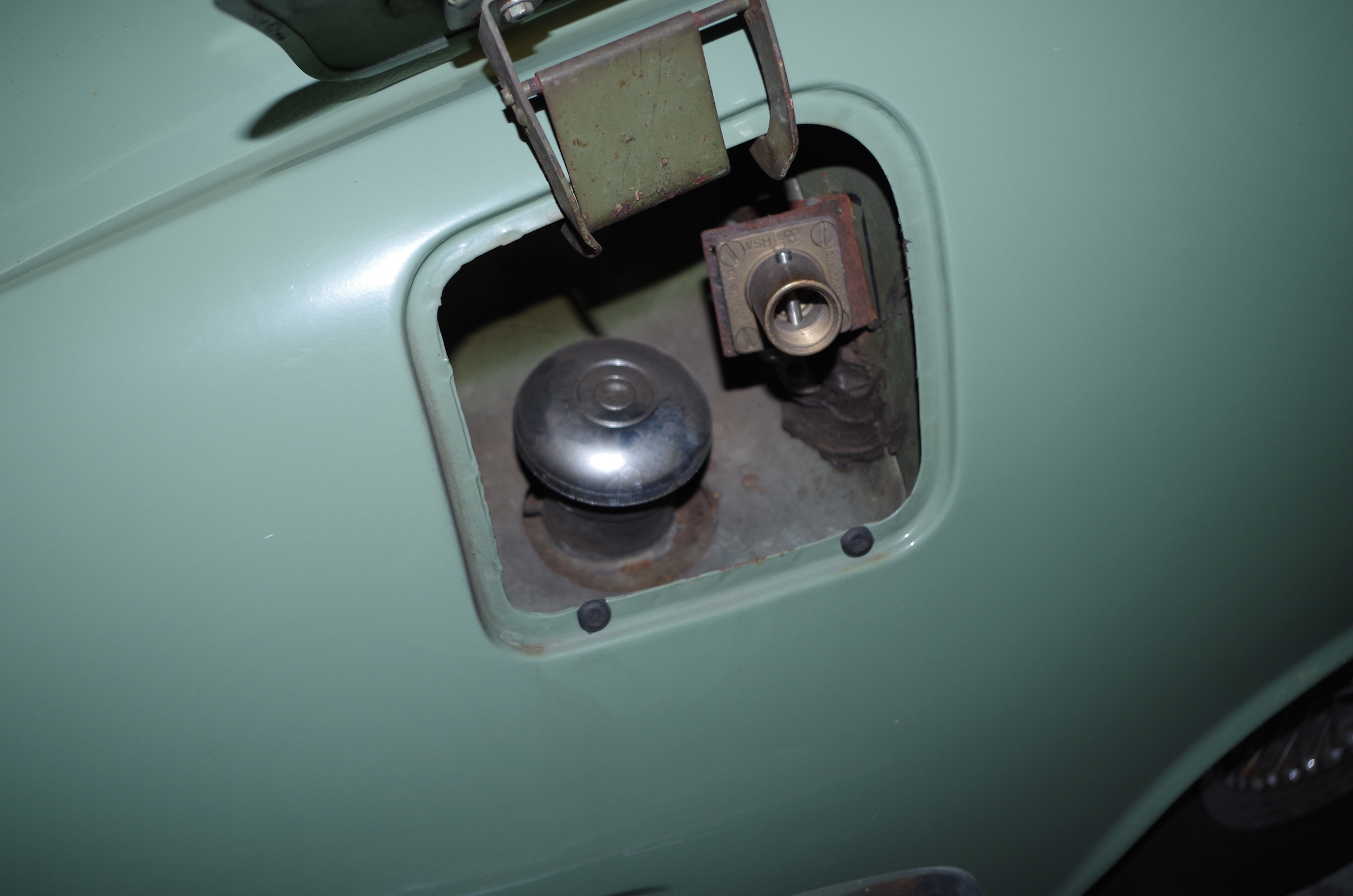

For what it is worth, I have been running my 420 on LPG for about 7 years now.
The head needed hardened valve seats, and I think I retarded the ignition a bit. The car runs a little smoother on LPG, although the power is a bit down compared to running on petrol. For me that is not a big issue as I feel the 420 has enough power as is.
I have put the filler plug in the RH fuel flap, so not visible to the outside world.

When I bought my 420 7 or 8 years ago, it supposedly had an engine rebuild years before and not run much after. A few weeks after buying it, and installing LPG, due to a faulty automatic fan (not sure of the english name) the fan did not run and I had the engine overheated. After that it used a little water so I pulled the head. The head gasket was at fault.
Because the head was already off this was a good time to put in hardened valve seats.
By the way - the XK engine had much less wear on the seats than the Triumph head. Maybe the XK valve seat material is of a harder specification? Whatever, I would have done it anyhow if only for peace of mind and for less valve adjustment. Which of course on a OHC head with shims is a fair bit harder to do. I could adjust the Triumph valves within one hour, try that on a XK engine!
Attached Thumbnails LPG conversion XK engine-imgp1119.jpg   LPG conversion XK engine-imgp1122.jpg
