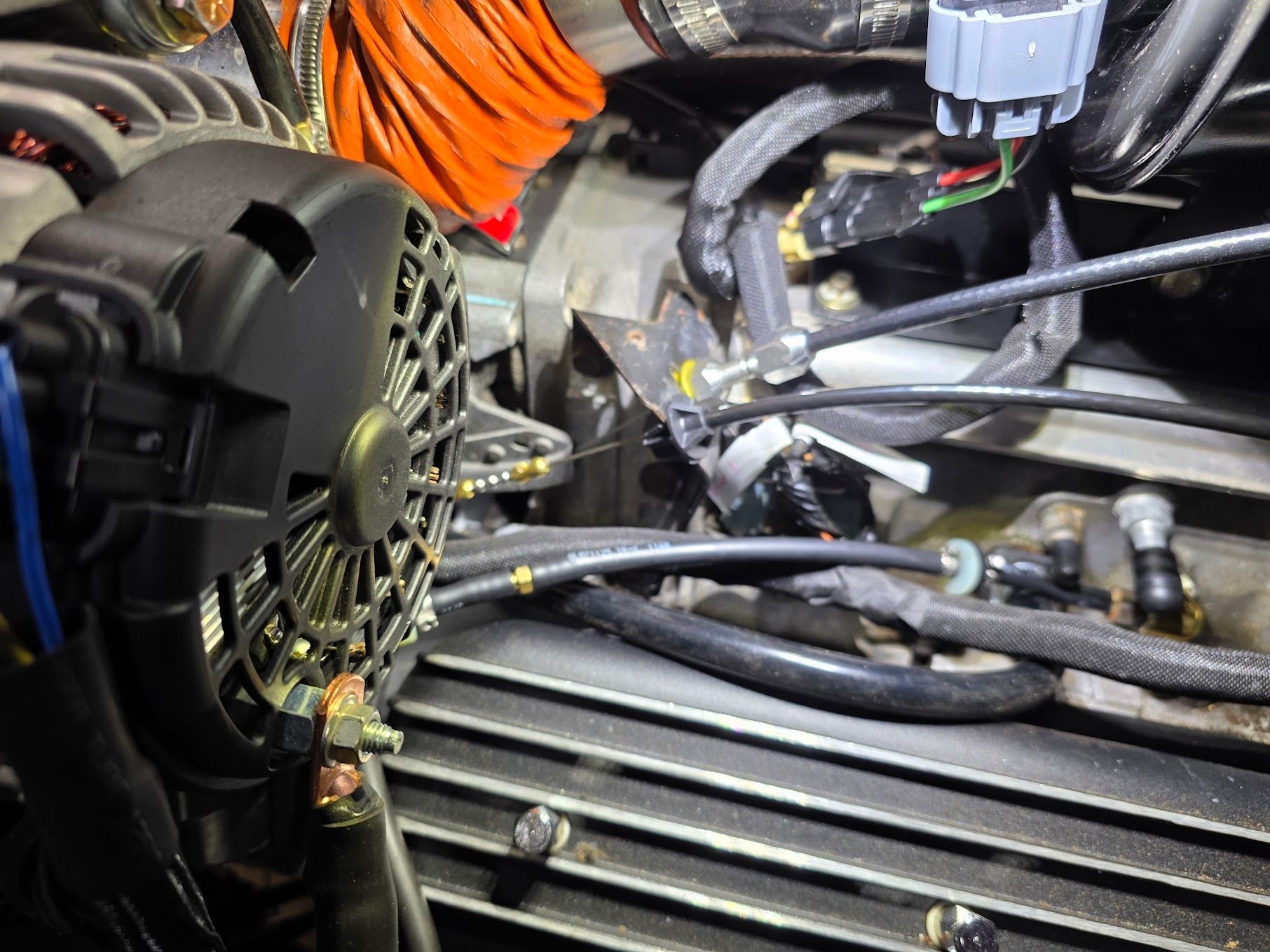

The first step was hooking up the pull cable to the throttle. Luckily the LT1 has a provision for cruise control on the throttle which makes this step easy.

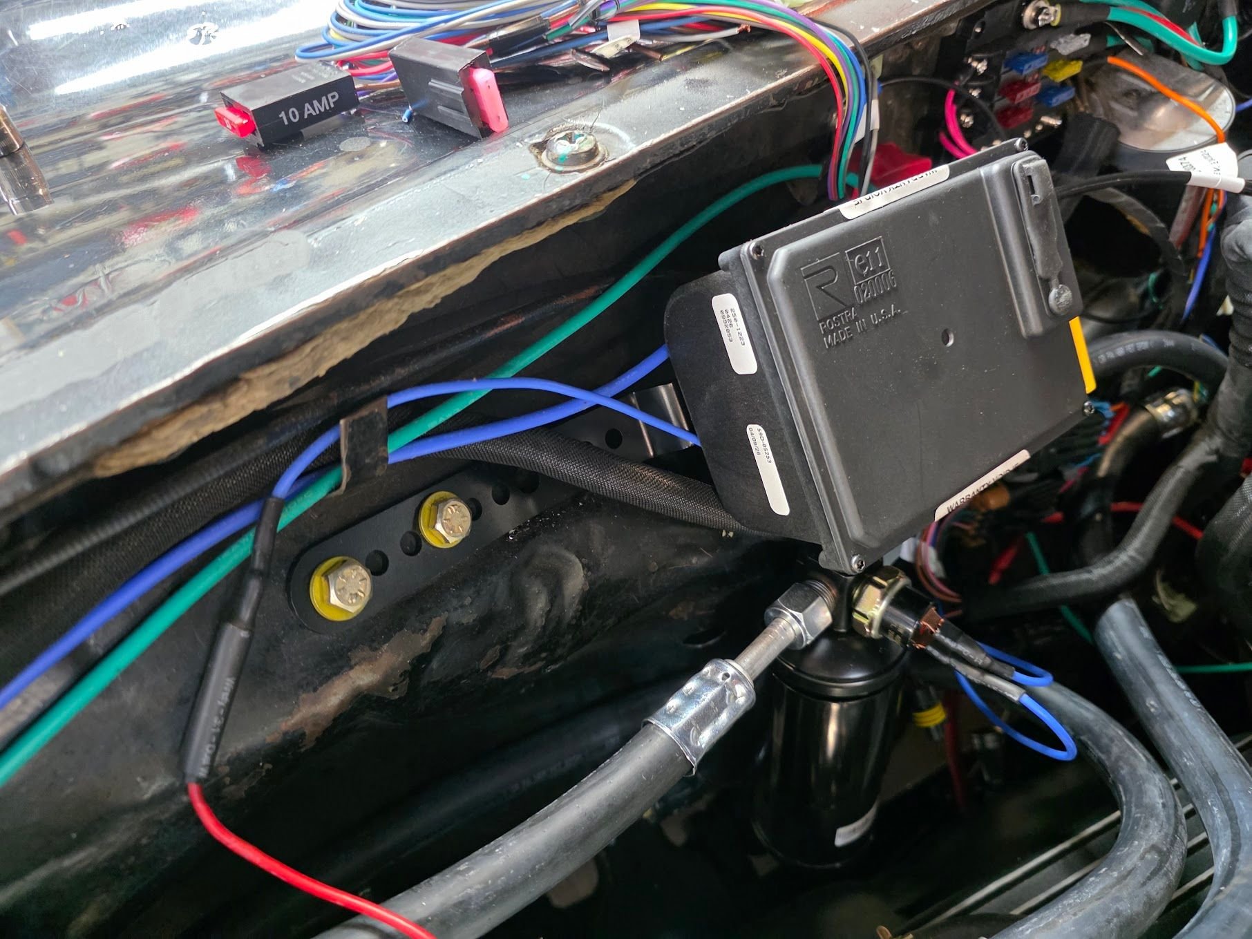

Next up was mounting the cruise control unit on the right side inner fender.
After that I covered the wires with black fabric loom and ran them behind the firewall to the inside of the car. From there it was hooking up +12 volts and ground.

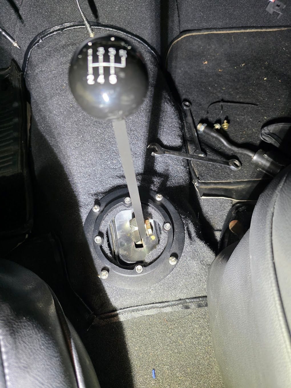

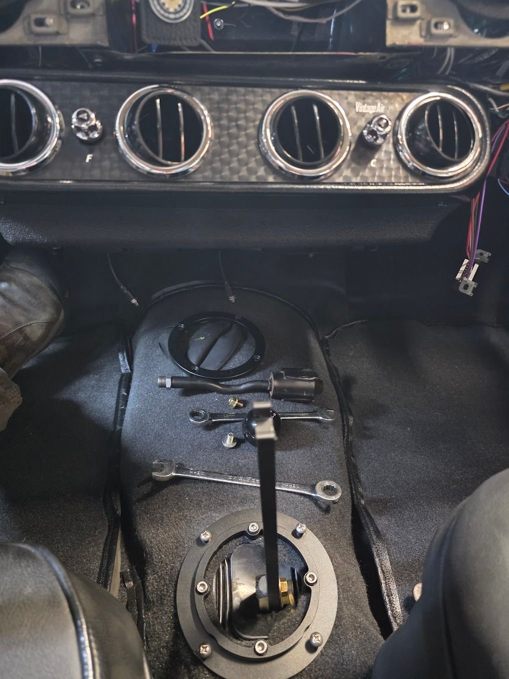

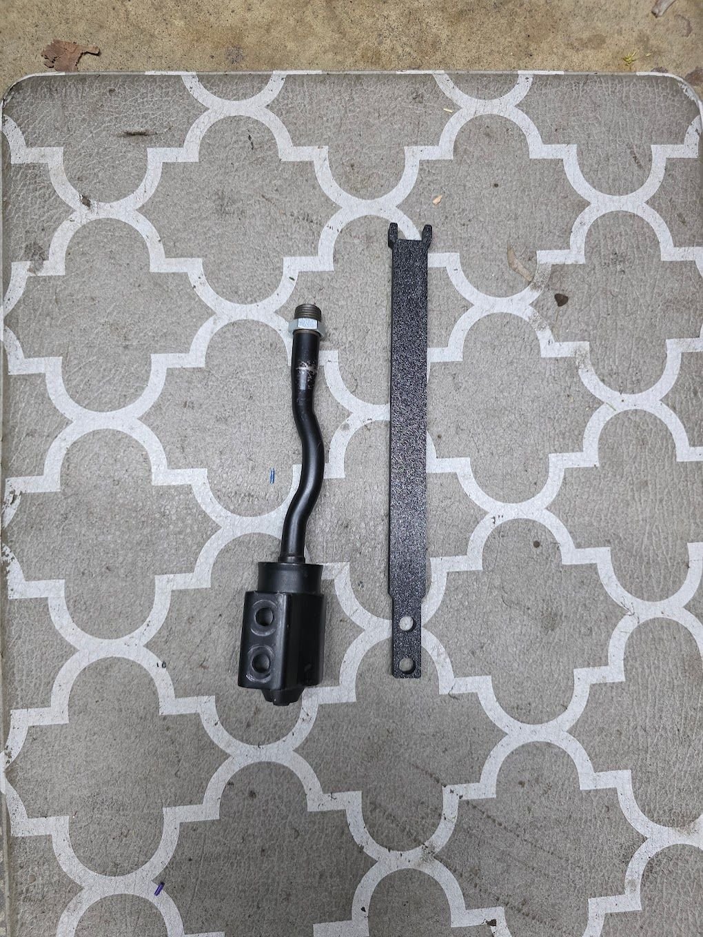

Yesterday when I was driving I decided the shift lever was about 3" too short. I designed a prototype in AutoDesk and 3d printed it so I could check for clearance, specifically around the air conditioner.
The stock T56 lever is on the left, the prototype is on the right.
This is the right length but I want to redesign the top part to have some more meat to it.

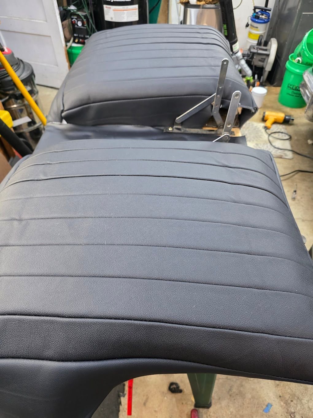

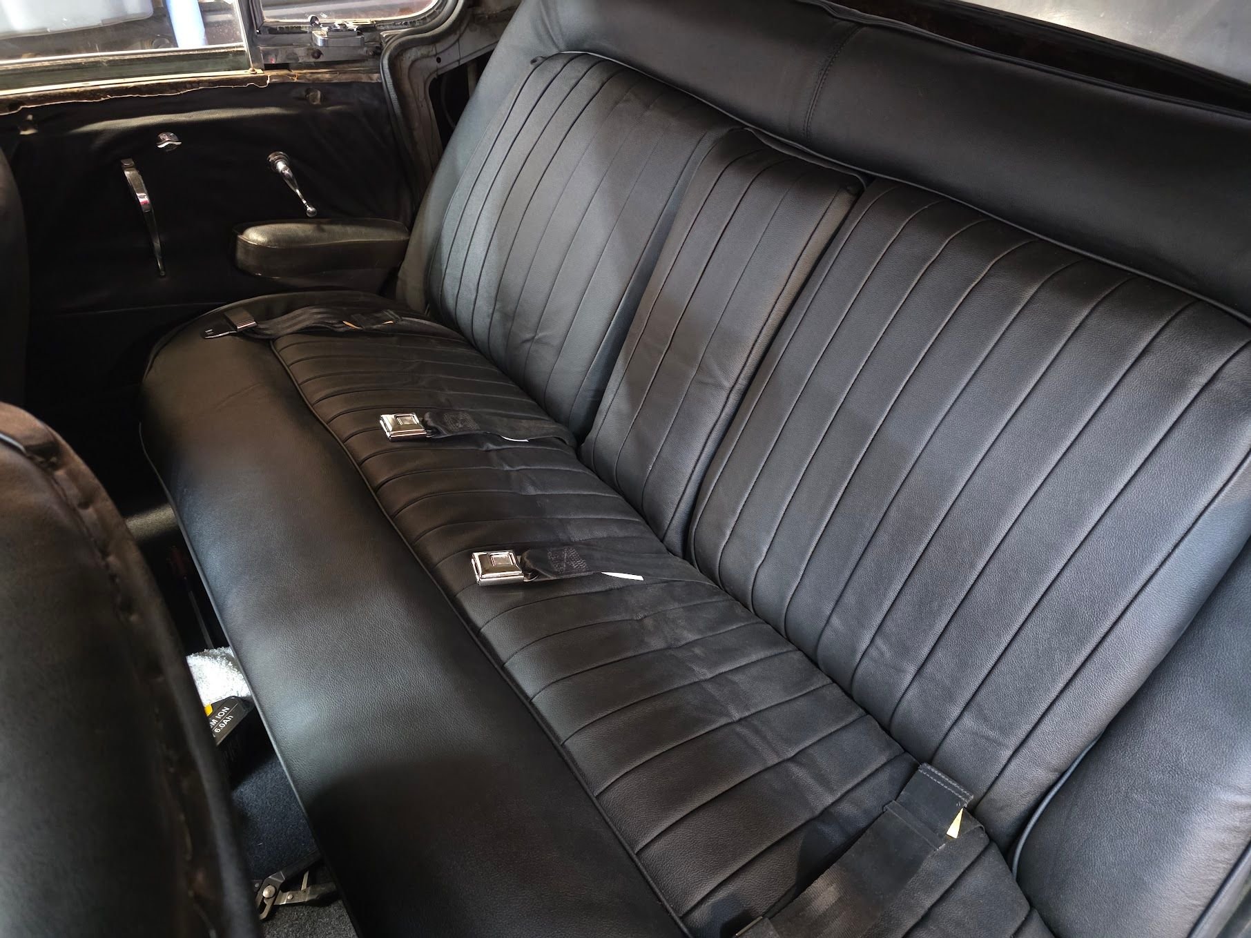

After that it was time to remember how the rear seat back fits together and guess which pieces go where. I'll have to work through this tomorrow.

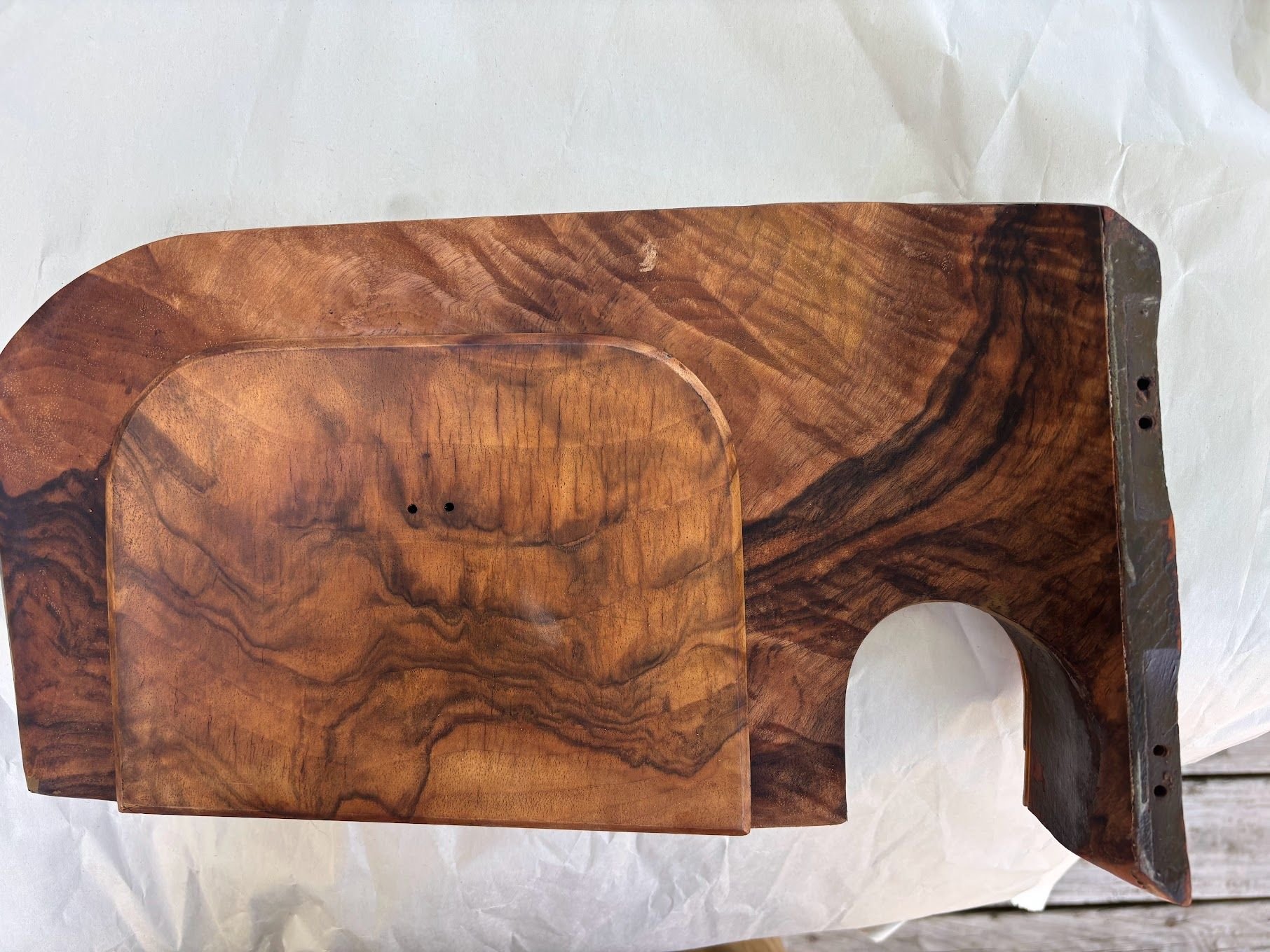

Finally, Dad sent me a picture of his work on the left side glove box. The upside down U shaped cutout is where the steering column goes and the round circle above it is where the automatic transmission shift lever passed through. With a manual transmission I no longer needed that hole, so Dad made a wooden plug to cover the hole.
After that, he re-veneered the piece to hide the plug and it turned out really good.

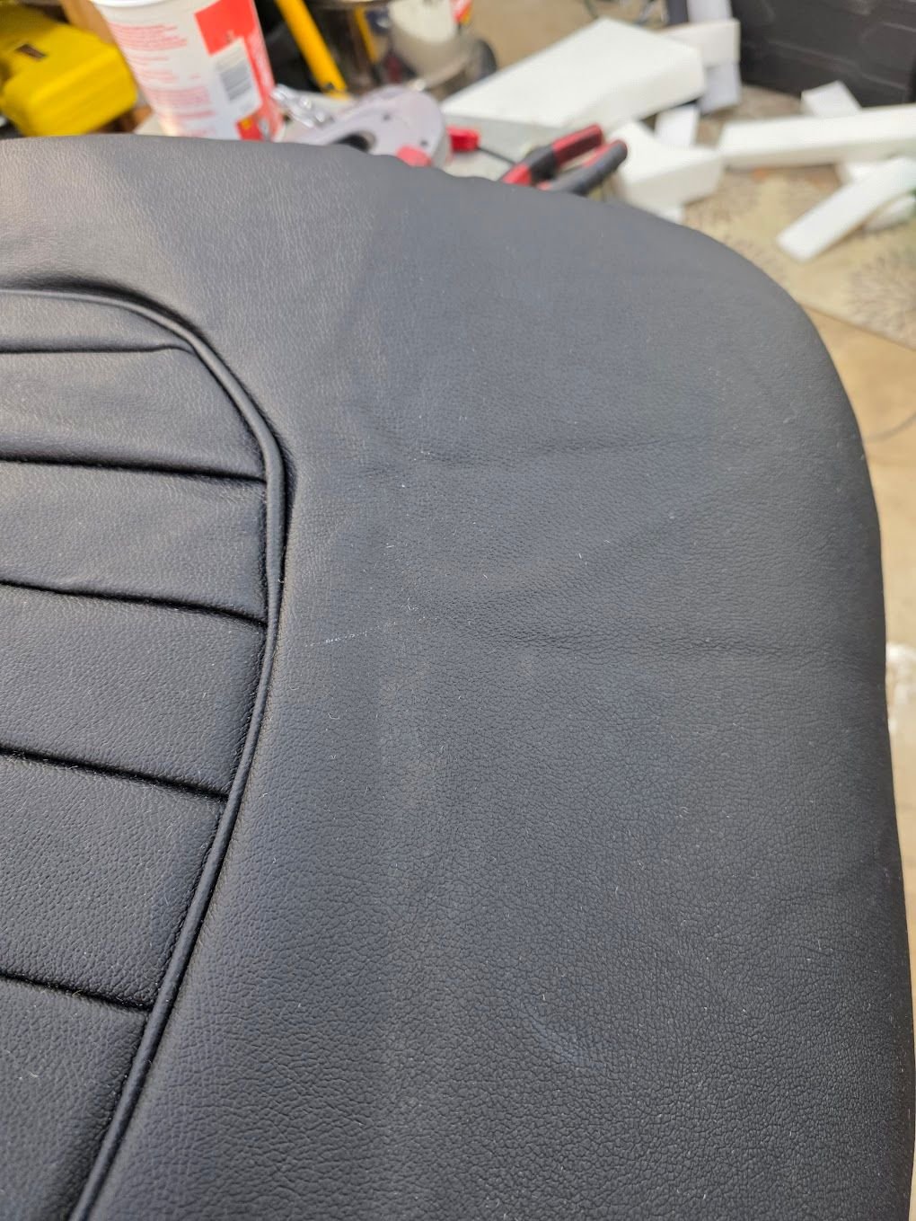

Your seat wrinkles might go away if you let the car sit in the sun for a few days. Especially a black interior in a black car.
Might be the right time for a Death Valley road trip

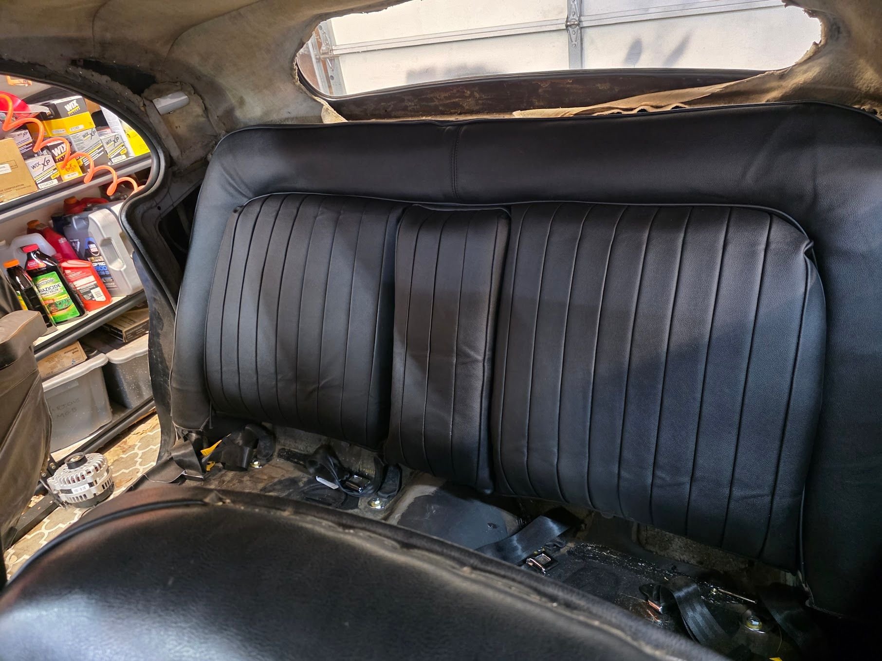

Today I realized that my Route 66 trip is in exactly 2 months and my 2,000 mile road trip is in just over 5 months, so I decided it was time to get busy.

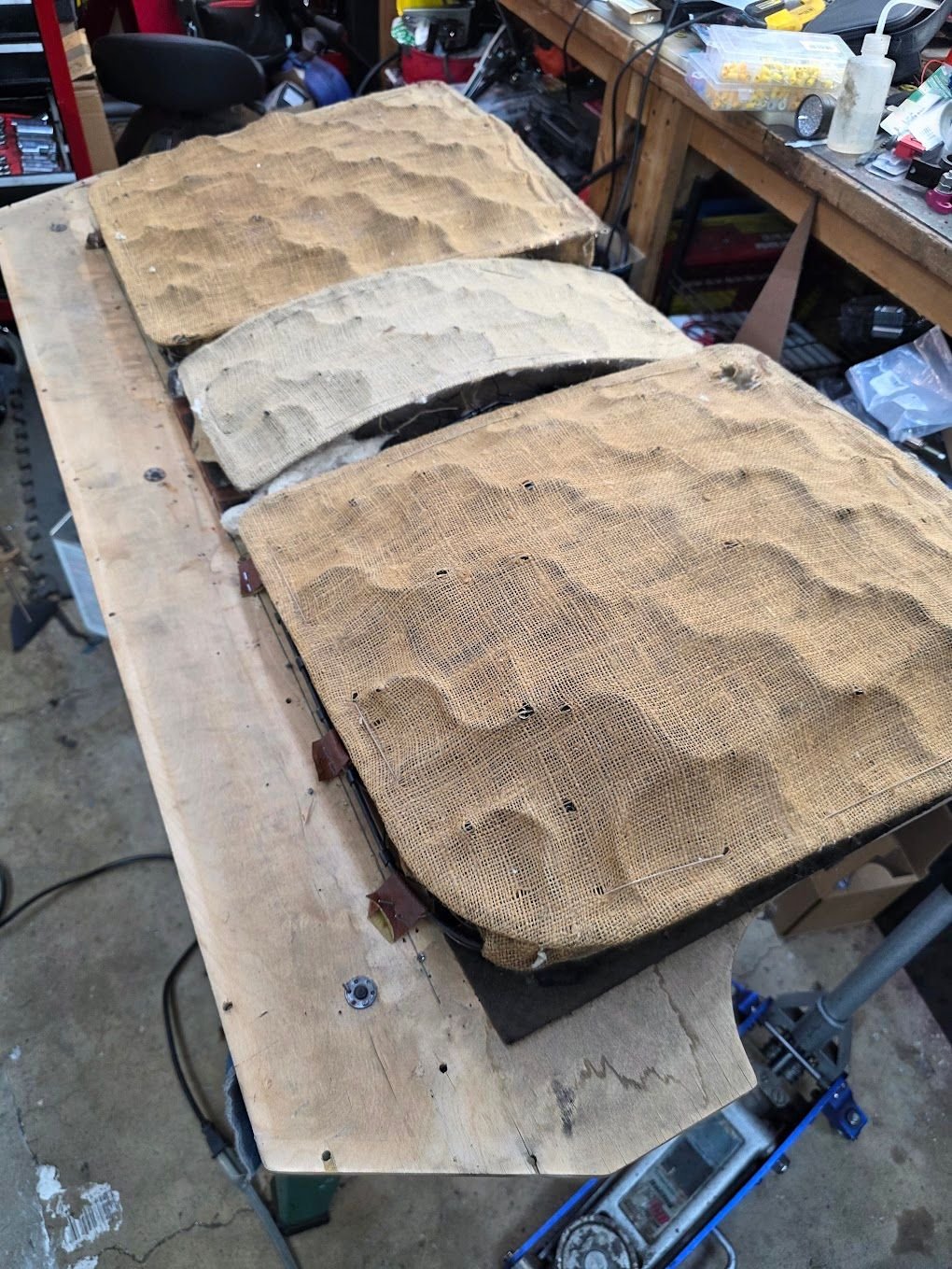

First up was covering the rear seat back spring pads in 2 layers of burlap.
Then I used my electric knife to cut and begin shaping the foam.

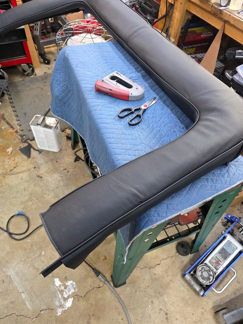

With the left and right side of the seat back done, it was time to remember how the arm rest was put together.
I need to spend some time with the heat gun to smooth out some wrinkles but the rear seat is coming together.

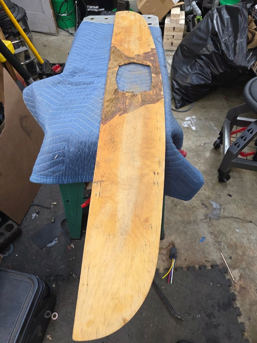

I had forgotten that the rear parcel shelf needs some attention. I use this one as a template to trace the shape onto some fiber board; I will cut that out tomorrow.

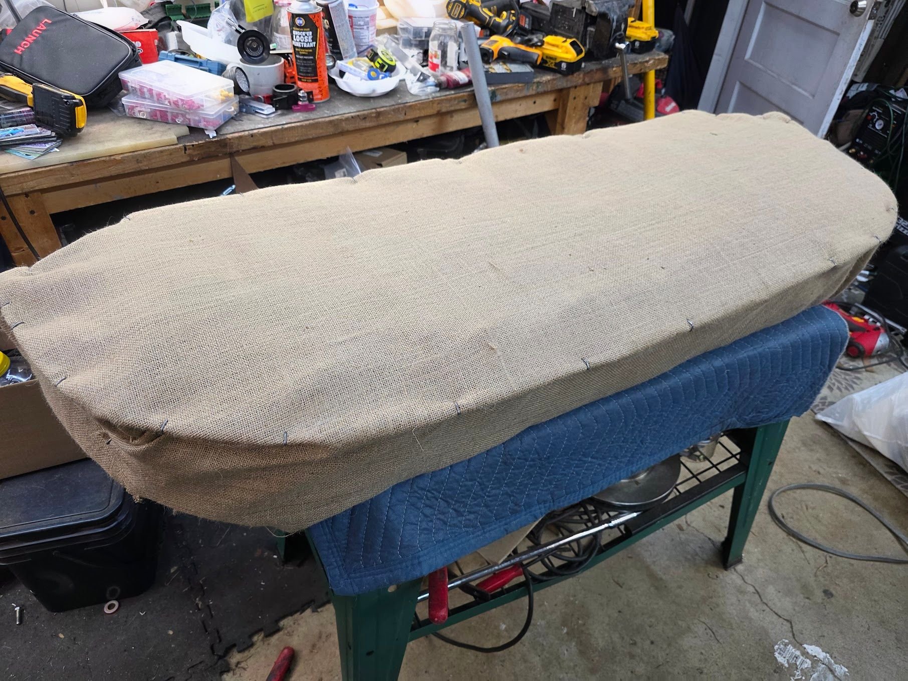

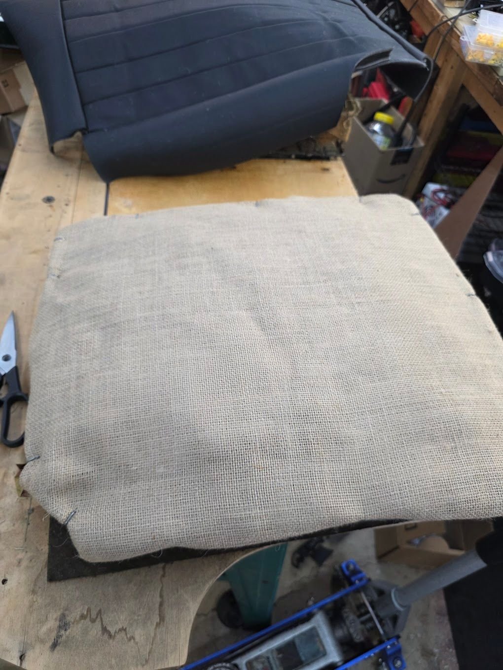

Then it was time to put 2 layers of burlap on the seat bottom. I need to wait a few days to start covering this as I am waiting for more seat foam to arrive.

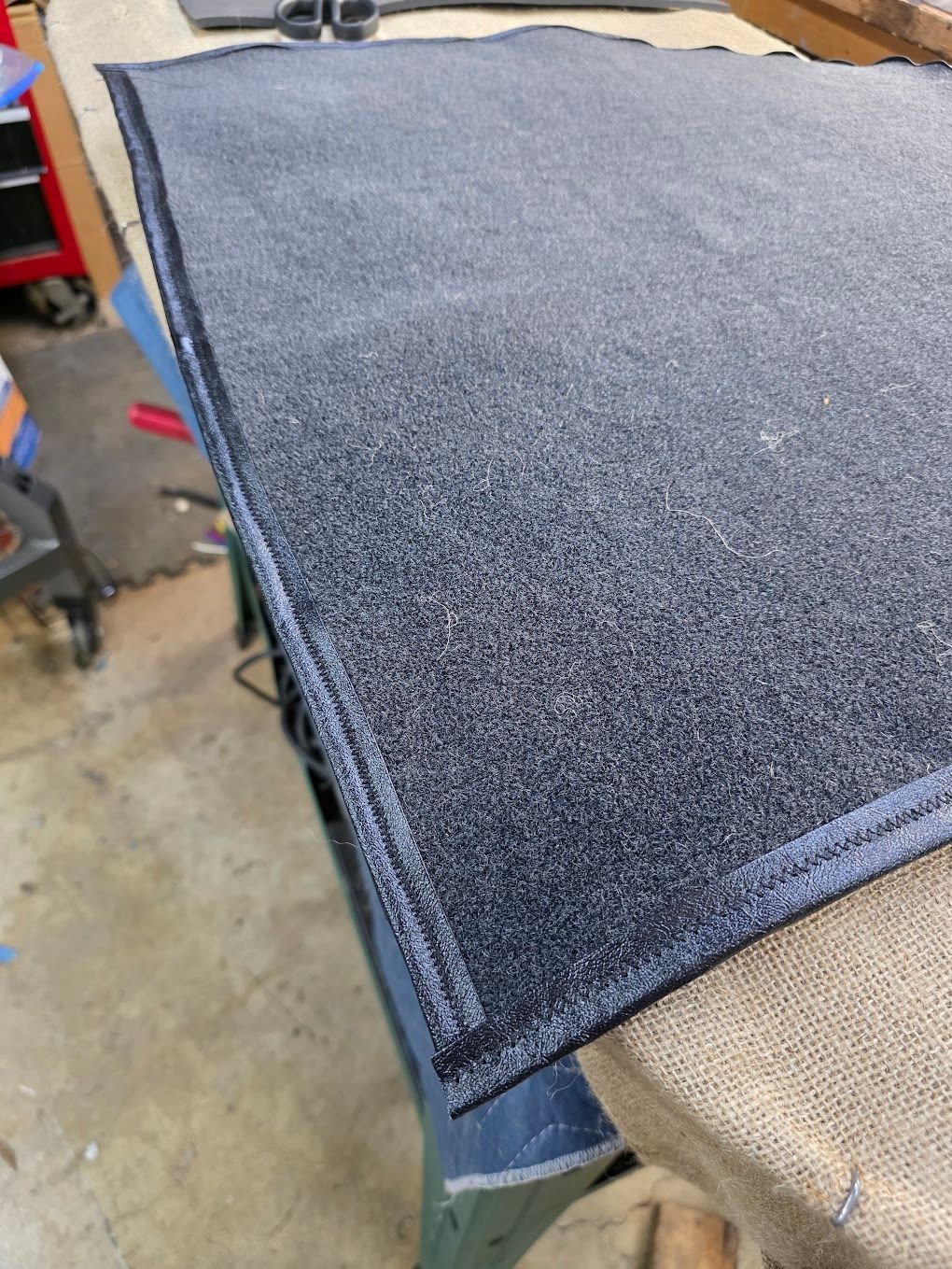

Tonight I was able to finish the left and right front carpet sections, which means that I am now done sewing.

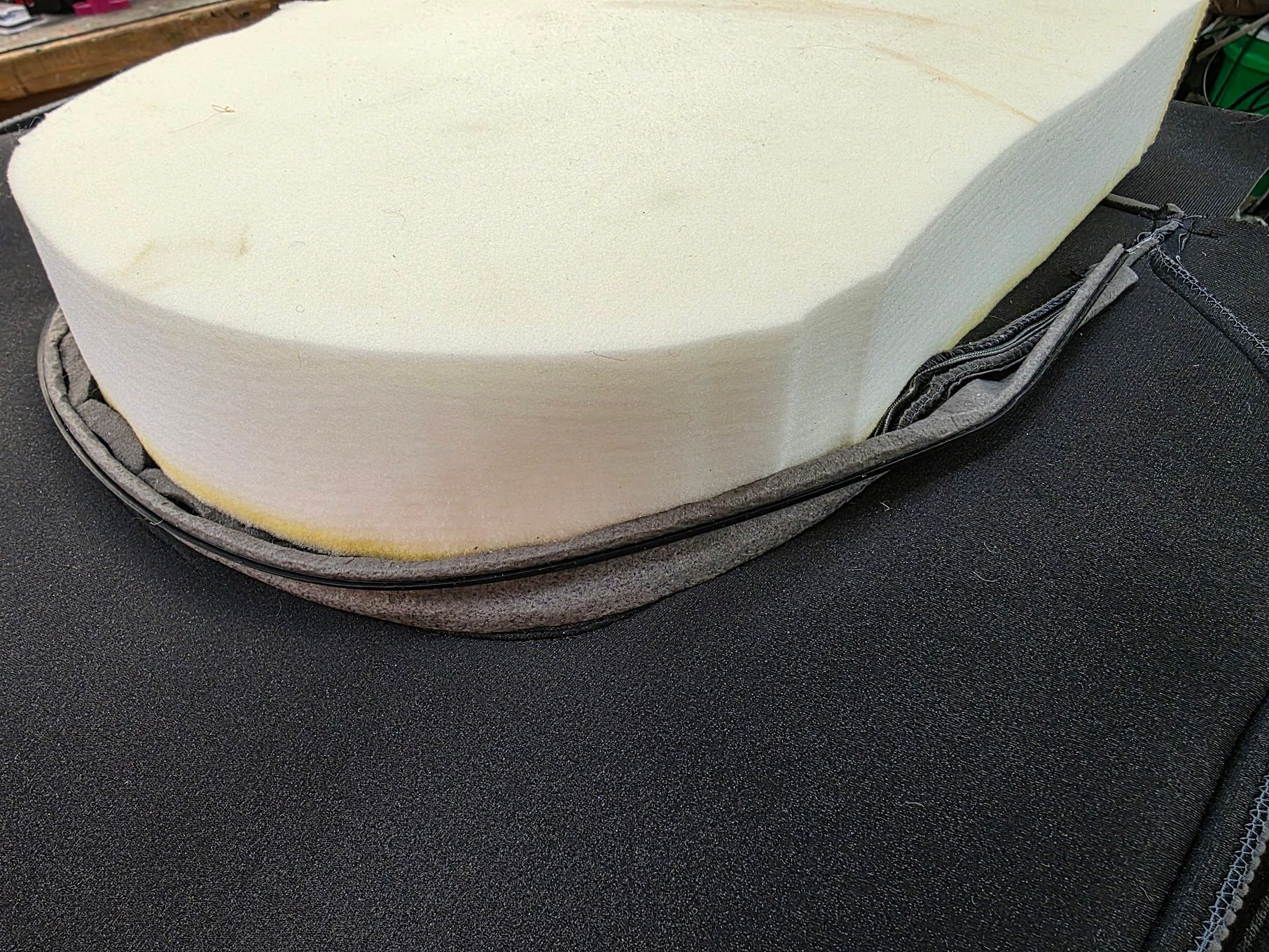

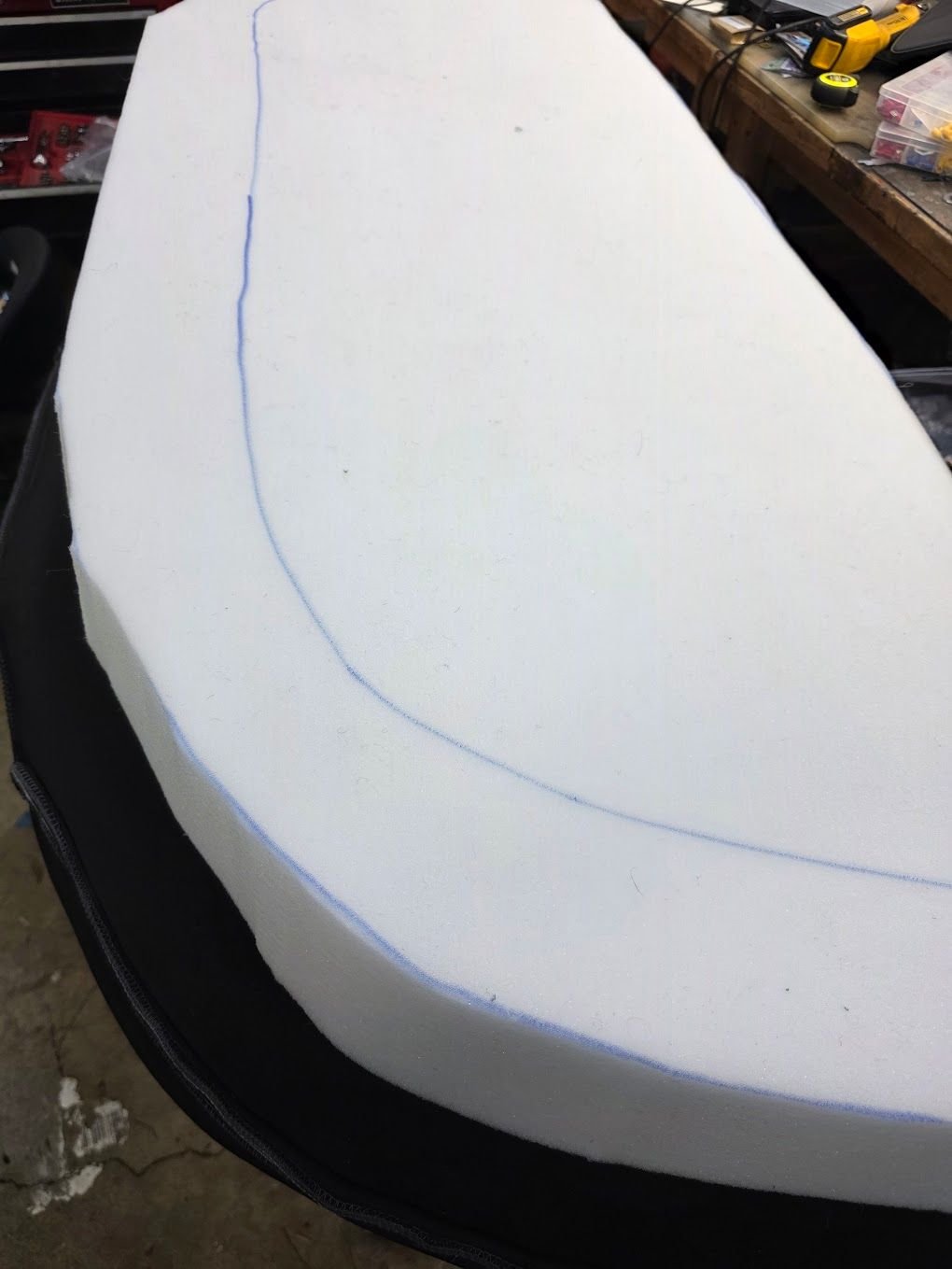

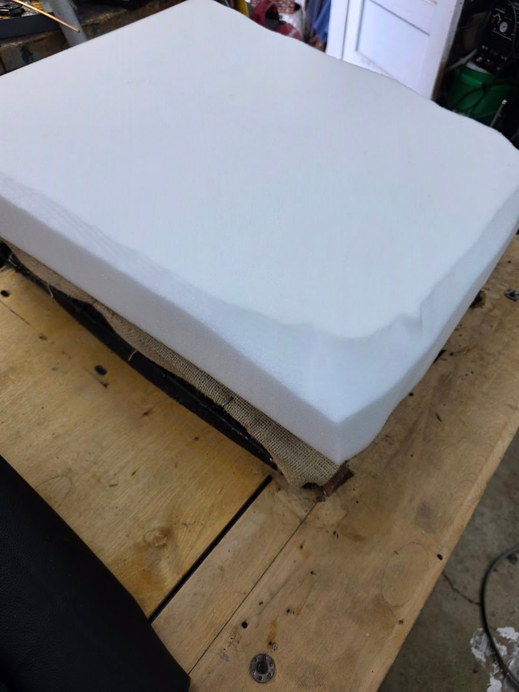

I got my last shipment of foam today and started working on the rear seat bottom.
Here's a close-up view of the plastic rod/welting that is sewn in the section between the pleats and the flat section. The idea is that you hog-ring the plastic rod to the spring base to give the seat shape.
Here I am starting to mark where the plastic rod will be; I cut along the blue line so I could hog ring the plastic welt.
Checking the fit in the car before I finish nailing the edges down.

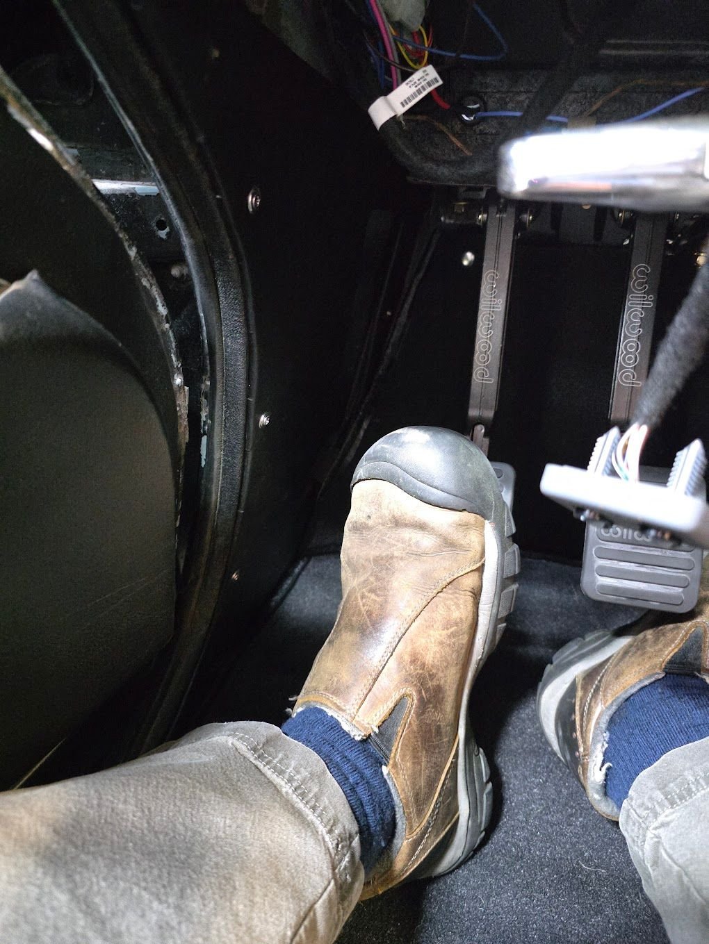

I thought about speaker pods on the front kick panels, but my left leg would rub against it when I pushed in the clutch.
The front doors aren't really a great location either.

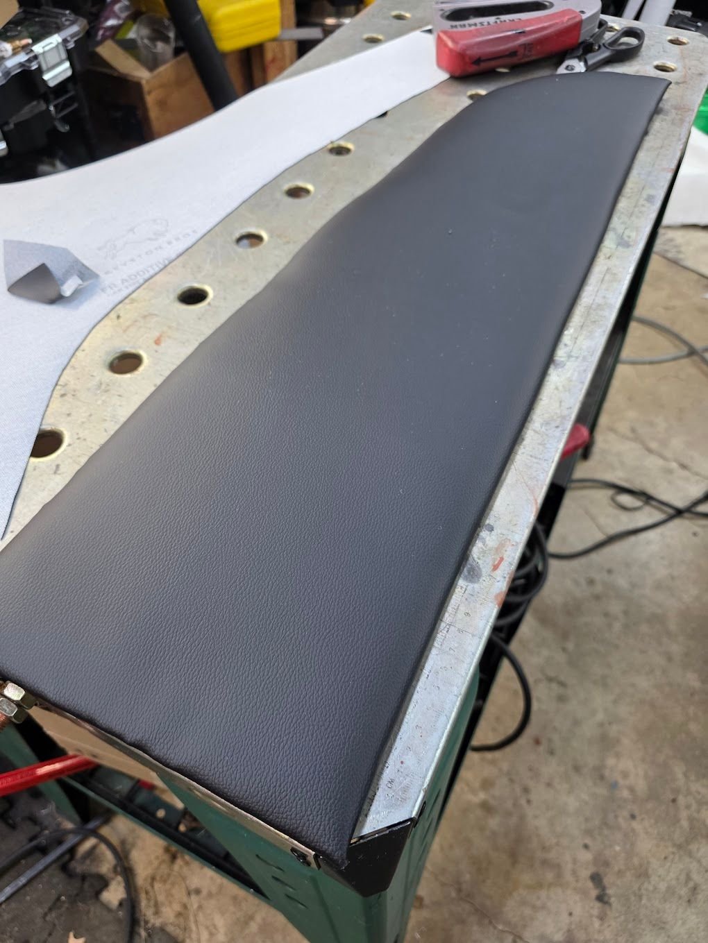

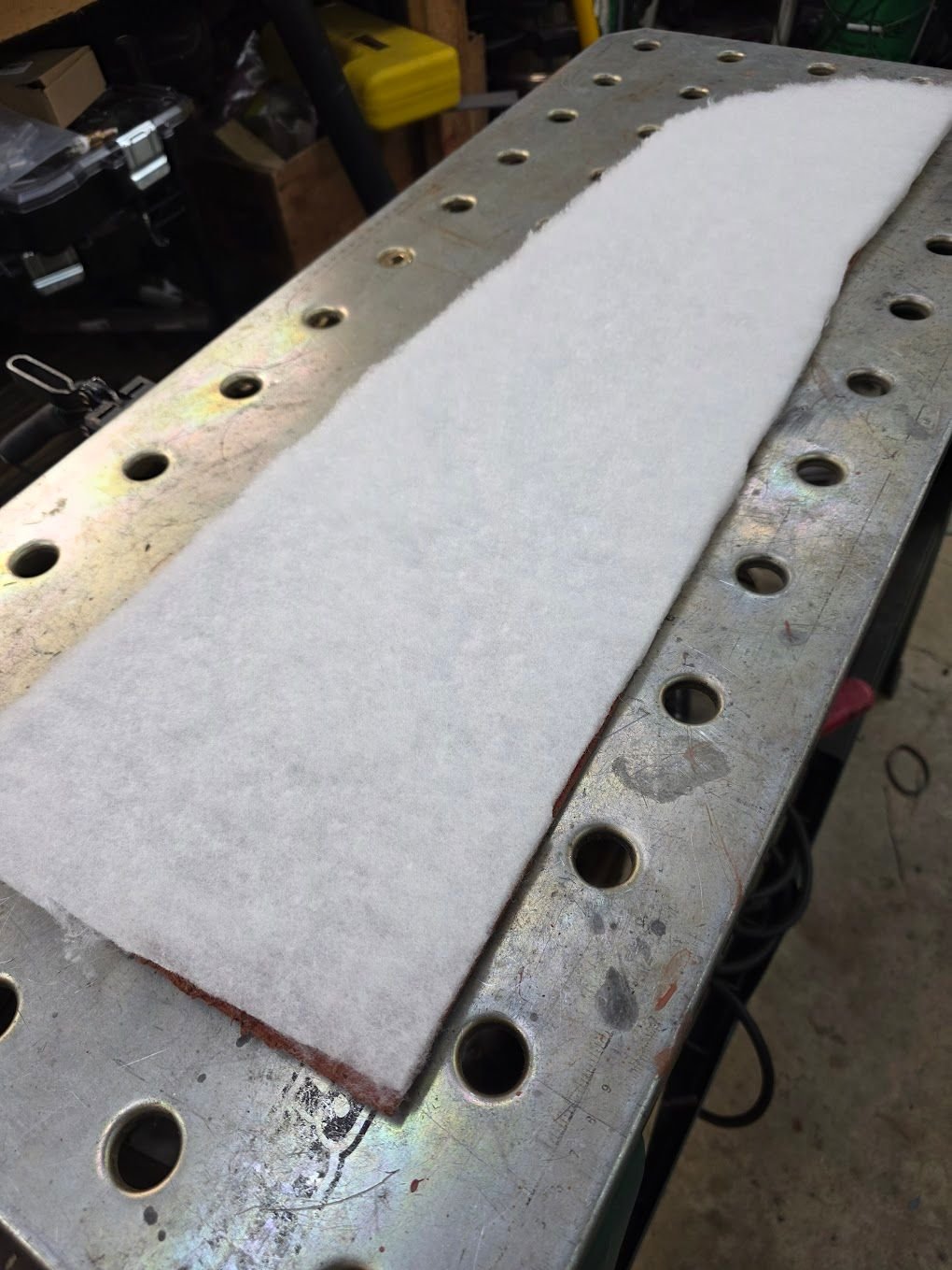

I started off tonight by finishing the rear parcel shelf panel. This is hidden between the rear seat back and the very tiny rear window and will never be seen unless someone is looking specifically for it, so I decided to experiment. I glued a 1/8" piece of fiber to the panel first.
Then I wrapped it in vinyl, exactly like I did the front kick panels. The thin layer of foam gives the parcel shelf a little more depth and makes it more appealing.
But like I said - no one will ever see this piece.

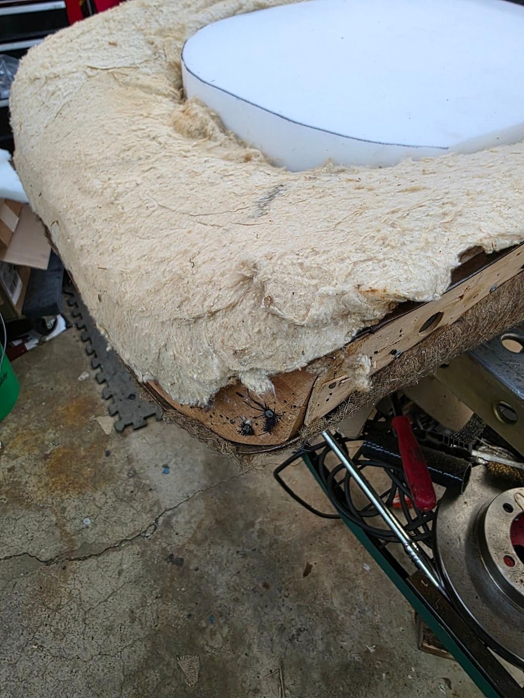

Next up was pulling the driver's seat out of the car and stripping it down.

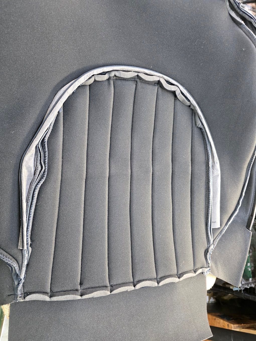

After cleaning up the frame I cut the inner section of the seat bottom.
This is the underside of the seat bottom. The section with the pleats is the inner section where your butt goes, and the smooth part is the outer section where your thighs are.
This is the seat bottom still upside down, with the inner foam section in place. You can see the plastic rod/welting - that is tied down to the spring base to give the seat shape.
Here is the seat bottom about halfway done. You can see how the seam between the pleated section and the smooth section has some shape/depth to it - this is the result of the plastic rod/welting pulling the cover down to the seat base.
