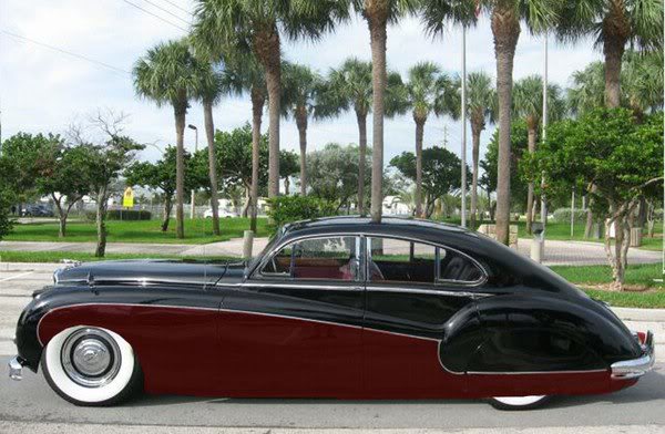

I love it and will also be watching with as much interest as a 10 year old child waiting for Christmas. I have a 1959 Mk IX waiting in my barn for its day in the shop and it will not be a stock restore either but a modern driveline and suspension with a reworked coachworks style body also. Here is the photochop of my idea. Most people will think it is a stock body but I am going to chop the top 3" and make a fleetline style slope to the roofline.

BEAUTIFUL Design!!! This would be epic! I wish you luck on yours, as I work through mine also. I haven't been able to do much because of budget issues and work, but hope to get back on it soon!
