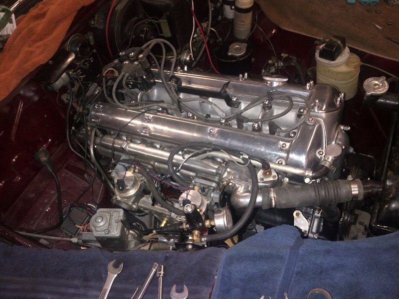

Thanks for that. Most interesting. I run a Pertronix Ignitor with their low impedance coil (debranded) but a stock fully rebuilt Lucas 22 D 6 distributor set up on a good old Sun machine that I will not change for concours reasons. (still positive earth). SA Judges never seem to notice the coil now with it's correct Lucas sticker on it correctly positioned
Work in progress. Many corrections after this & pre correct decals which I still have not finished attaching but I had to show the Judges that I had all the correct ones to satisfy them which was achieved. Even have the correct fan motor markings thanks to to Alan Wiedie who is a member here but spends most of his time on the S Type Register. He even found me the correct terminal cover for the washer bottle that is now rotated to correct position.
