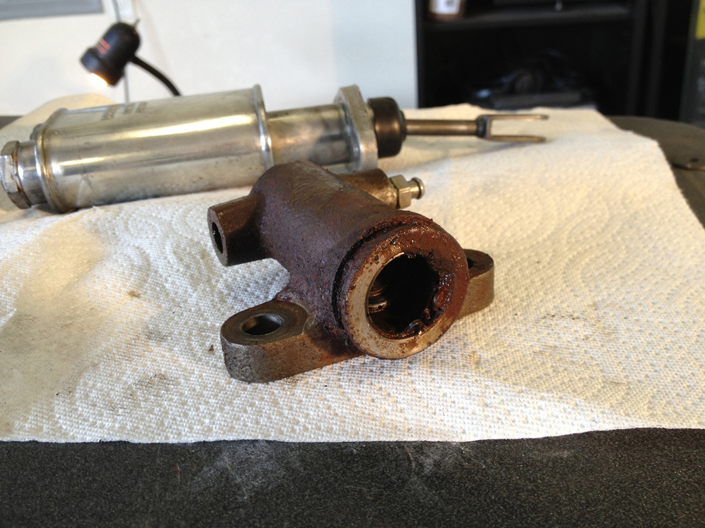

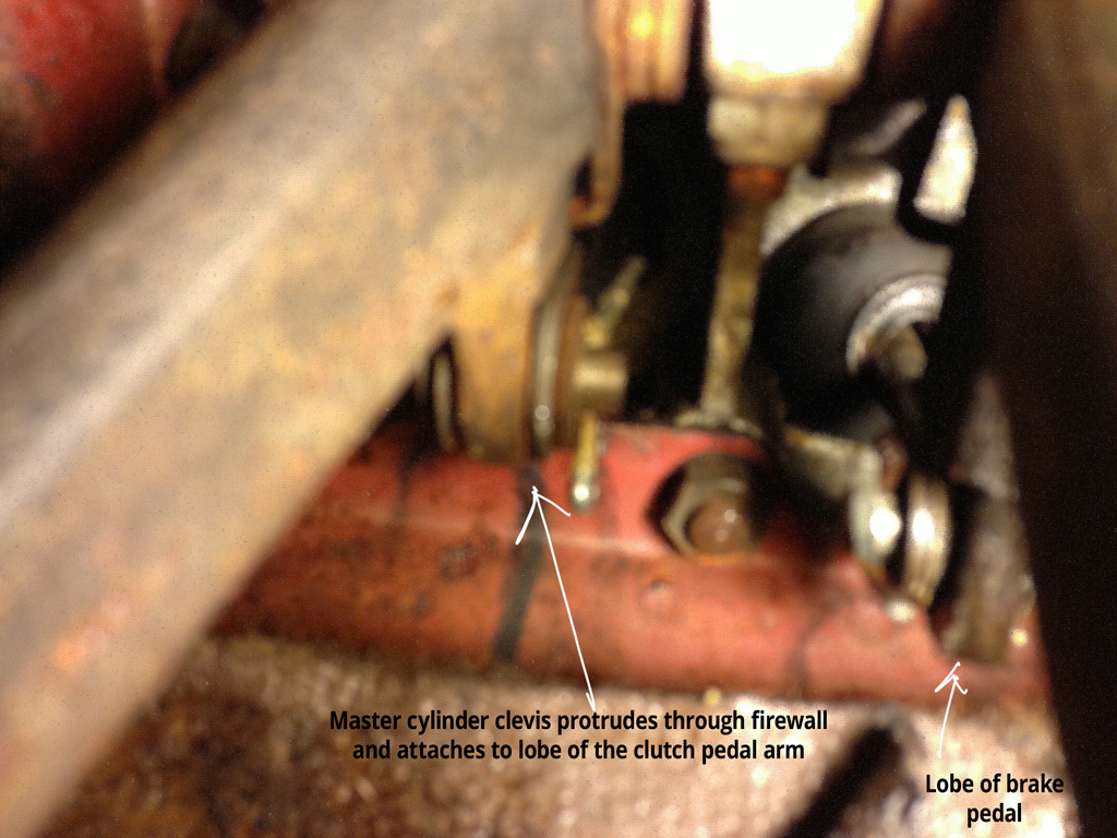

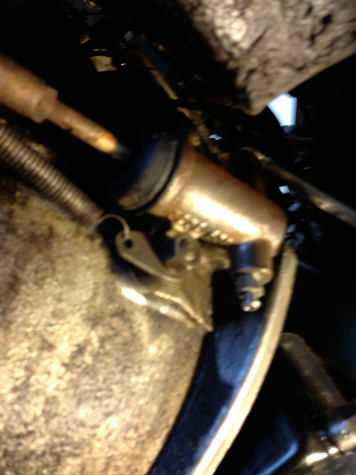

I finally started on the clutch hydraulic system, which was a mess. I ordered a master and slave cylinder kits and pipe kit. In the process, cleaned up the heater blower box and vicinity. After sitting for a few months, the engine wouldn't start. I checked the fuel line and all filters. Everything was clear. I used a spark tester on the coil and plugs. Plenty of spark. The fuse for all the switch items was blown. The manual lists those items, but doesn't include other items which only appear in the witing diagram...including an electric choke. The fuse was replaced, but the car didn't start. I noted that the circuit runs through the voltage regulator. Once the voltage regulator was tripped, the engine fired right up.
At first, because the clutch wouldn't disengage, I thought I hadn't bled the system sufficiently, so I bled it again. This time I happened to press the clutch to the floor and it disengaged. I hadn't adjusted the pedal at the slave cylinder plunger, so when I did that, voila!, everything worked. I took it for a drive to the corner and back. The silencers are shot, so it's VERY noisy. But it works.

As previously posted a few years ago, I "fixed" the hydraulics for the clutch system. Son James has licensed and insured the sedan and purchased an exhaust system for it which I took to a muffler shop. There were a number of issues that specifically 1961 MK2 owners should be aware of when ordering and installing a new Bell-mfg exhaust system, and with taking the car to a non-Jag shop, even though it specializes in exhaust systems. More on that if anyone is interested.
Regarding the clutch, it has been replaced. The hydraulics seem to be the problem. Driving to the muffler shop and back home, the clutch/transmission would sometimes not re-engage after a stop...until I pumped the clutch pedal.
What do you suggest to fix this. Just a reminder. I am not at all mechanically intuitive. Often the opposite.
I assume you mean you can't get it into gear without pumping the clutch, if that is the case I would look at air in the system or adjustment of the clutch operating rod. For adjustment have a look at Gearbox, Clutch and Propshaft ? Valve Chatter, any problems, let us know.

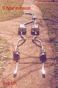

just to add my experience with Bell, I ordered a complete Bell Exhausts stainless steel system for my S type in 2005, installed it myself placing the tires on blocks and jacks in other places.
It fit like a glove, no issues. All mufflers and resonators were beautifully polished, came with all hardware needed, except I used Band clamps which do not crimp the joined parts like the U clamps do. No welding, Jaguar never welded exhaust parts. Also used Permatex Exhaust Adhesive because I could not get Jaguar's recommended "Firegum" in the US.
It sounds like a Jaguar XK-120.
the photo below is when I laid everything to check and familiarize with all the parts.

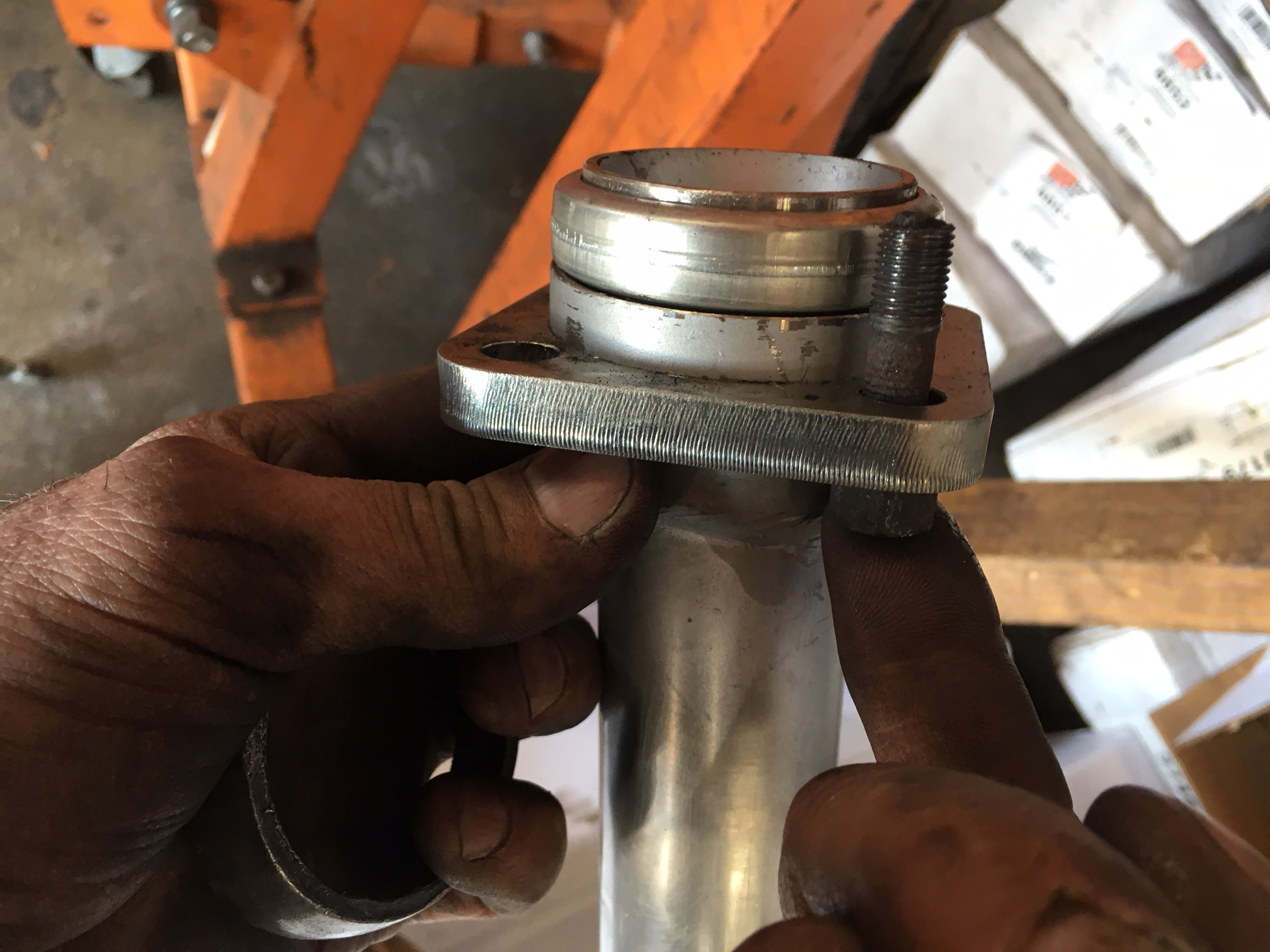

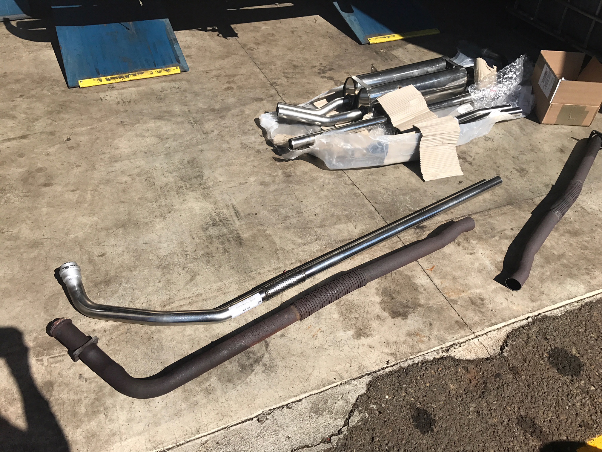

For the record I just went through something similar to The Thread 1960 MK1 3.4L Exhaust. I specifically ordered the early system, which turned out to be wrong one, for my son’s 1961 MK2 3.8 Sedan. There are two types for 1961. Unfortunately the production number I used steered me wrong. And Barratt’s website shows a picture of one type, but not the other type, so I went by what I thought should be right. I thought we had the early version, but the headers with the 90-degree bend are the later model pipes and, as it turned out after they were removed, were the ones on the car.
The instructions for mounting the system are straightforward, even easy. Initially I thought I just do this myself, but I was busy moving the office and home improvements.
So, noisy as it was, I drove it to a muffler shop where a tech old as me with 30+ years experience would mount it for flat labor charge of $90/hour. He soon discovered that the headers I gave him, if installed, would scrape the ground. They were designed for the early 1961 models.
At first I thought it was Barratt’s error, and I was not happy since I might have to have the car, now with no muffler, towed home until the replacement pipes arrived. Though from the comparison photo I texted to Barratts on the spot, we discovered that it was my error. Barratt graciously shipped a replacement set and paid shipping for the incorrect set back to them. Don’t expect them to do this for everyone. I doubt it’s their policy. I was very appreciative and over-wrapped the set I returned so much that I had to name it The English Patient.
The shop was very good about keeping the car, though they had to move it out and back in the shop every day for a week. One of those days was the Tech’s birthday, so he took the day off and went to the coast to celebrate. The younger tech had to move the Jag. And here is a word of advice if you take your vintage Jag to any non-Jag specialty shop like a tire, brake or muffler place. Show them how to start the car. This fellow didn’t expect it to start like a Prius with a button. He thought he should turn the key and get starter/ignition. Nada. So he kept twisting expecting to hear the starter, and twisting until he loosened the switch, thought he was getting somewhere, and kept twisting til the wires pulled off the back of the switch. Then he had to push it in and out til the old tech got back and did a temp fix.
In a few days the replacement pipes arrived. I was now at the bottom of the list, so a day or two went by before they got back on the Jag and discovered the studs were too short. Barratt said they’d never heard of such a problem with Bell exhausts, but this thread shows that more than one person has experienced this problem and it’s a nasty one. 2-3/4” or 3” 3/8 fine thread blackened hard studs are not that readily available. NAPA didn’t have them. The muffler shop doesn’t stock them. No Jaguar dealer or Jag repair shop in Portland stocked them. After hitting the unusual auto supply suspects, I went to the decades-old Ace Hardware I used to visit every Saturday when I was restoring my ’40 Packard convertible. They had 3-1/2” hardened studs with 2-3/4 fine thread on one end and coarse thread on the other.
The tech welded a nut to the tip of each of the 8 studs and got them out. He cut the coarse end off the replacement studs and installed them. The system did not “fall” into place. It had to be muscled in. But it fits and the car purrs now. O yes, 3 hours labor for what I thought would be a simple little job.
