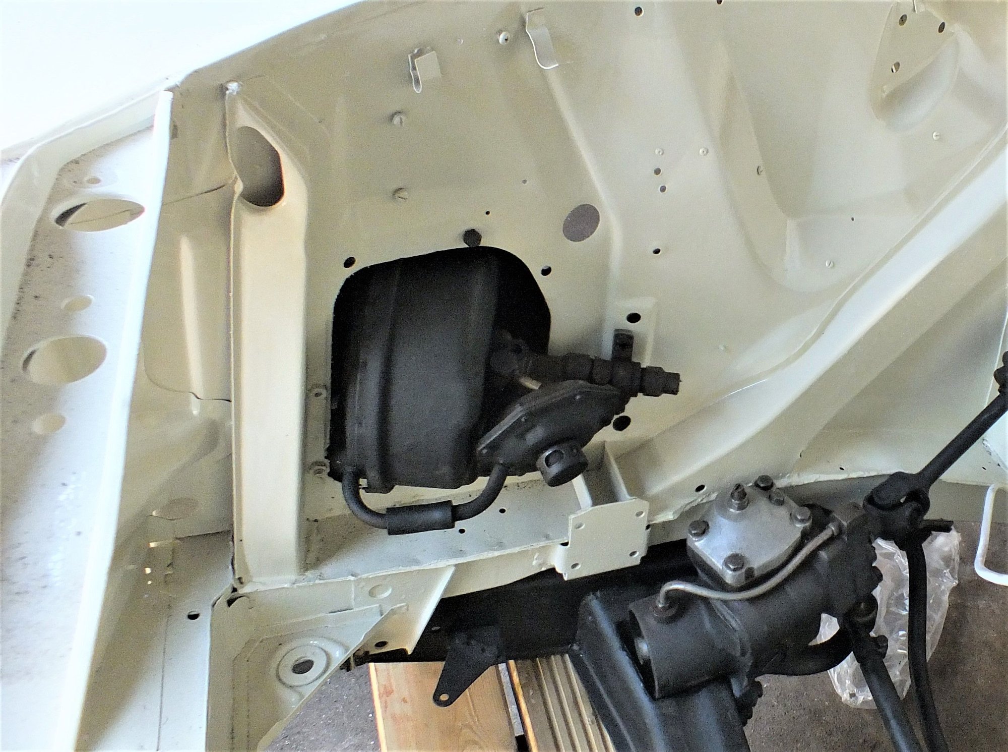

On the S Type which has the same set up both the servo and cowling go in from the wheel well side as the cowling sits against the inner wing and the screws go through the cowling into fasteners which sit on the inner wing.
The servo can be removed via the engine bay when disconnected from the cowling but not with the engine in situ so it goes in via the wheel well and the cowling is fitted over the top.
This is the servo fitted but not plumbed in yet and as you can see the cowling is outside the engine bay.
