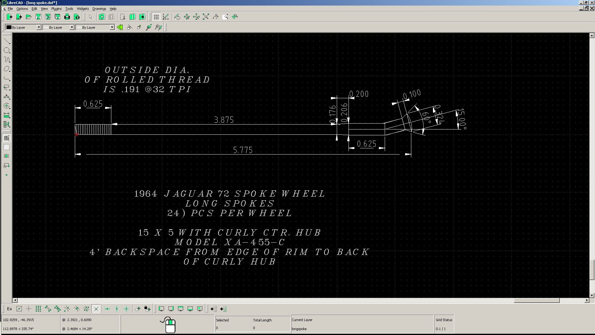

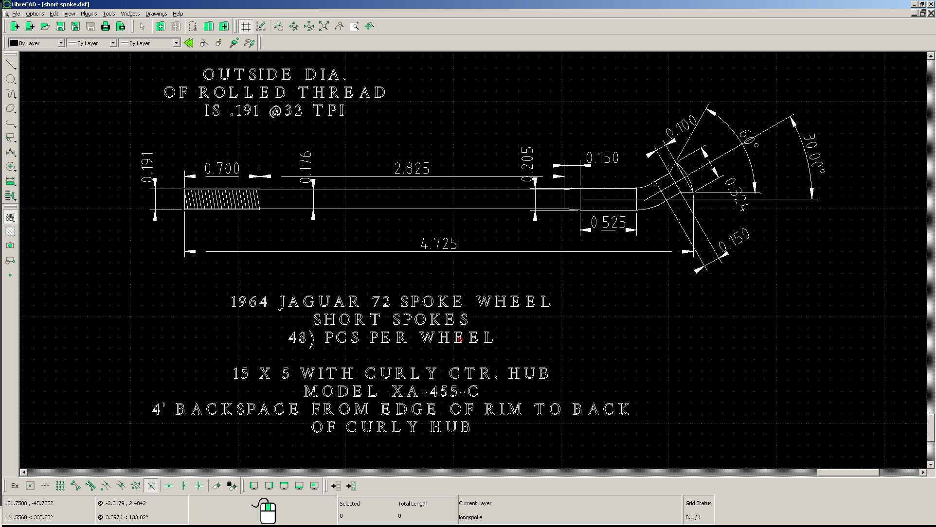

cutting off all my rusted spokes, sandblasting the rim and curly, painting them purple to match the body, and relacing with custom made stainless spokes with blue anodized nipples
the quoted cost for spokes per wheel is around $323.00 US
If anyone needs spokes in plain steel or stainless
I found a place in Azusa California called
Buchanan's Spoke & Rim, Inc.
805 W. Eighth Street
Azusa, California 91702
Tel: (626) 969-4655
here are my measurements of the original spokes
