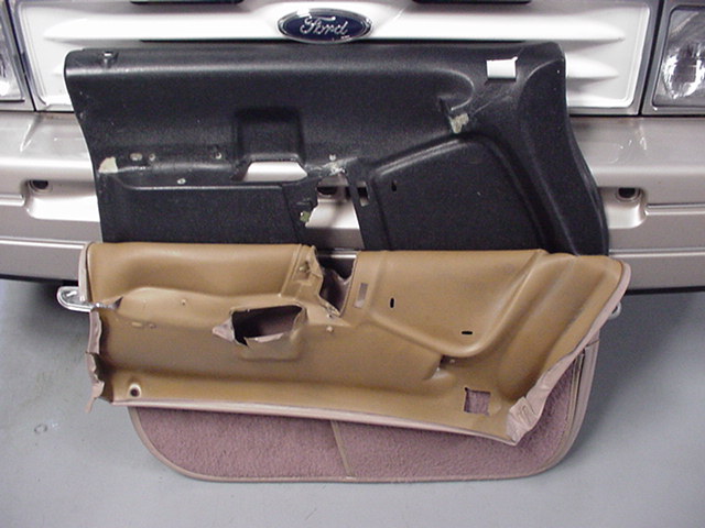

what I would do is preserve the original console, reinforcing and stiffening the original console with fiberglass & resin, a lot easier to do. I assume you already removed the vinyl and leather coverings from the console "form"? apply fiberglass material and resin over the weak areas using a fiberglass kit (fiberglass and resin). I recently repaired modern plastic door panels/cards that crack from wear and tear, with a fiberglass kit sold by the Bondo Corporation and other restoration suppliers. It positively fixes the problem and stiffens the cracked areas better than new. The below pictures show the repair I did. I also added fender washers under the fiberglass to reinforce the mounting screw points. (not a Jaguar but the idea applies to any car repair).

Thanks so much for the reply Jose. I think this is the most sensible fall back for the console. The washer idea is excellent. I have not stripped upholstery from either console yet. My restorer said he had heard that someone in Canada was making a repro. I've asked Bas & they know nothing about it.
