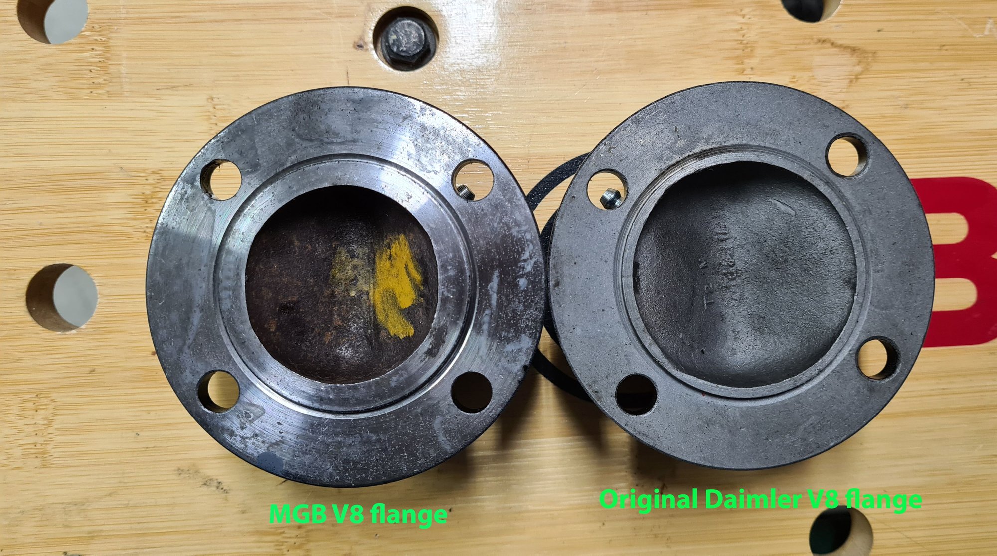

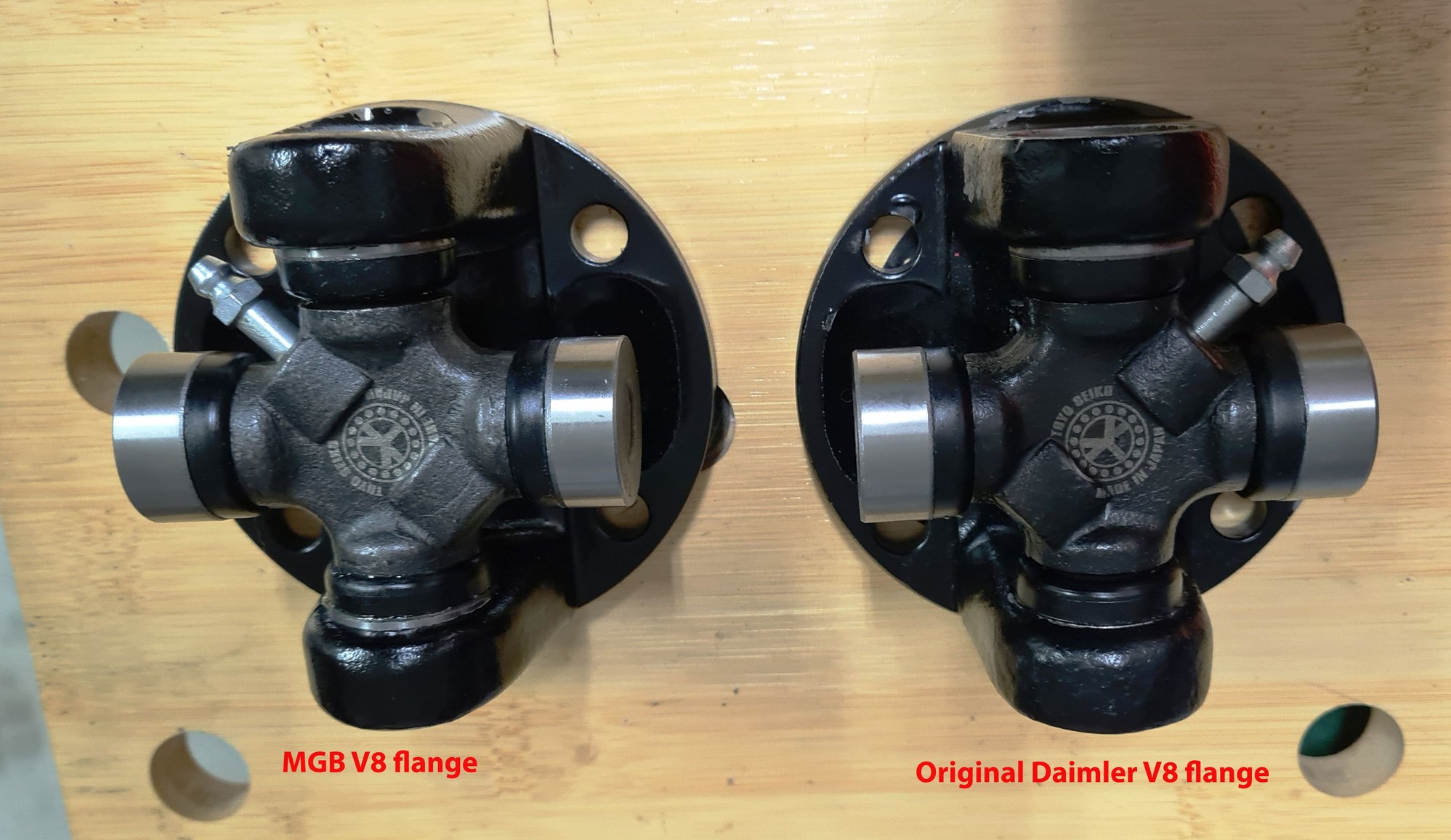

Default MGB V8 propshaft universal joint flange used for Daimler V8
I ordered a flange for an MGB V8 and found that they were exactly the same as the Daimler V8 flange.
The only difference was the rear of the flange but the diameter of both, mounting holes etc. are the same.
Original Daimler V8 flange on right and the MGB V8 flange on left.
Original Daimler V8 flange on right and the MGB V8 flange on left. New universal joints installed.

I like those long grease zerks. Did those come with the u-joints?

Hey Jerry.
Yes the universal joints came with the long zerks.
The universal joints are TOYO K5-L4R UNIVERSAL JOINT
