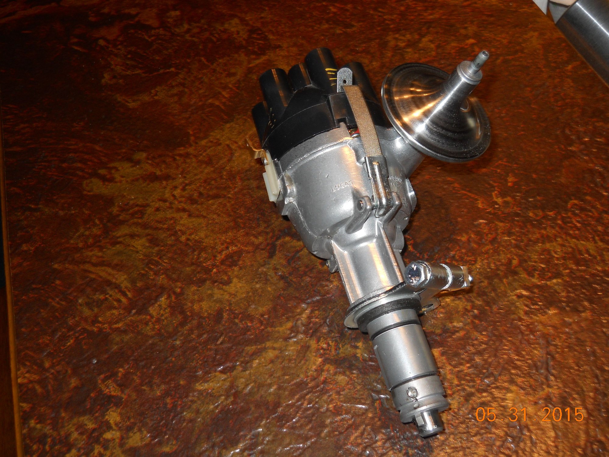

advanceddistributors.com sent back my rebuilt distributor. Sure looks great.
Thanks Jeff for a great job.

Old Jun 2, 2015 | 09:43 AM
JeffR1's Avatar
Joined: Aug 2013
Posts: 1,828
Likes: 805
From: Lake Cowichan BC Canada
Originally Posted by DevilDog
$140 and included shipping.
They did rebuild it, they just didn't polish it up ?
They should have replaced the main shaft sleeve bearing weather it needed it or not.
There should be no side to side play in it at the points end.
