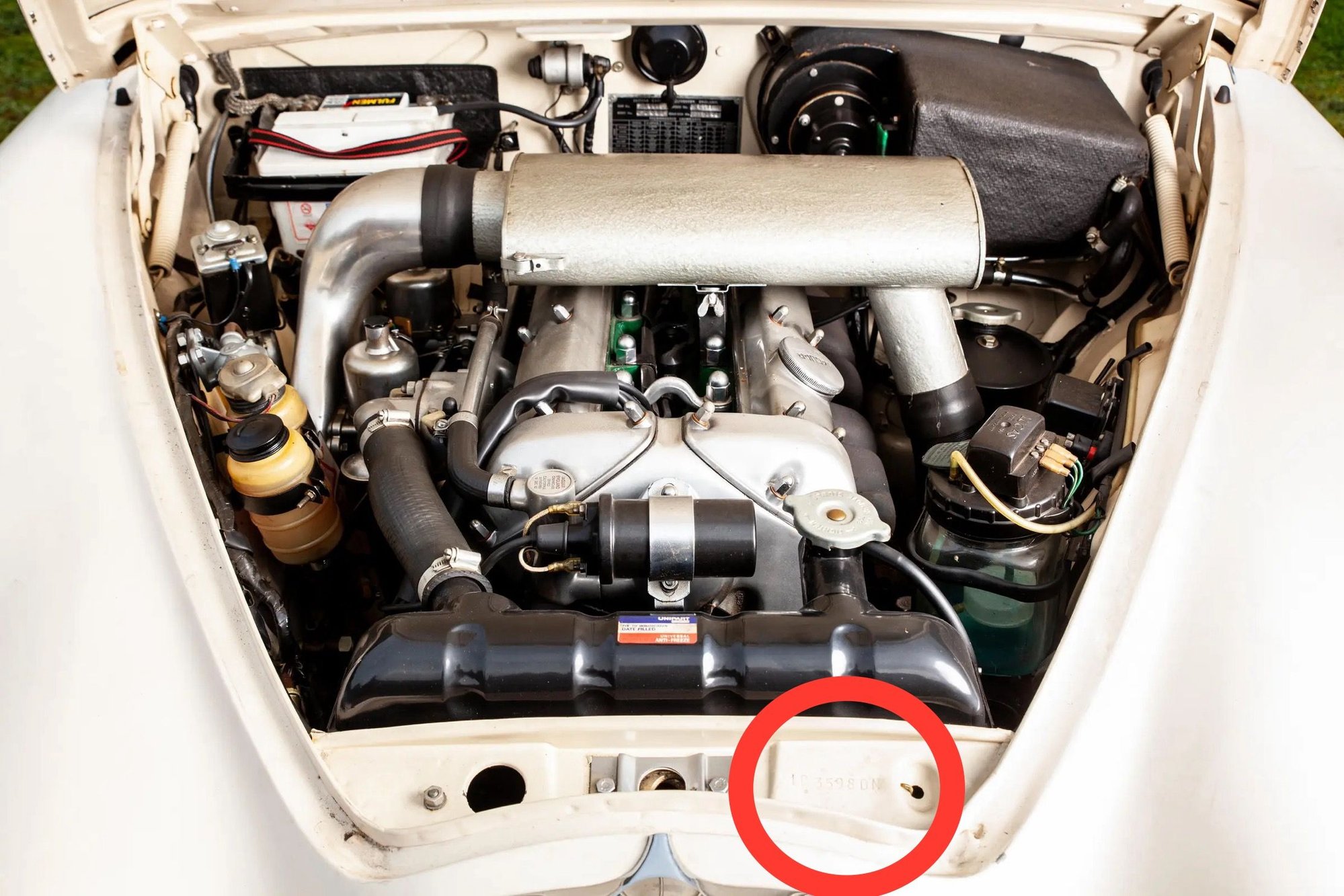

on my -64 S it can also be found stamped into the metal on top of plate just in front of radiator (to the right of latch seen from front looking into enginebay) Picture for illustration

The slam panel is the most common next to the latch but Jagboi owns one or two of these vehicles & would be the most likely to be correct. Someone might have removed the chassis plate.

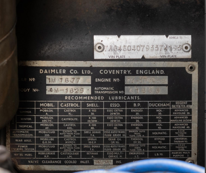

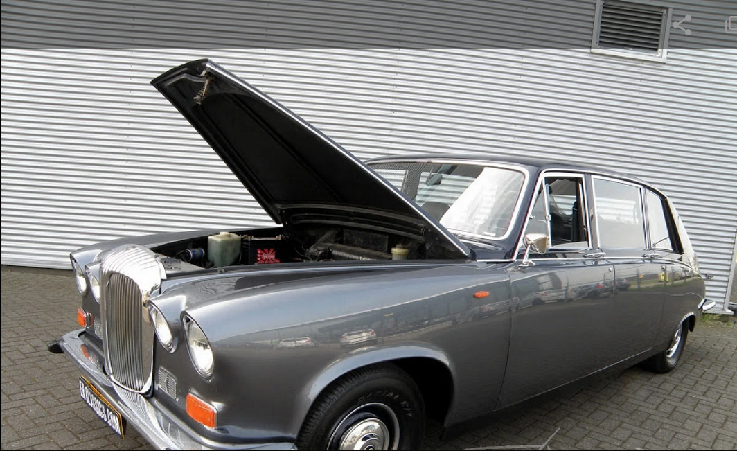

Likes: 1,495
DS 420's I find have a crocodile bonnet/hood ~ unlike the 420G/Mk X ~ man they are huge beasts.
And are marked as Jagboi says: This one includes a VIN plate but old data plate. Might be a Country requirement somewhere.
