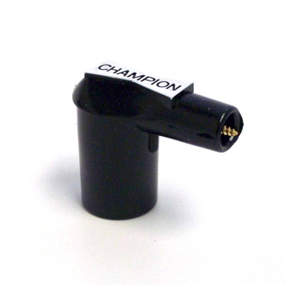

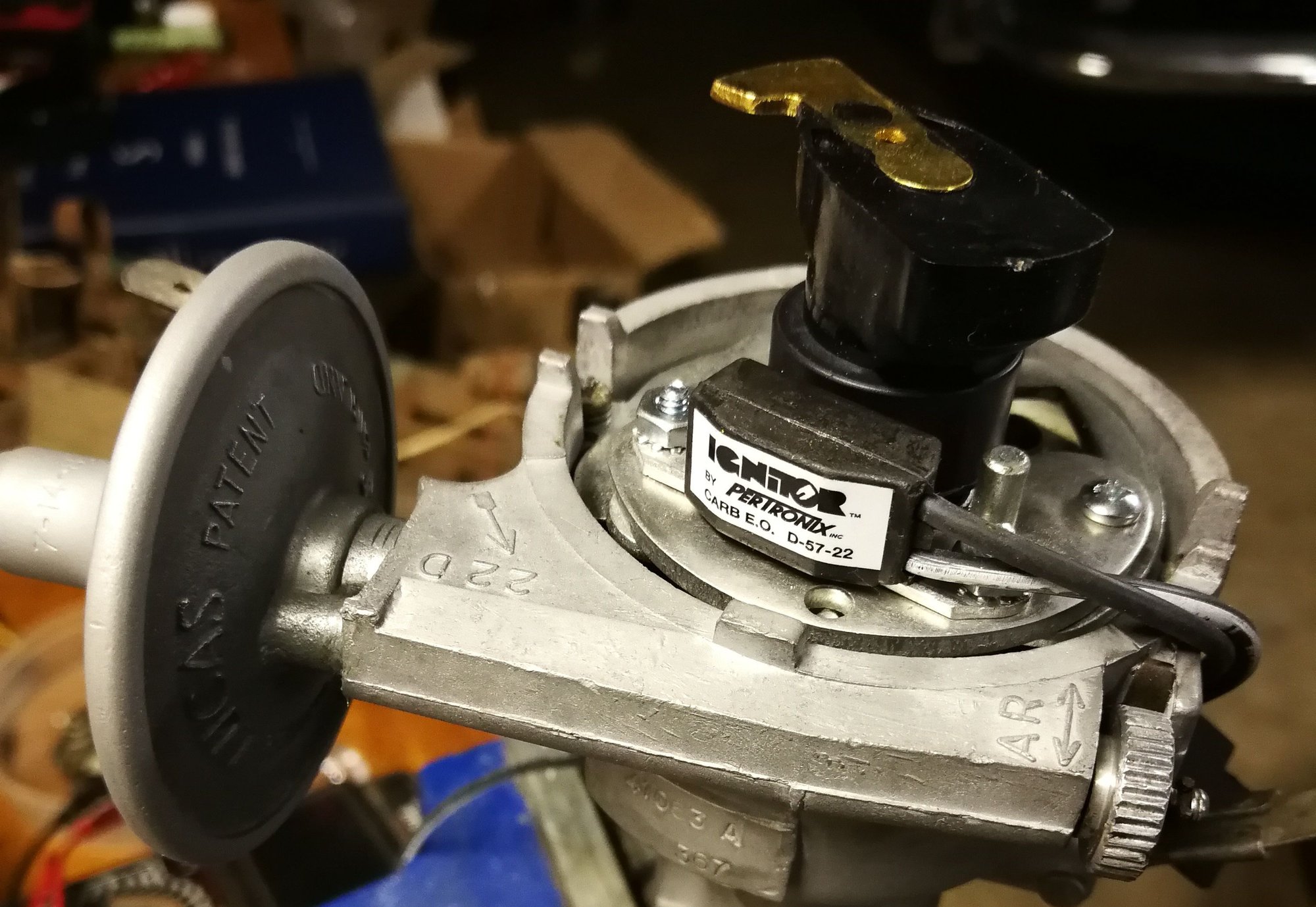

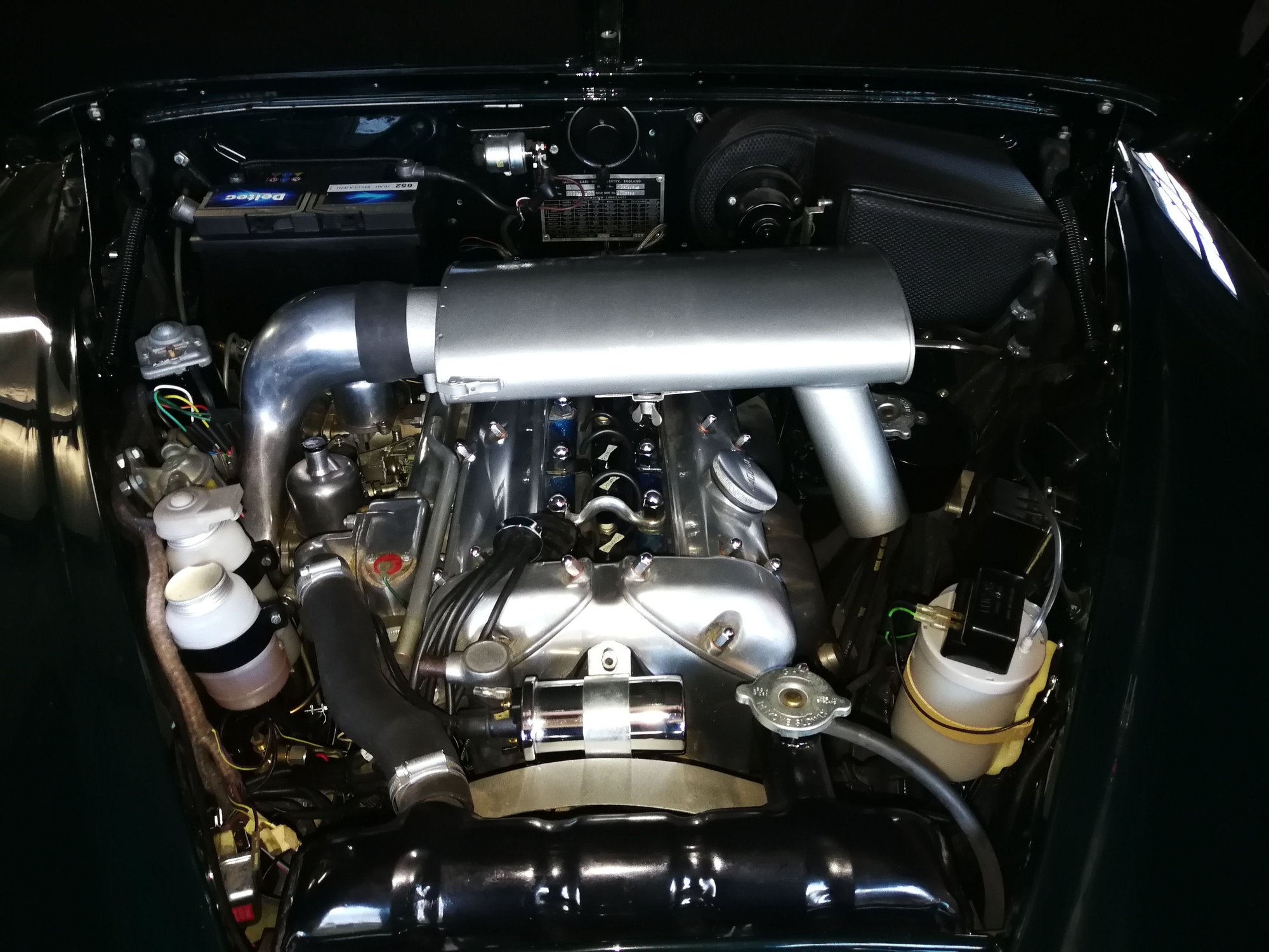

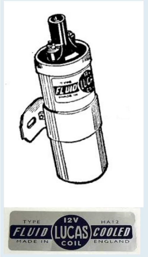

I used the genuine Jaguar lead set with copper wiring. I've taken a good peak under the bonnet at night & zero crossfiring between leads. No misbehavior. And I'm running an uprated, debranded by yours truly, Flamethrower coil. Now has correct Lucas sticker on it. I'm running the PerTronix Ignitor pointless ignition system contained within the distributor cap for POSITIVE earth.

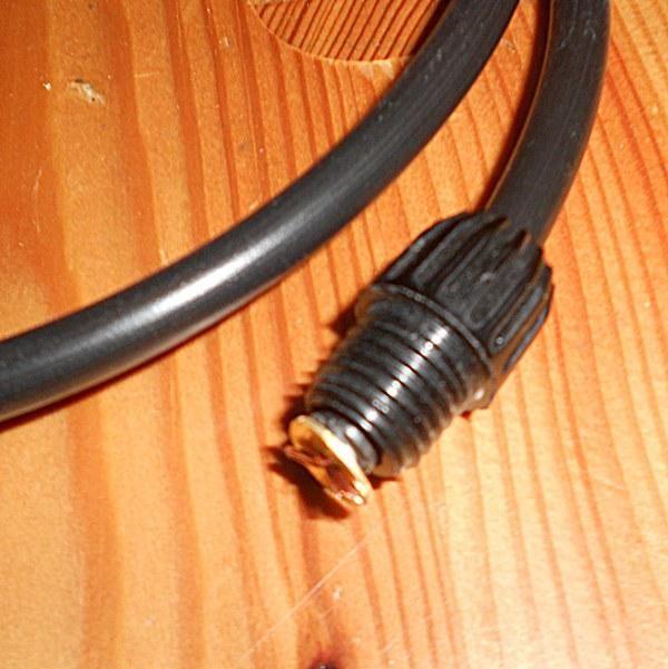

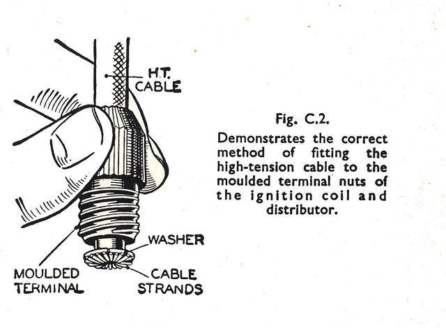

Used these plug caps that were supplied with the kit.
Work in progress.
Split brass washer
So called "Acorn" nuts

PerTronix Ignitor system for interest.

My vernier is MIA. Just take an acorn nut/plug cap/round spacer with you when you buy new cable for sizing.
The spread wires are not soldered to the brass washers. Any old school auto electrician should have the split brass washers. I'm sure you don't want to go to Barratts for them unless you are ordering a conduit. Shannons in Aus might be able to help you. Otherwise you will have to make your own.
