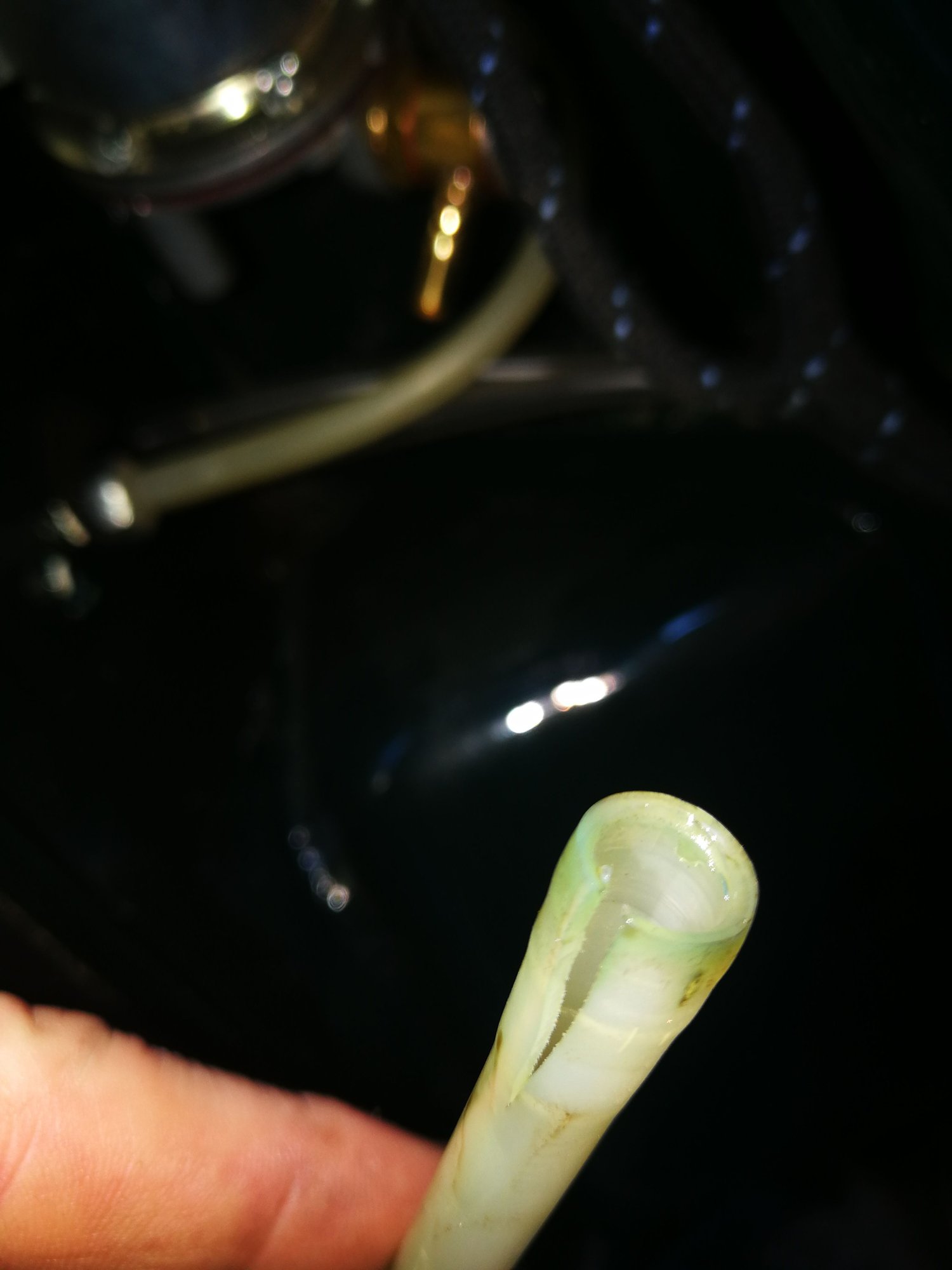

I'm not going to bore you with a long story. But on one of my early drives with the car after restoration I switched from one tank to the other and the engine stumbled & backfired through the carbs the minute I tried to accelerate. Switched back to the other tank & no improvement ~ both tanks were full. This is with new pumps, pipes et al. 10 days of fiddling & checking everything & advice from many Jaguar "specialists" including checking valve timing, another carb rebuild & distributor change we discovered the issue. This sounds very like what you are experiencing.
At all times there appeared to be adequate fuel flow at the carbs & filter & no sign of air bubbles in the fuel supply. The filter bowl was always full.
Then we found a split fuel pipe on the suction side of the left fuel pump. (due to alcohol in fuel). Replaced it and all was back to normal & running smoothly.
Conclusion: SU's operate at such low fuel pressure (2 to 3lbs) that this has to make them extremely flow sensitive. That split pipe was affecting the whole fuel system even though there appeared to be plenty of fuel at the carbs & no entrained air.
Can you rig up a gravity feed from a 5 litre can to your carbs & see if this remedies the situation. You might have a fuel flow issue from the tanks/pumps/rear Y pipe etc..
BTW ~ I would not have believed it but we have never had an issue since then. So I learned something that I would never have believed. Did a heap of work for nothing that made no difference until discovery of the split nylon pipe.
Of course the PerTronix Ignitor came under suspicion which is why we tried another distributor with points & new condenser. Had nothing to do with the issue.
The culprit. Fortunately the car is now at coast away from the 10% alcohol in fuel.

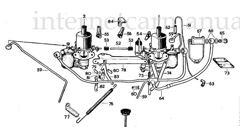

Check all that fuel pipework under the carbs that have to do with air getting into fuel supply, especially flexible hose from filter to float bowl feed Y pipe & feed from front carb to AED for leaks. If fuel is leaking out air can be drawn in. Might even have a crack in the Y pipe. SU Carbs seem very reliable but easily upset by minor issues.
Smell of fuel from the AED is common but there should be no wetness on the entire carb set up at all.

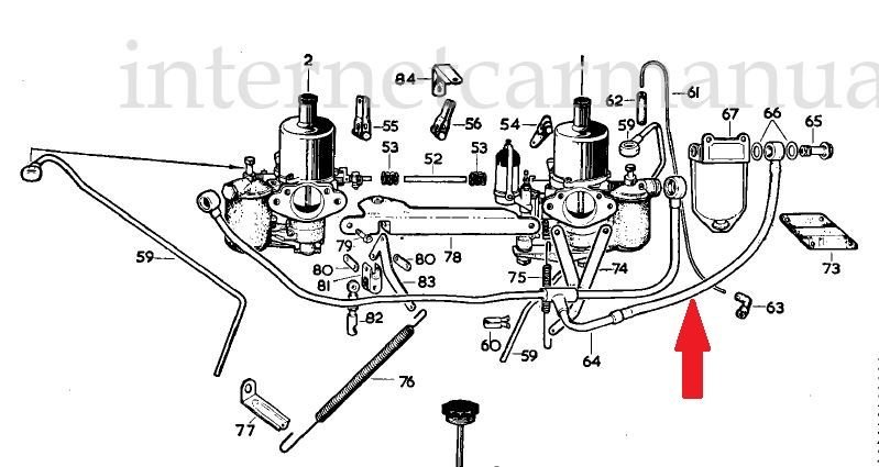

The picture I show is at the rear fuel pumps. Nylon pipes tank to pump & pump to rear Y Pipe ~ plus thin nylon pipes forming the breather network.

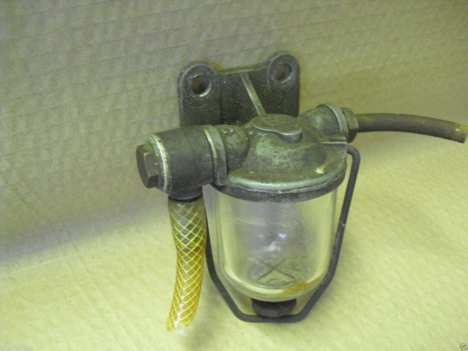

There should be a front flexible hose from the AC fuel filter outlet (Fuel Filter mounted on wing) to the carb Y pipe to tolerate engine movement.
Just nip up carb to manifold nuts firmly. Don't over tighten. Sorry I can give you a torque. Never seen one published
Flexible hose: Was originally Nylon.
Fuel Filter with non standard flexible outlet pipe

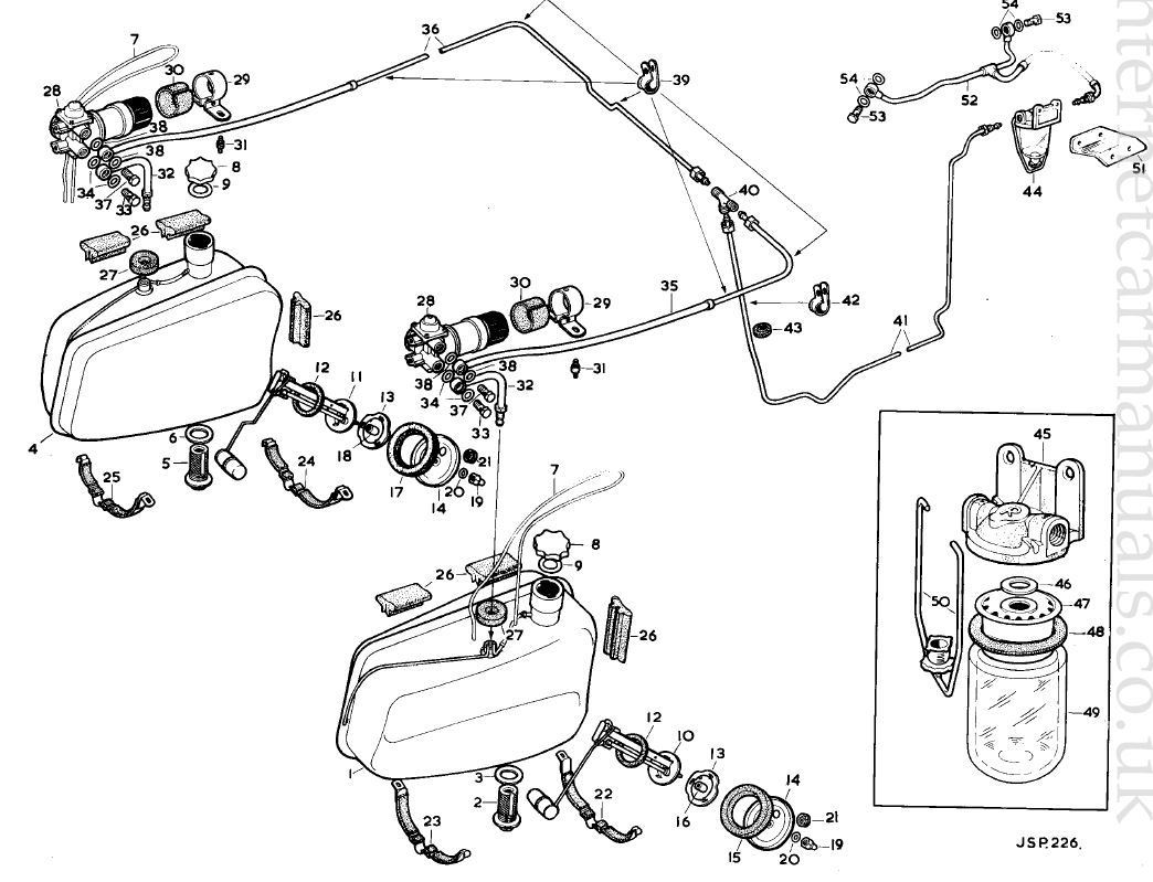

Agree with Cass. Time to check the other end of the manifold & the Servo vacuum line.
Here is the rear fuel system if you need to start checking that end. 32 & 35 are the rear flexible lines both sides.

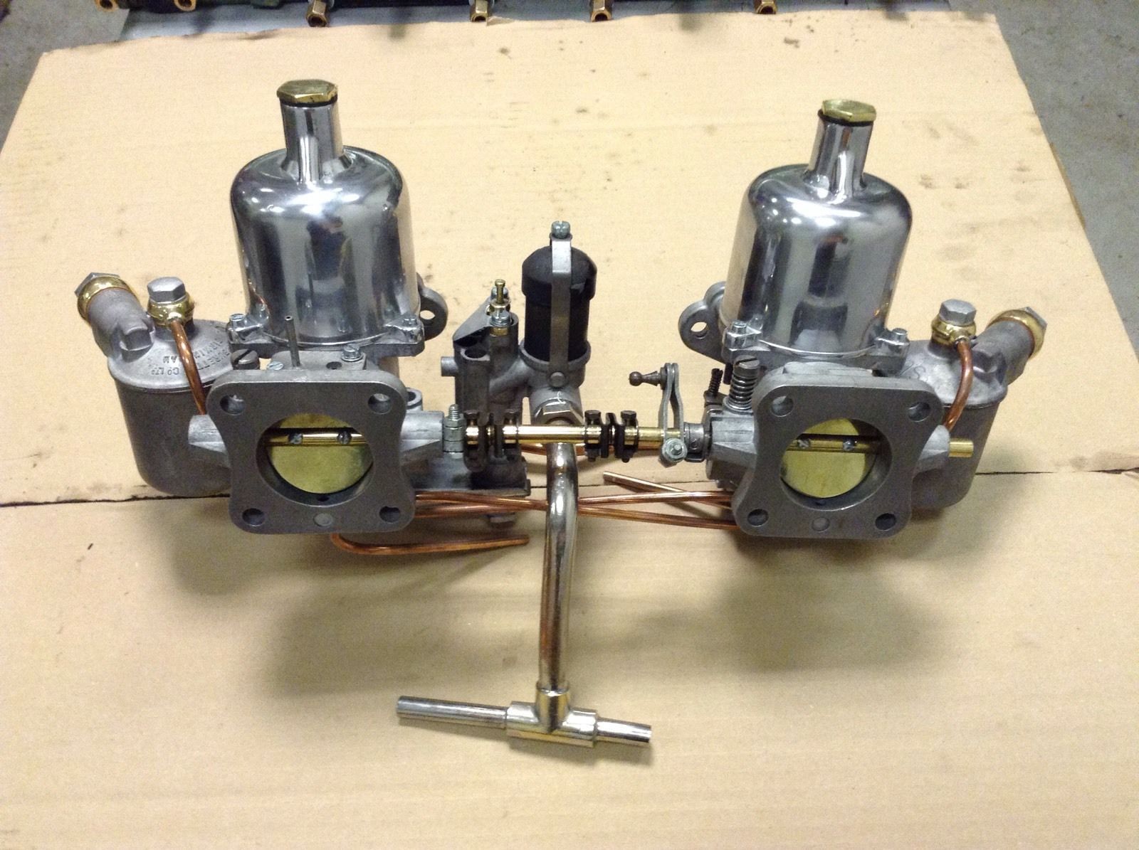

Your car should be fitted with a B type head & manifolding.
Here is engine side of carbs that shows the AED T pipe outlet that flexible hoses are attached to if so configured that Jagboi is referencing. These off of an older Mk2
