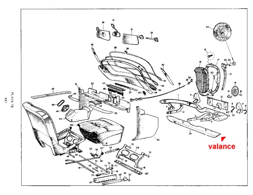

I am currently restoring a 1967 340 when I looked in all the catalogues in mentions that the 240/340 has a special front valance panel (part number MRK4 from Martin Robey/SNG Barratt) but cannot see how this is installed on the car. Any assisitance and pictures would be welcome

I think it is the same valance being reproduced by Martin Robey for the S type because the 340 uses the same front bumper as the S type;
it is an under-bumper metal piece which covers the top of the front member.
it is mounted with 4 screws. Very simple to install. Attached is a drawing and a picture of an old valance in place.
