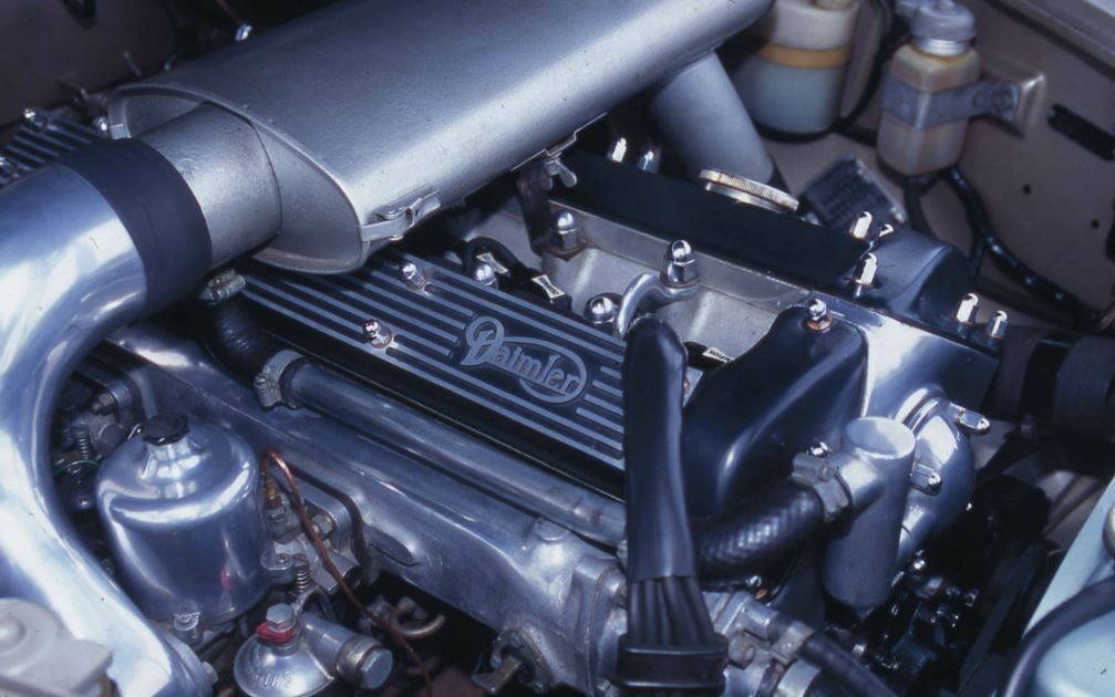

JB ~ 420 separate upper tank on top of crossflow radiator, It's how Jaguar built them & the Daimler Sovereign. No issues de-aerating the system.
No idea why this car is fitted with a non Jaguar or Daimler oil cap. They took the trouble to make Daimler ribbed covers.
Early LHD car before the ribbed the cam covers.
Daimler Sovereign Ribbed Cam Cover fully cast & machined ~ no sticker.

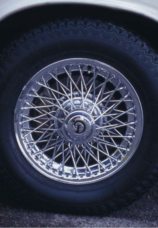

You could well be right Bill & JB. They went to the trouble of making a Daimler ribbed cam cover & no oil cap ~ seems crazy. But so do many things in the BL & onward years. The Daimler ribbed cam cover is a fully cast & machined item on a purely XK engine. Why go cheap on the cap????? The Daimler spinners on wires were also the genuine article sans ears like the Jaguar spinner. A global car mainly for the local market. Benz protected the Daimler name elsewhere. It just makes no sense but that was BL for you. The Sovereign was the first fully badge engineered car. Nothing Daimler about it. At least the V8 had a Daimler engine.
Daimler Sovereign wire.

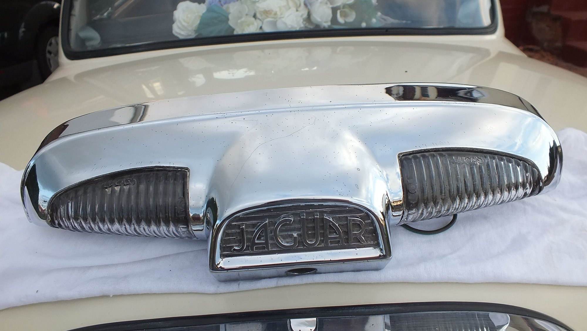

I was talking to a friend who owns a Daimler Sovereign version of the 420 just recently. He asked me if in my box of many parts if I had any Daimler badges. I asked which ones and he stated that he required the glass Daimler badge that went on the rear chrome plinth over the number plate. Now I thought that there would be separate chromes for the Daimler and Jaguar but apparently his Daimler badge had come off and been lost and underneath was the Jaguar badge as per the S type and 420.
So it appears that rather than making two rear chromes, they only made one for the Jaguar and fitted a glass Daimler badge over the top of the Jaguar one.
Jaguar S type and 420 plinth
Daimler Sovereign plinth

Originally Posted by Cass3958
I was talking to a friend who owns a 420 just recently. He asked me if in my box of many parts if I had any Daimler badges. I asked which ones and he stated that he required the glass Daimler badge that went on the rear chrome plinth over the number plate. Now I thought that there would be separate chromes for the Daimler and Jaguar but apparently his Daimler badge had come off and been lost and underneath was the Jaguar badge as per the S type.
Jaguar S type plinth
Daimler 420 plinth

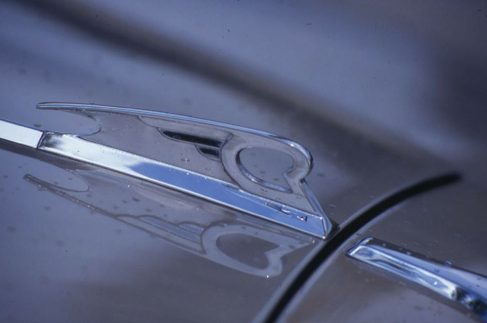

Cass. Yes & no fluting like the Mk2 derived Daimler. Only the grill was fluted. I always thought the Sovereign was a very handsome car with all it's extras as standard right down to it's perforated centre on the seats upholstery (higher quality Connolly hide than the 420). And use of better veneer on the woodwork. Of course you had to pay! It was only built for 2 years/seasons but added another 4000 cars to Jaguar sales that they may have lost to Rover etc.. We have very few in SA as they were a full import. A Friend has a Primrose Yellow one.

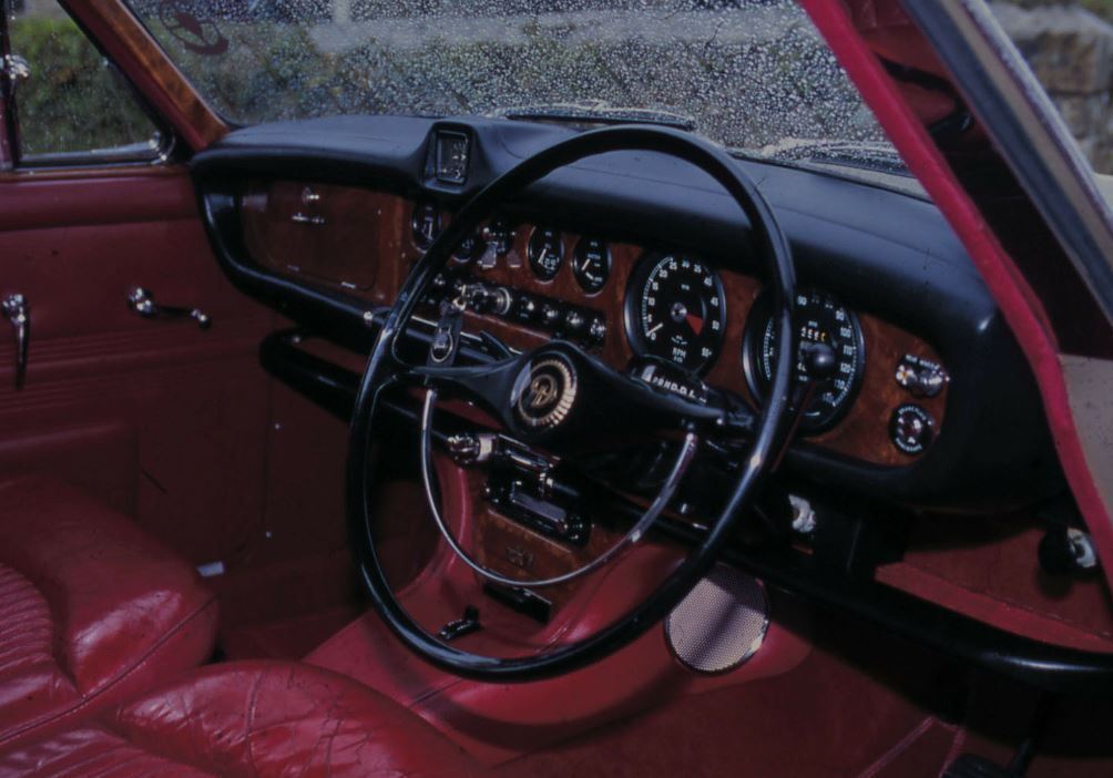

The Flying Winged D
Daimler Dash.
