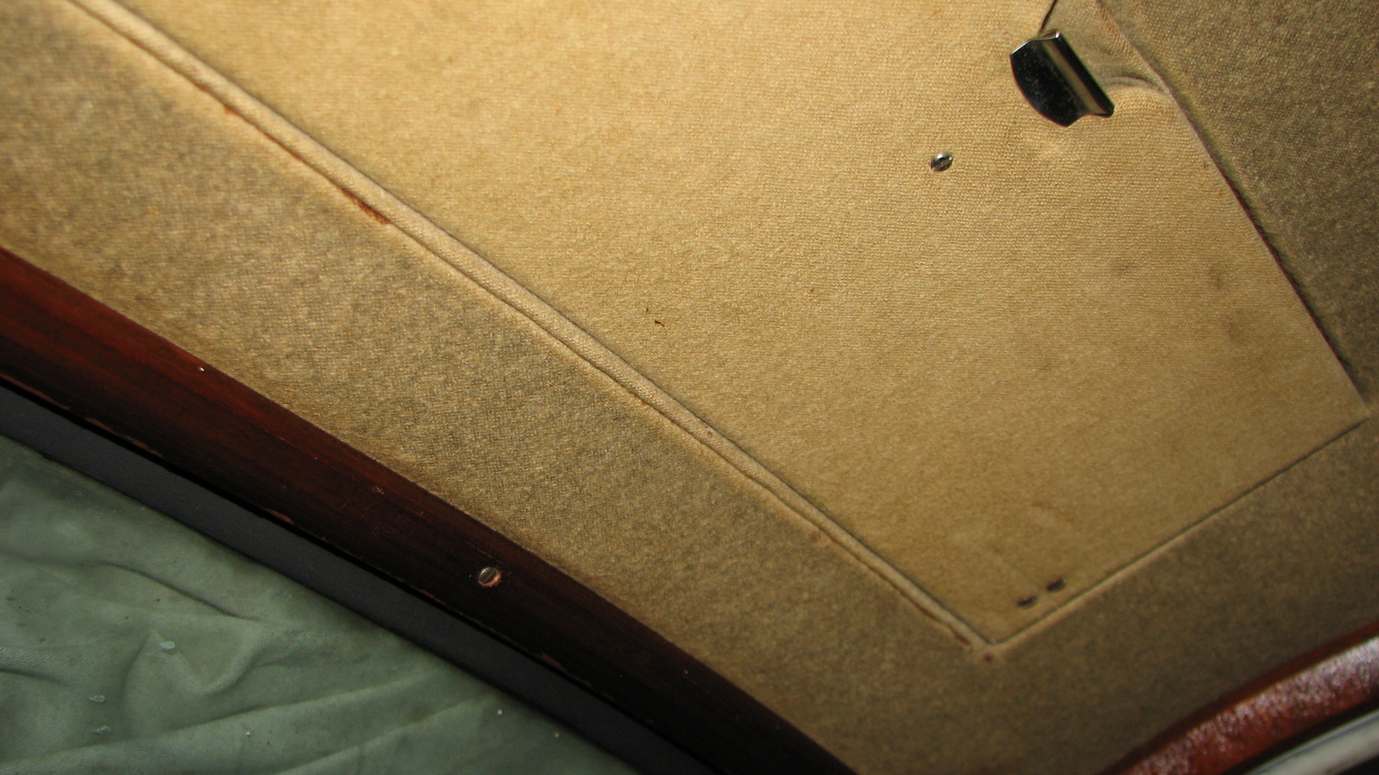

csbush,
here's what I have on visor pics. I can take some of the visors out of the car and the hardware if you like.
Attached Thumbnails 67 MK 2 restoration-img_2025.jpg   67 MK 2 restoration-img_2026.jpg   67 MK 2 restoration-img_2027.jpg   67 MK 2 restoration-img_2028.jpg

Thanks very much for the pictures. I would appreciate pictures of the visors and hardware. They are different from what I thought.

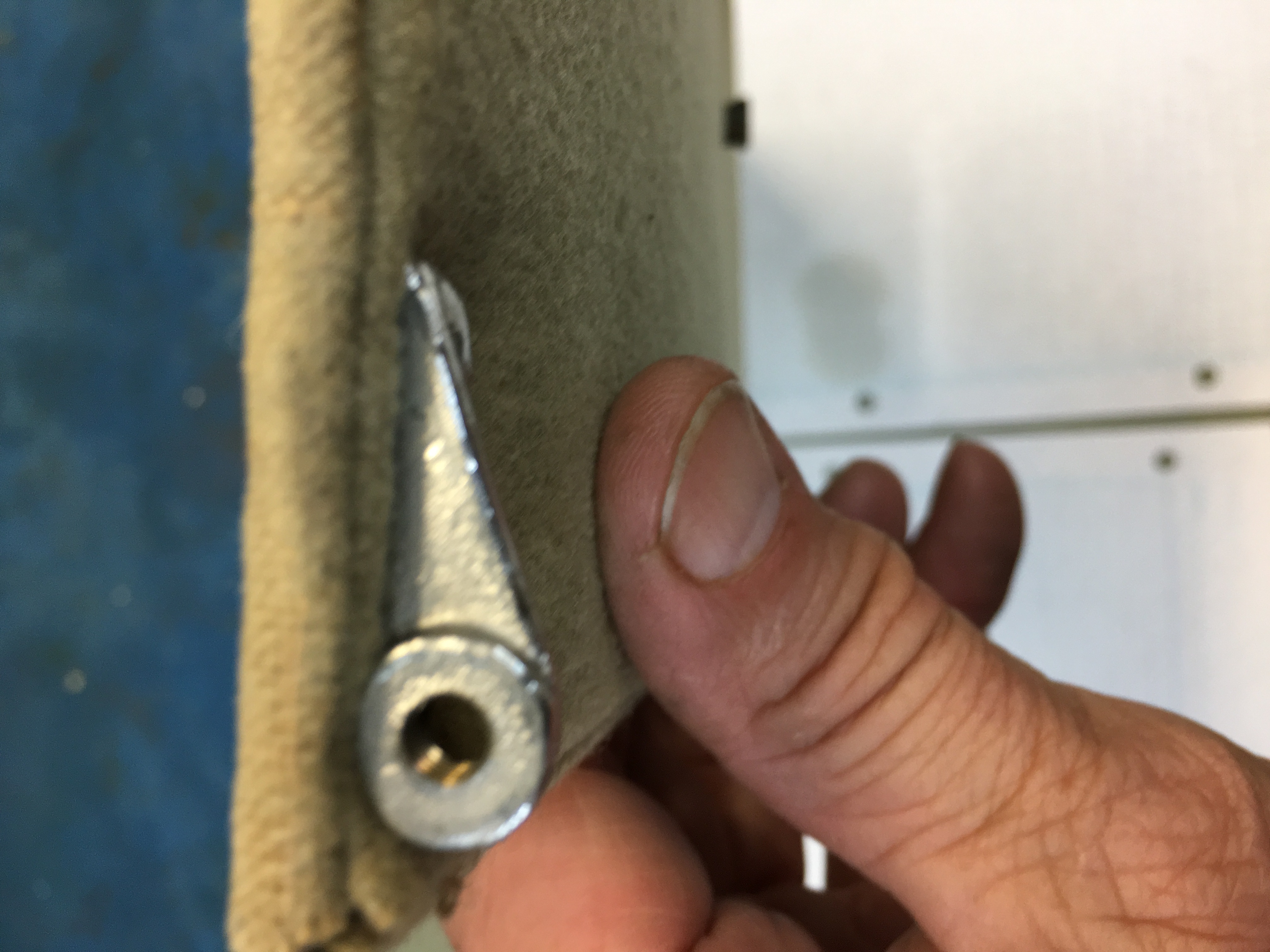

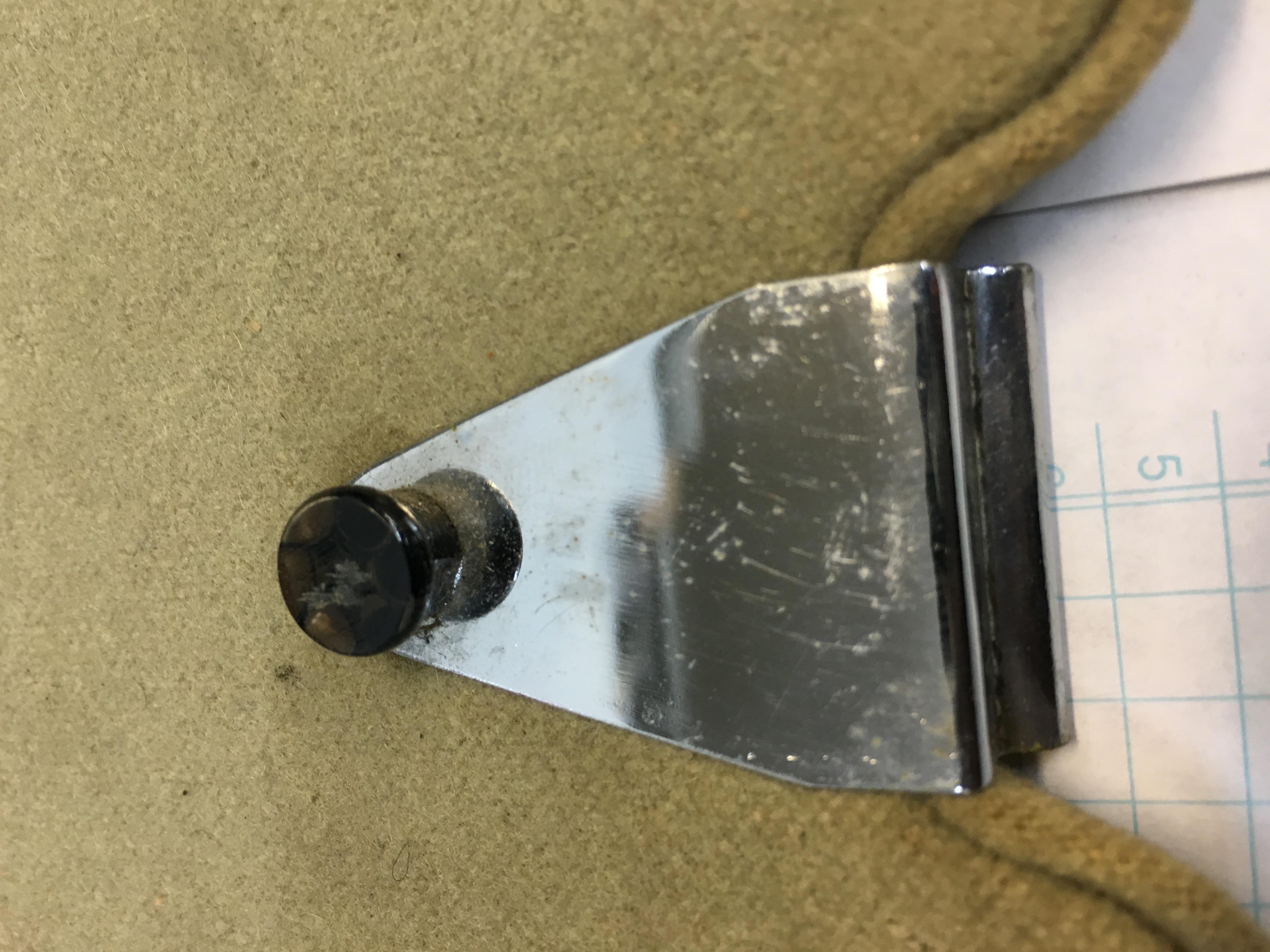

Here's the visor pictures I snapped today. Hope this helps.
Attached Thumbnails 67 MK 2 restoration-img_3842.jpg   67 MK 2 restoration-img_3843.jpg   67 MK 2 restoration-img_3844.jpg   67 MK 2 restoration-img_3856.jpg   67 MK 2 restoration-img_3857.jpg

Thanks so much for the detailed pictures. I'll have to keep an eye out for these parts. I wonder if these are unique to the 1960 MK 2 or a carry-over from the MK 1?

Your welcome.
Might be carry over. I do not know anything of the mk1's. The car was ~2000 of 4000+. It did have stamped steel upper control arms.
The visors are cool. I'm putting the wood back in, and the visors - not much else.
When you read about jag, they used up everything. If they were out of a screw, down to the hardware they'd go. The aluminum sill plates were held on with three different fasteners.

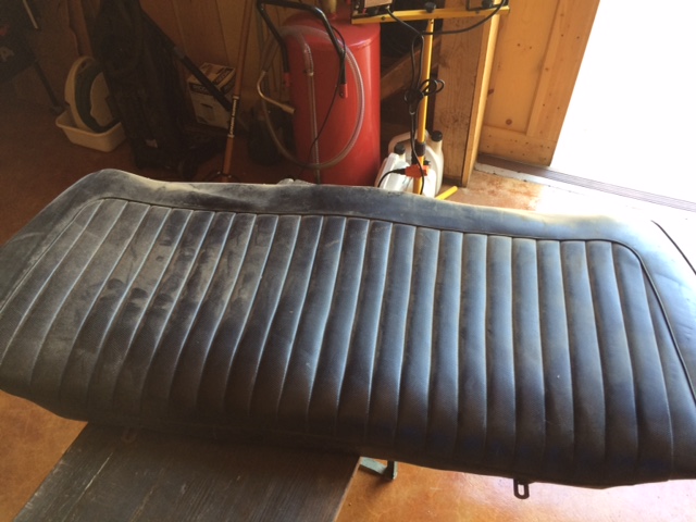

Still making some slow progress. Half done with the welding and paint stripping on the body. Making progress on the upholstery. I have finished the back seat, and am starting on the front seats.I am motivated by the smell of the old ones stinking up my workspace. I stripped the seat back and repainted the frame.The seat back I bought did not have a center armrest in it, but I also bought one of those off Ebay. Eric’s blog (Kriss Motors) on how he did the upholsteryhas been very helpful. With the seatback now fully finished, I can focus on the front seats.The seats I have did not come with the picnic tables so I was hoping Eric’s blog would help me figure out how to install them. Unfortunately he has different model seats. His seat back is flatter across the top, and has a board on the back.The seats I have are a little more curved on the top, and have a large rubber trampoline like device to provide the spring for the back of the seat. I’ll have to fabricate a metal piece to put across the top of the seat to make it flat enough for the picnic tables. In the meantime, I’ll sand and paint the seat frame to get it ready for the rebuild. I took about 50 pictures to remind me how it all goes together and where all the clips, nails, and hooks go. I have the bottom spring all cleaned and de-rusted, primed and painted, so I am ready to start its re-assembly. Fortunately that part is more like Eric’s so I have a good guide to follow. Here are a few pictures of the back seat, and the front seat dis-assembly.

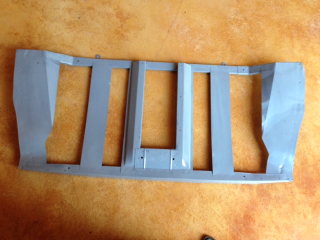

Finally got some time to work on the body. I fixed a rust spot that had been hidden by the back window. That leak around the back window an likely other places did some other damage that I discovered today. The back seat pan was worst than I thought, so I am going to have to fabricate some pieces. The spare tire holder is also worse than I thought, so I am just going to cut the whole thing out and replace it since SNG Barratt sells a replacement piece.
Seat pan is pretty bad- the frame pieces underneath are just fine.
I thought it had a few holes I could weld up- nope.
