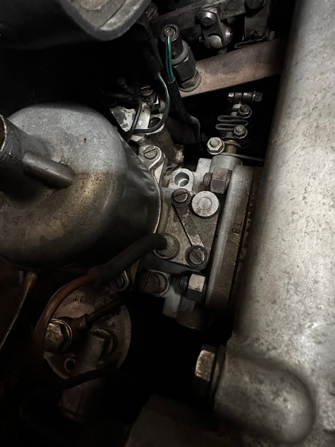

I have it on a charger now and poked around a little under the hood. I noticed fuel at a high level in the body of the auxiliary starting carb. Will try to attach a picture. I’m finding discussions online about whether this is normal or not. It does seem higher than the float bowl level and seems to be above what I thought was the air intake. Is this fuel height normal in the Mk 2? Could this be related?

If you happen to flood it go to wide open throttle. Foot to the floor. Ensure fuel pressure does not exceed about 3psi or go too low. SU's are fussy. Pressure too low & still won't start. Don't be mislead by fuel in the filter. Does not mean a bucket of beans. Constant depression carbs have their own foibles. e.g. Quite the opposite to a Weber sidedraught carb. My car is still using it's original red genuine Otter brand switch & works perfectly. 90,000 miles before concours rebuild. Luck of the draw.
Reset needle on your AED for ambient conditions. Different Summer to Winter in many climes.
