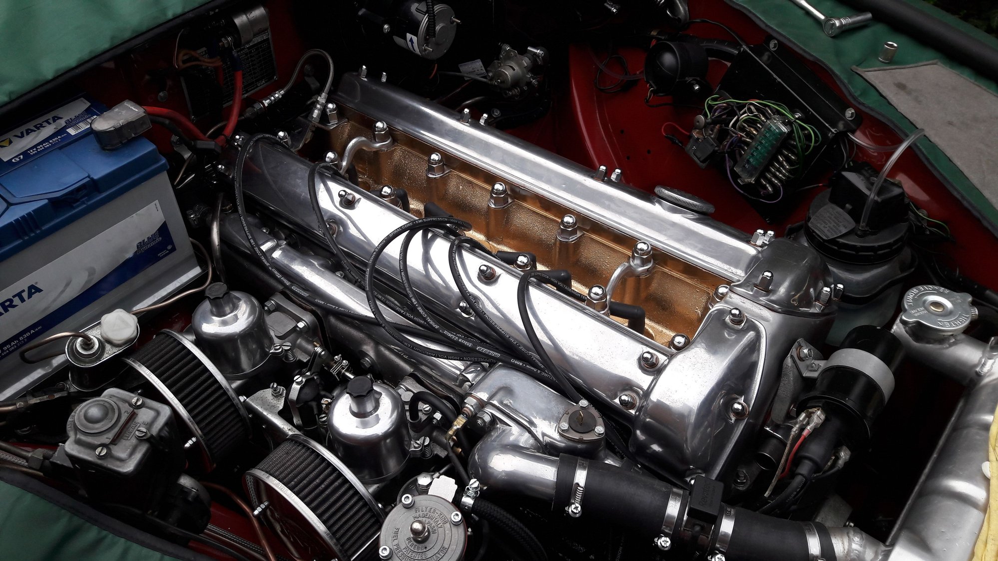

Thought I would update everyone who helped with my problems.
The starter motor had two issues, first one was the nuts were only finger tight and second it had water in it from a leaky inlet manifold stud directly above. Was impossible to get out with carbs in situ so luckily they were being removed. Fitted a WASP starter which had studs attached and connected from the rear instead of the front so easier to remove next time. Second issue was the leaky carbs which turned out to be a sunken float, it had just come back from a rolling road tune up who had just backed the other carb off to compensate the over fueling front carb. Nice work guys, nothing like doing a solid job and that is nothing like doing a solid job. The water around the plugs had come through the centre chrome strip when it was last washed so thats a lesson learned. The Helicoil situation had to be sorted, so we removed the head and sent it to a firm in East Dulwich who did a grand job, they also found a damaged exhaust valve which explained a lot. Although not what you want from a newly rebuilt engine but such is life.We are still having to sort others mess out be the worst is now over. Anyway head back on car, apart from slight leak from offside oil banjo bolt all is good and was dyno'd last Wednesday and now running as she should of been a year ago, so thanks to all who offered advise and to those who are just starting down this road my advise would be to stick with it as it will be worth it in the end.
Almost there now, just in time for summer.

looking very swanky I must say, well done for persevering, such a shame that sometimes you don't get the service you expect.
