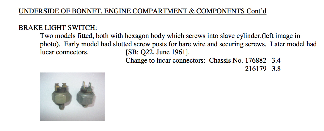

It's a hydraulic activated switch in a brake line near the servo under the bonnet. Actually quite a common switch. Bring it into you local auto parts store and they should be able to match it up.
Before removing the switch, cross the two wires going into the switch to make sure your brake lights then light to pin down the switch as the problem.

It looks like a medium-size nut with 2 wires coming out of it. (see pic) I don't think they go wrong very often. Usually a wire has come off or frayed off. Clean the contacts. May be okay. $10-$15 if you need buy one.
