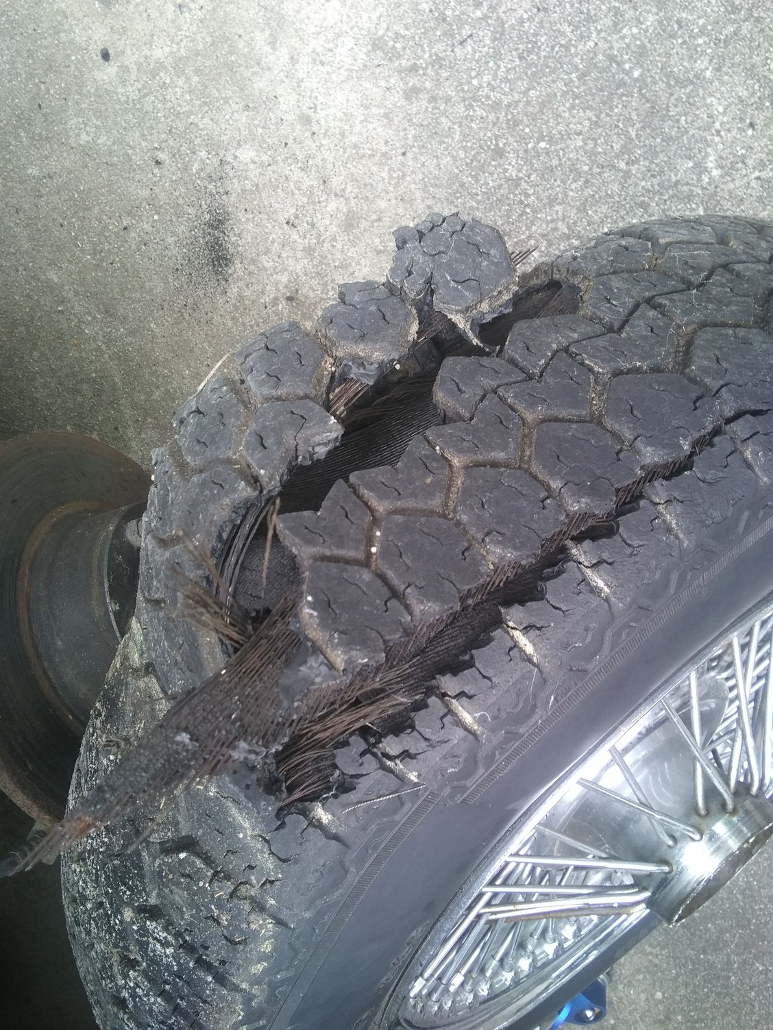

Yesterday was a warm, sunny day in Atlanta (85°F), and I was out in the garage, touching up some paint on my daily driver. Suddenly, I heard what sounded like a 12 gauge, or a hand grenade go off just outside. I mean LOUD! Walking outside I saw what looked duck feathers floating down, and a 'blast zone' near the front of my project Mk2. The front tire had literally exploded. It was in the sun, and I had probably overfilled it over the winter, to ease rolling the car around. I never dreamed a tire could explode like this, just sitting unused. This tire had been the car's spare, and although it showed no visible dry rot, a close exam showed it a Brazilian "Monarch Sport 165R15"..........dated Feb. 1979!

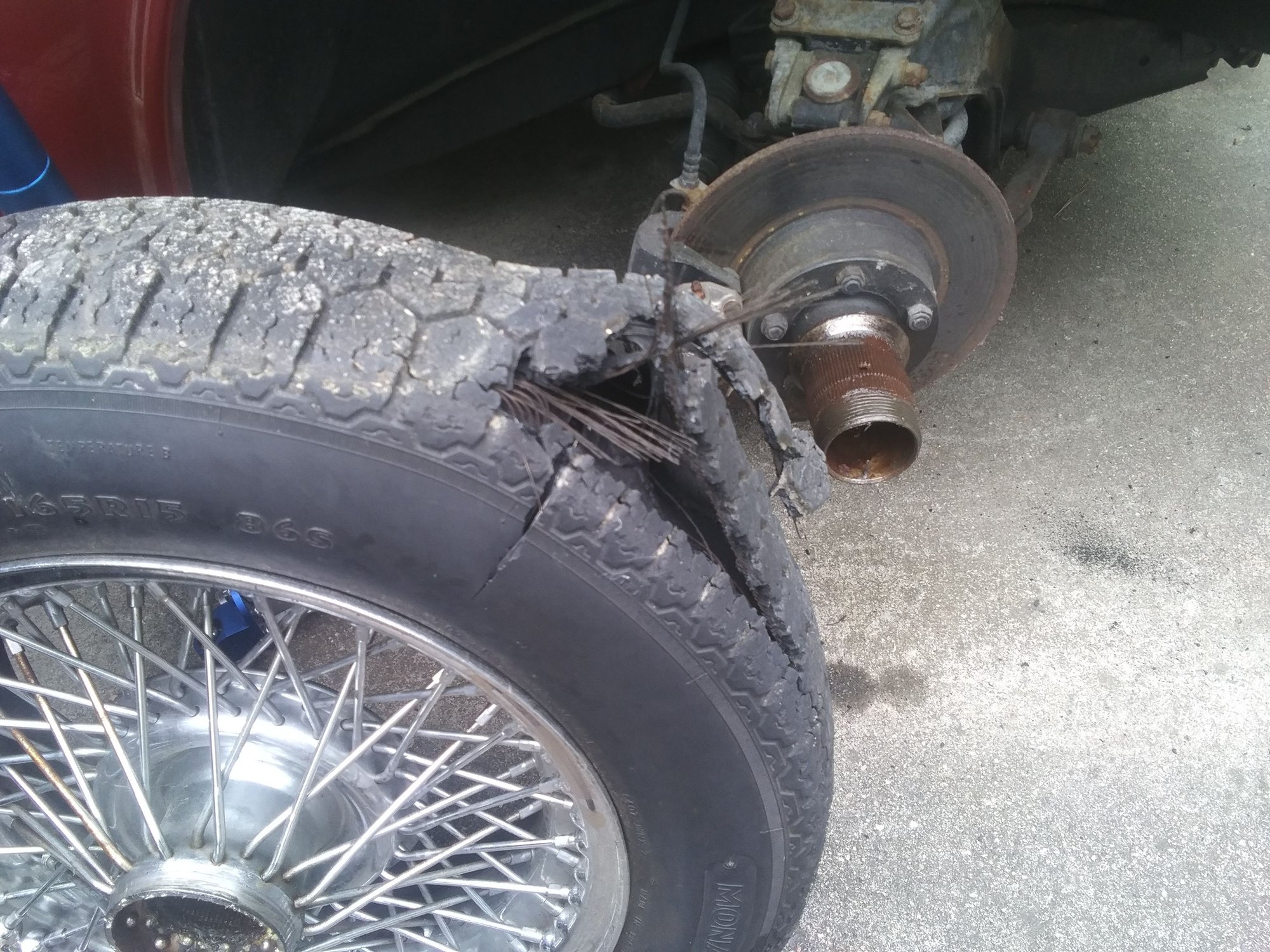

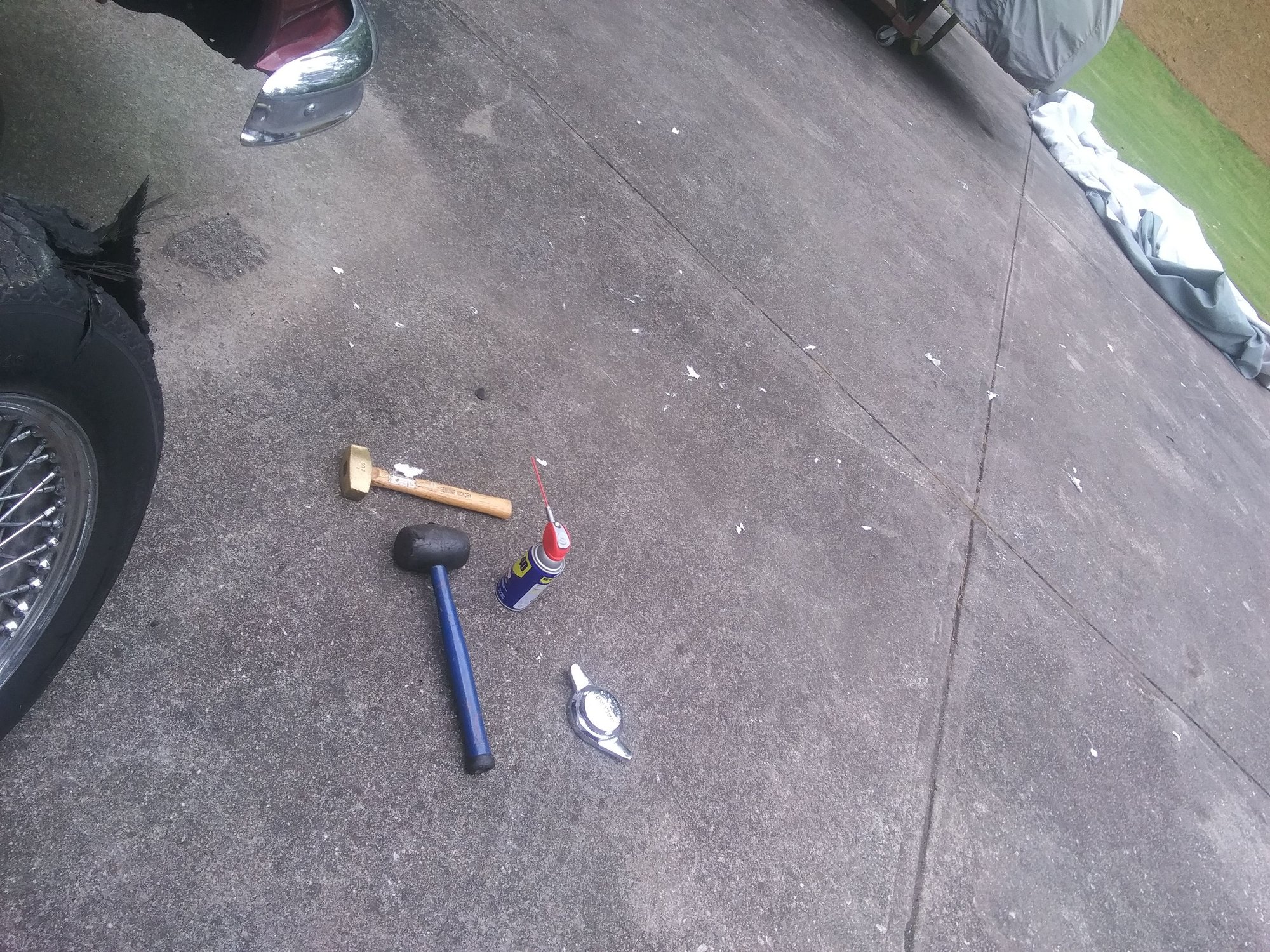

The "duck feathers" were bits of the Tyvek car cover, which blew 16 feet out from the car.
The steel belts were shattered.

That tyre was grossly over inflated to break the steel belt or had a fatal flaw in manufacture or the sidewall would have let go first..

looks like the steel belt rusted away to me.
well, THAT... and a whole lot of pressure.
The steel belt is certainly corroded but still should not be first to fail. The belt is also of strange manufacture. Why Michelin is the largest tyre manufacturer in the world by tonnes of rubber milled. They make everything from dump truck & LHD tyres, to car tyres to bicycle tyres. People are prepared to pay for quality.
