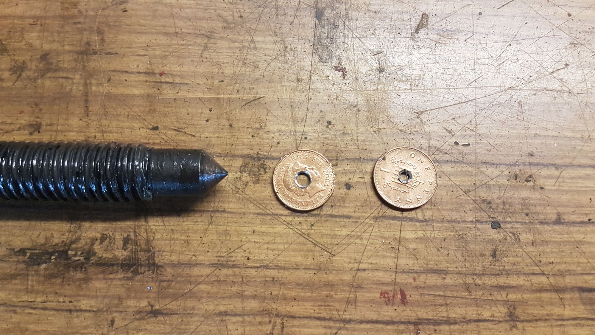

Picture of the adapter tool for the OCT puller.
It should be snugged up just lightly on the axle with lot's of grease, you want the grease to ooze out as it's threaded on and tightened.
Same with the puller, lots of grease in the threads and where the end of the puller makes contact with the adapter.
Just don't grease the shaft, unscrew the shaft and grease the female part of the puller too _ get plenty of grease in the threads, just don't assume it's going to be enough.
The adapter was made from a fitting at a custom hose and hydraulic shop, it came threaded that way, I just had the machinist face it off and centre drill it to fit the puller.
If you try and use the OTC puller with out the adapter, the puller does not fit the axle at all, it will move sideways and bend the axle.
Yes, the puller is struck on the end of the shaft, it's designed for that.
Whack it one or two good ones _ tighten it up and continue, it will come off.
The brass (or copper) inside the adapter is to protect the axle from the pressure of the puller, you don't want steel on steel contact.

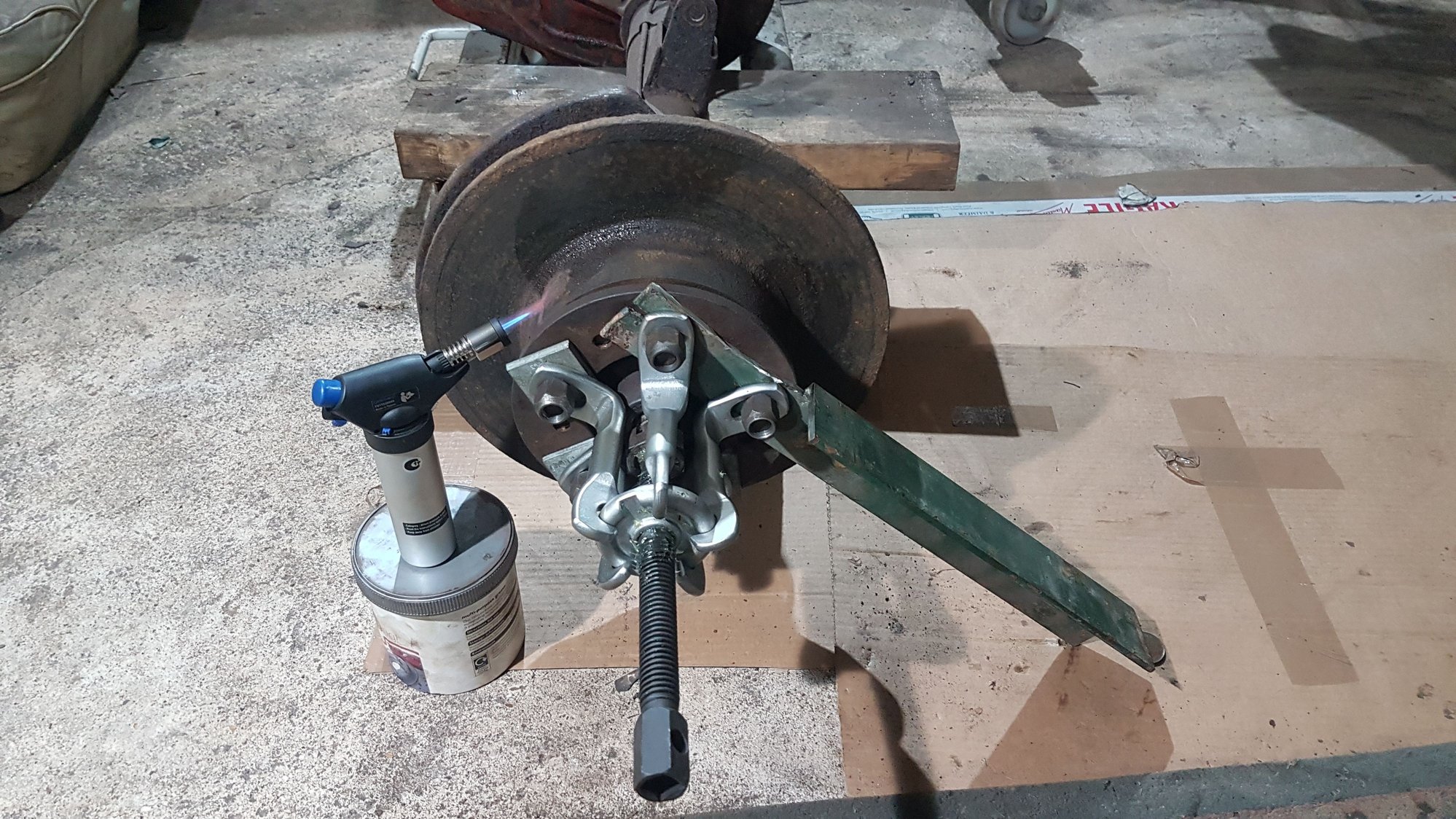

Well, it finally arrived, 'H' Day. The day I'd been half dreading, half excited about. Time to pull off those pesky hubs. I'd gathered every bit of info I could, searched every Jag forum, scoured the internet and asked everyone online for advice. I had set aside this weekend to 'do the deed'. I bought a reasonable hub puller from Amazon (
Amazon Amazon
), as they have excellent after-sales, I knew if I spannered the thing, they would always give me a refund. It was more expensive than most, but certainly not as expensive as the models I'd been recommended that were out of my price range. unfortunately, I simply don't have the budget. So, armed with my 'In-Budget' puller, a wealth of second-hand knowledge and that sickening feeling in the pit of my stomach, I set to it. I cut a suitable piece of angle-iron to act as a backstop to prevent the disk/hub rotating as I applied the pressure. The additional metal meant that the puller arms were uneven due to the thickness of the arm, so I dug out some suitable spacers for the remaining 3 arms. I tooks some time to assemble the puller onto the hub to ensure it was central and true. After a recommendation from JeffR1 to use a special tool with copper/bronze end to pop onto the end of the shaft to prevent damage, I attempted to make something resembling it. I used a couple of old penny's (sorry Queenie) into which I drilled holes to accept the cone end of the pullers centre pushrod to prevent it from drifting. Luckily they are the correct diameter (almost) to just pop in. And again, as advised, I plastered everything in grease to prevent things grabbing. I loaded the puller with a fair bit of pressure with the aid of my 24" breaker bar, but not so much to really stress things. Then I applied some heat. I pointed my blowtorch and heat gun at the disk and left it for an hour. It was enough to make the disk hot, too hot to touch for sure, but even with both of them, it was never going to be enought to make them get red hot. Anyhow, after the hour had passed, I decided to have my first attempt. I loaded up more pressure on the breaker bar, and after every extra quarter turn, a couple of whacks with my lump hammer. After a few turns, and at the point when I thought that things were starting to get a little stressed, an almighty crack and off it popped. To say I was jubilant would be somewhat of an understatement. So, with my heart in my mouth, time to see what exactly had gone 'crack'. No problems, the hub had released, no damage at all to the shaft and I dismantled the whole lot and everything was good. So, with my 'Winning Formula', I started on hub number two. The first two pennies were destroyed, so another couple were sourced and drilled and inserted to await their fate. I cranked it up and applied the heat to the second hub and waited the statutory hour before trying again. This time, before I'd really loaded up too much pressure, after one of the whcks on the disk, off it came in a far less explosive pop. I was slightly underwhelmed by the lack of drama, but no less satisfied that I'd actually got both hubs off in less than 2 and a half hours. So, there you have it, all done, no damage to the shafts (which was always my main concern) and on an outlay of only £43 (oh and 4 penny coins).
A real 'Thank You' for everyone's advice and encouragement, I really do appreciate it. Next job is to find someone to skim the disks, well, actually they don't need skimming so much due to wear, just a clean up and more to ensure they are true than anything.
