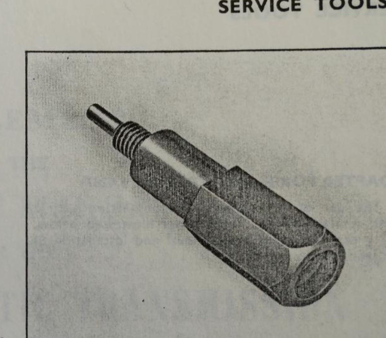

Hi to everybody
I am looking for a Churchill tool J.4285 to make the band adjustment on a Borg Warner DG 150M/250 fitted gearbox?
Where to purchase this tool ?
Thank in advance
My best regards
Gérard

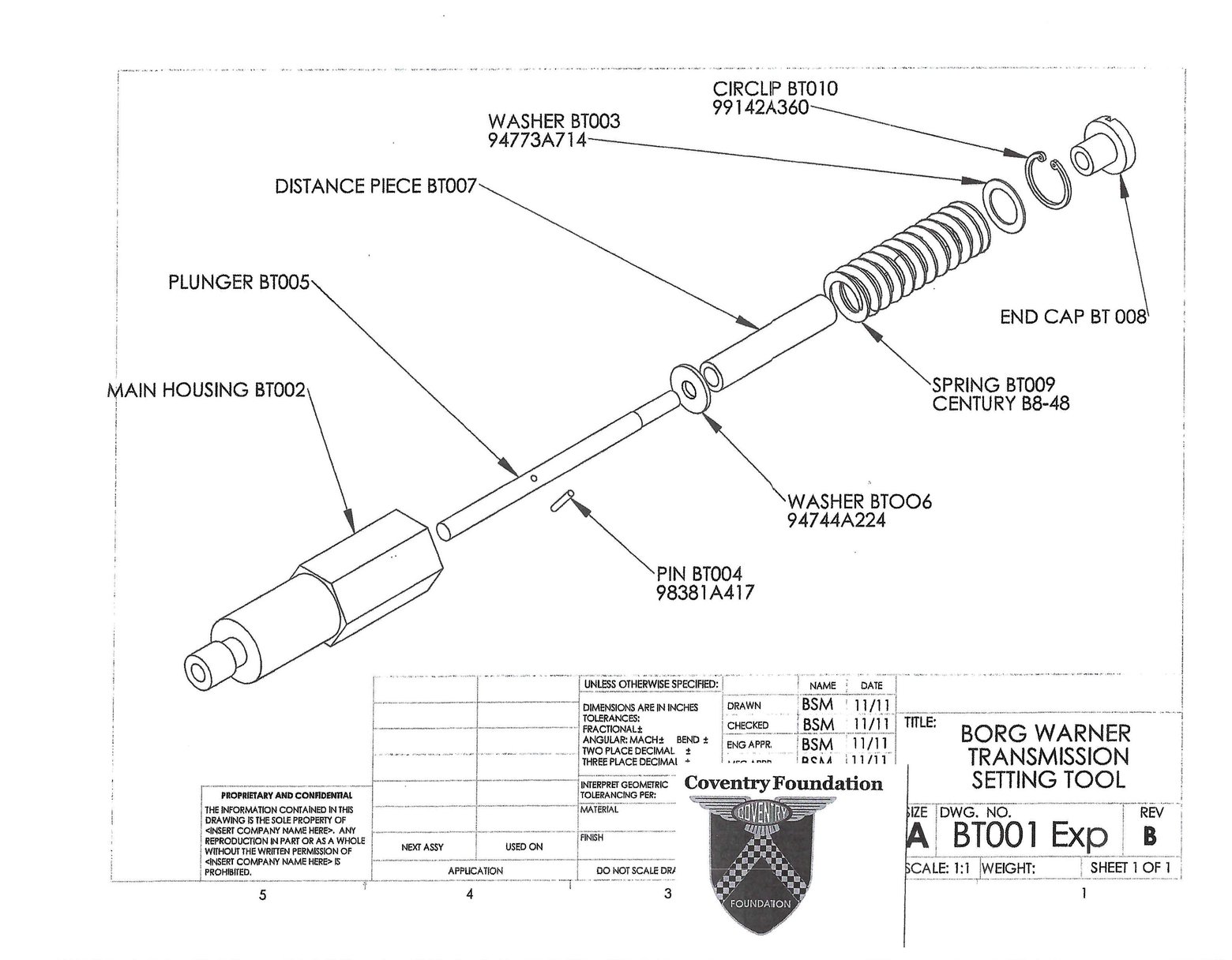

We have all of the tools including that one. WWW.coventryfoundation.org. If you are a patron of the foundation or a JCNA member we loan the tools in North America. Since you are in Paris we have included a drawing of the assembly for you. Hope it helps. You might consider expanding your search with the CBW.2B number. If (big if) there is a Studebaker club in Europe you might ask them if they have a tool to loan. Best of luck.

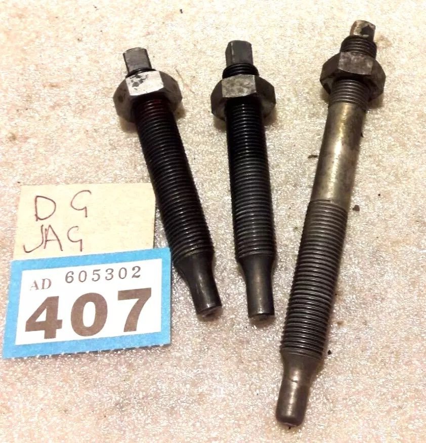

I have just bought a set of three Borg Warner DG auto gearbox band adjusters as in the photo below. Not sure if any of these are any good for you.
