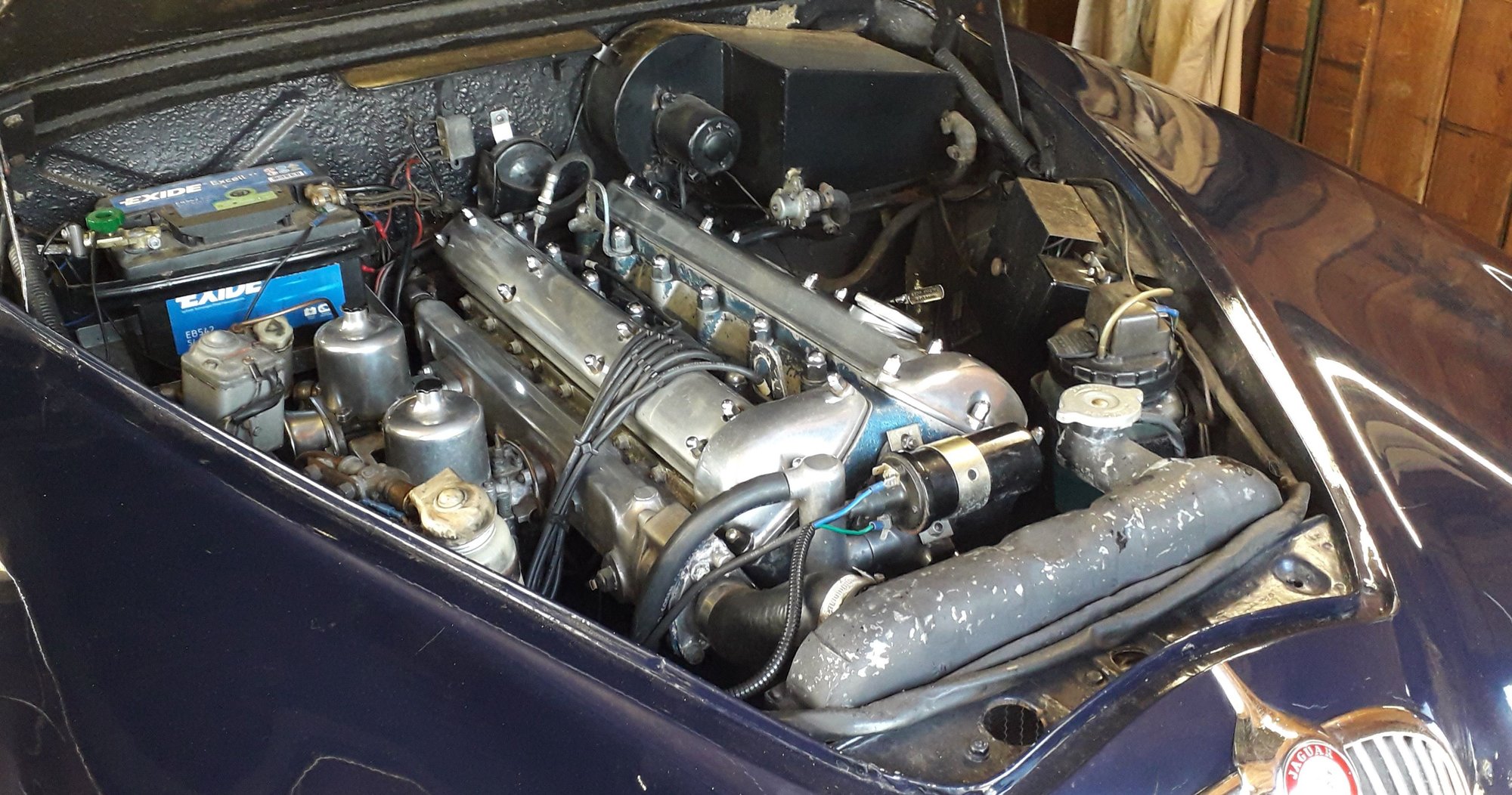

Think you're spot on. It's been an expensive lesson, but it is still fantastic fun to drive so I have had some fun as well. Am I also the only on who leaves the bonnet up in the garage just to look at the engine whenever I'm in there???
Absolute work of art. 🙂

I think that depends upon how well the engine bay is detailed.
Personally I don't leave the bonnet up myself, I've had my car for so long, I know what's in there.
I see it when I check the oil or inspect things when needed and, that's enough.

Condition is "Used" rather than detailed, but can't imagine this view EVER getting old. 😉

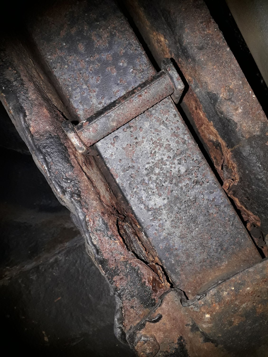

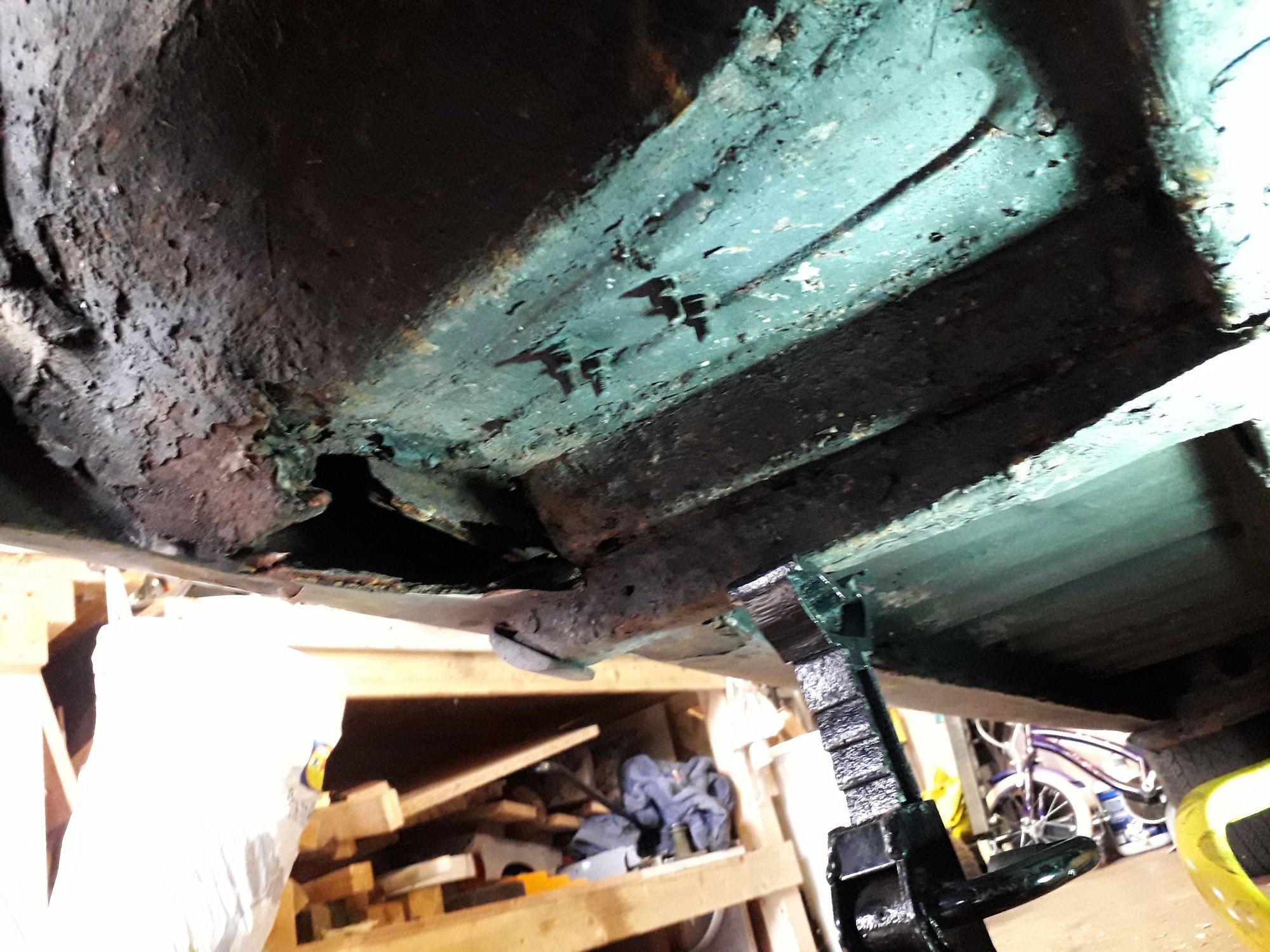

Thanks Homer for the pep talk. I really am in two minds. The rust is extensive (see photos for examples). There's also filler all the way down both inner sills & jacking points need replacing.
My welding knowledge is zero, so thought of doing that lot is daunting. Would need to fabricate a rotisserie first, weld in cross-members to keep the frame straight, then crack on. Definately food for thought, but concerned it may lead to indigestion. 😉

Not trying to put you off as I think you should have a go but what you can see is just what you can see. The problem with a Jaguar is the rust tends to start on the inside and work out rather than surface rust that creeps in. (Good external paint from the factory buts lots of bare metal inside the sills and chassis members.) Once you start pulling the rusty bits out you then have to find good metal on the car to be able to weld to which might mean taking a lot of rust out before you can start putting good metal back in.
If you do not think you are capable of doing the welding yourself then best not to touch anything. Leave it as it is and sell it warts and all to someone who has the money or the skills to do the work.

You can do that without a rottiserie although it does make it easier it also requires you to strip out the car which makes mroe work and more things to do and makes getting it on the road further away.
I restored an S-Type (similar up to the rear suspension mountings) and changed the inner and outer sill and jacking points just having the car on axle stands.
Personally I wouldn't brace anything unless the car seems really bad other than the B/C post as these flop around when the sills are removed, if you look at my MK2 restoration they don't come much more rotten and I didn't brace anything, just carefully measured it.
If you remove the rear spring hangers then I would make a jig (not a brace) that bolts onto the mountings so you get them back in the right place, again have a look at what I did on mine and what Voucherboy did on his.
Its easy for me to say as i've been welding cars up for over 20 years but that doesn't look too bad and as long as you are prepared to have a good and take your time its not past saving, beware that if you sell it and buy another one it may be just the same in a few years (or even now with a load of filler skillfully place in it).

Hey Simon, hmm, I've been watching this thread and typed a response a couple of times. It's clear that you have considered doing this restoration, so it's obviously an option for you and not something you've ruled out as being impossible. I can't tell you what's right for you, but I can tell you about what I've done. It was a little more clear cut for me, I simply didn't have the budget for a 'sound' car, so it was a restoration or nothing. If you are able to take the financial hit and buy a better model, that may be for you. But even more expensive cars may not be all they appear to be, as you've already found out.
I have quite a bit of DIY experience working on cars, but no welding and certainly nothing on the scale of this before. I knew there would be lots to do and I knew there would be more than I anticipated. I knew I would need to learn how to weld quickly, it's not difficult and does require practice but now I feel confident to tackle anything on the car. If you have practical skills, I'm sure it won't be a problem for you. I have also been able to fabricate many of the panels too, but some you simply have to buy, unless you have access to some expensive workshop tools. However, after doing what I've done over the last 8 months, I know there is no way on earth I could have done this without a rotisserie. I'm 54 and I wouldn't have been able to spend this much time working under the car. As Homer says, a rotisserie will require a partial strip-down, and for me the subframe, engine and axle had to come off anyway, but if it's built sturdy enough you shouldn't have to remove doors or windows, I haven't yet.
Looking at your pictures, the car doesn't look 'too' bad, certainly far better than mine, but as Cass3958 says, there will be more, so don't think that 'what you see is what you get'. BUT, the upside is, when it's done properly, it will be good and solid for a long time, almost certainly longer than whatever else you would end up buying. It will also give you a sound understanding of your car. As I say, I can't advise you, only you know what you should do, if you want to 'buy and drive, then maybe it's not for you. But if you are even considering this, then that tells me that you are probably the right person for the job.
Before you make any decision though, I would take some time to read through every restoration blog you can and get a feel what what's being done and how that work compares to what's required on your car. (don't be intimidated despite some of the pictures, they do look frightening). There are a few restorations on this forum, but also some on other sites. I won't post them here, but PM me if you want some external links.
Biggest thing, take your time and don't make a rushed decision.

No you arent Simon. Mine lives with its bonnet up. The engines are indeed true works of art.
