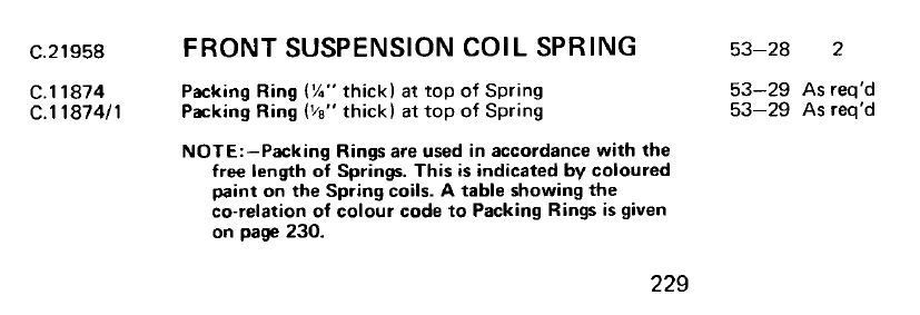

Jaguar did use spring packing rings on some cars (certainly S Types ~ usually driver's side). The fact that lubrication helps would lead me in that direction. The spring seat. Are you sure you don't have a broken spring where you can't see it. Presume all your bushings & ball joints are good on the wishbones & roll bar.
See 29
