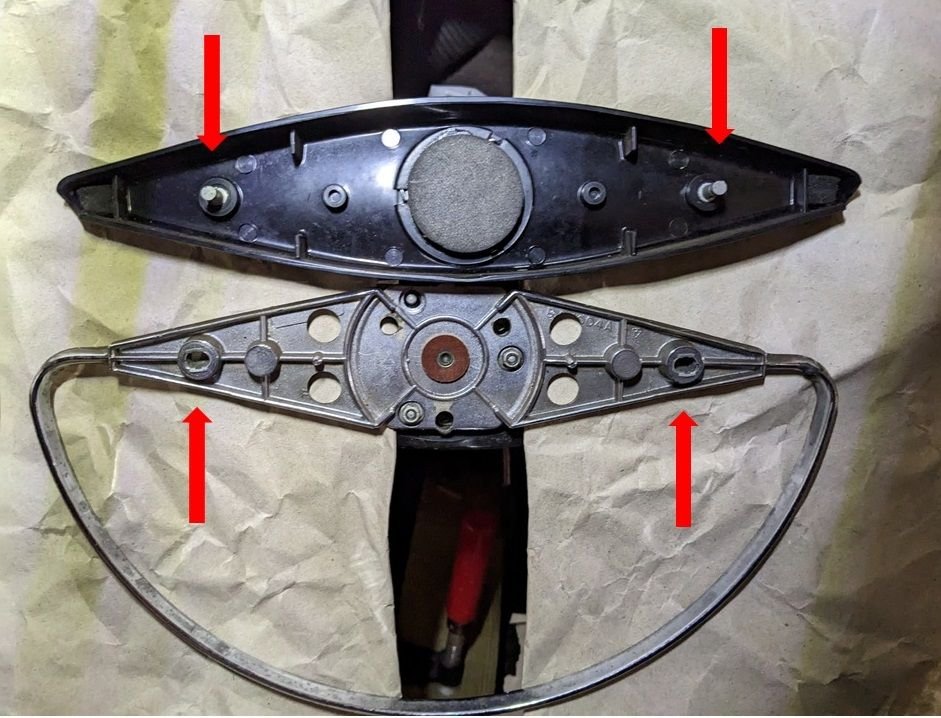

The black plastic cover (with the growler in the middle) on the old type horn ring is a push fit. There's a peg about two inches in from each end. The pegs push into kind of sprung catches in the metal part of the horn ring. To take it off: you grip the plastic cover about one to two inches from each end and, slightly more than gently, pull the plastic towards you (away from the wheel). It should come away nicely, probably one side before the other, and reveal the nuts and screws behind. As a piece of push fit car interior, it's actually reasonably comfortable for attachment and removal; that is, it's quite straightforward to do without breaking anything.

The red arrows indicate the pegs on the cover and holes with clips that I mentioned above

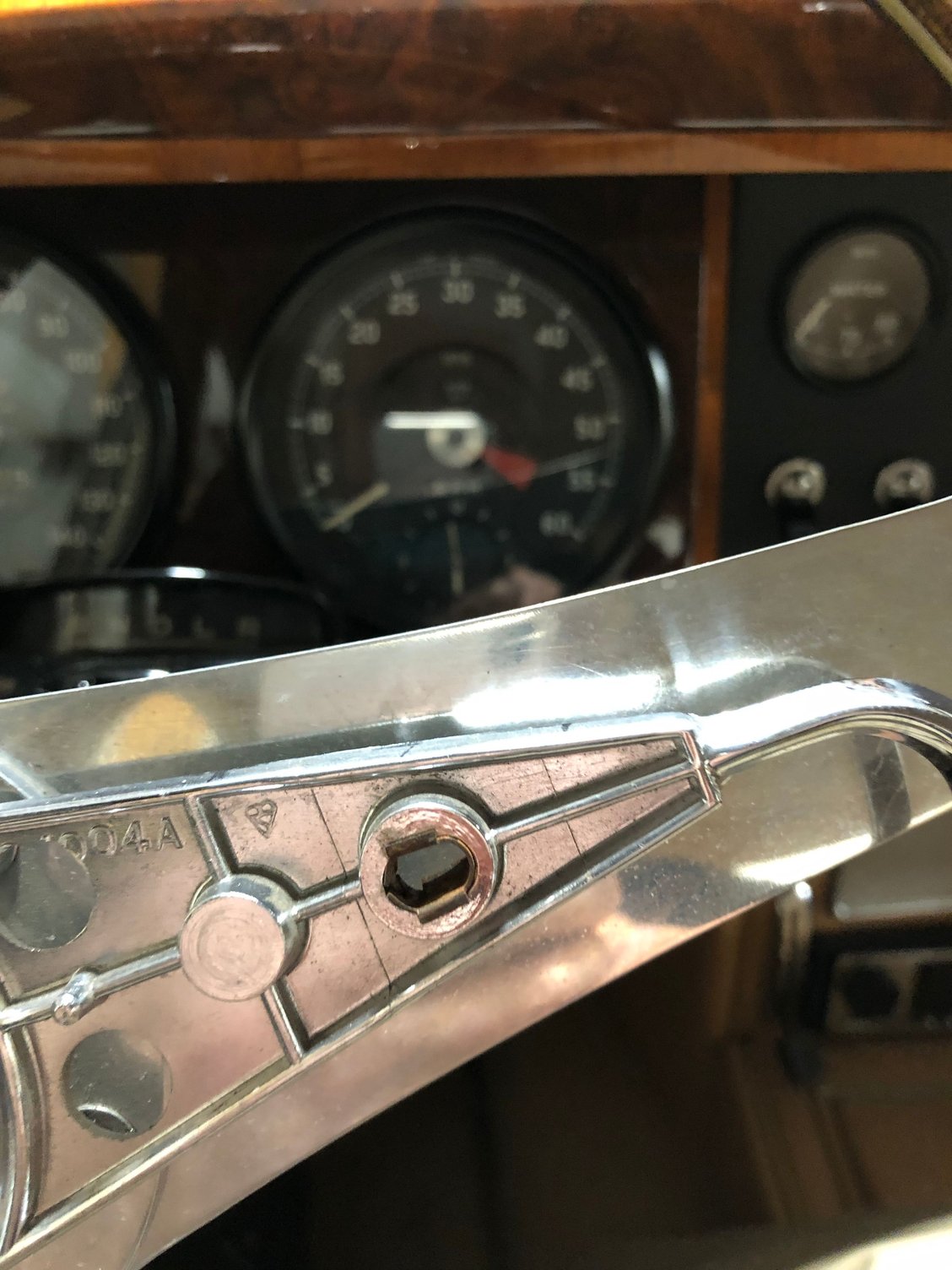

Success!! Thank you Homer and Peter, you were exactly correct. It turns out that the center section is in fact a snap fit and with careful pressure it popped right off. Here are some pictures.
I want to thank everyone who participated in this discussion. This is a wonderful resource and I am lucky to be a part of it and to have all of your support.

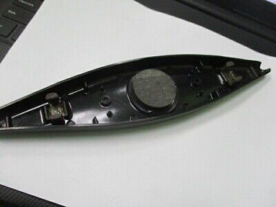

This is a NOS cover still in it's Jaguar packing from Homer's post. So were there multiple early clipping systems? The cover construction is different. I know that early car owners in our club complain that the cover falls off. Did they really use foam rubber to hold the centre emblem in place?

Windrush's car and my car have the same clips. Homer's clips are completely different though in the same position. Windrush's car is a 1962. Mine was first registered in January 1963, but came off the production line the month before. Homer's older Mk2 is a 1959. Was there an update? It's a minor point, but significant to someone looking for a replacement cover.

Seems they had multiple early systems until they settled on the 4 screws. No doubt due to the cover falling off.
