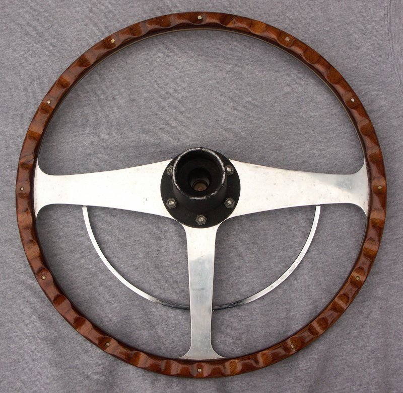

I probably misunderstood your directions but they didn’t seem to apply to my car. I am attaching some photos of the Derrington wheel as installed. Hopefully you can see that there is no way to access the area behind the horn ring to access screws. If I remove.the nuts from the back I still would not be able to tighten them upon re-installation. Am I missing something? Thanks again for you help.
Old Jan 21, 2023 | 07:25 PM
Glyn M Ruck's Avatar
Posts: 5,546
Likes: 1,493
Very strange. Hopefully Bill Mac will respond. He has a Genuine Derrington on his car. How do you get the 4 screws out that hold the plastic on. Very Strange. Bill was watching us correspond this morning. Aussies are like South Africans ~ not shy to speak up. He never said a word.
Genuine Derrington. The 4 holes for attachment of the plastic cover with screws are as clear as daylight. May not be a genuine Derrington or has an incorrect boss that covers the screw holes. How is the bloody plastic cover held on ??? That is a genuine early Mk2 plastic cover with the horn ring protruding from the ends and not below as with later longer wheel centres. It almost looks as if the Boss is blocking access.
Maybe you should loosen all the boss nuts first but that is not conventional practice. It's almost as if someone has fitted a spacer to stop the hornring from clattering on the lower spoke. The signature sound of a Derrington.

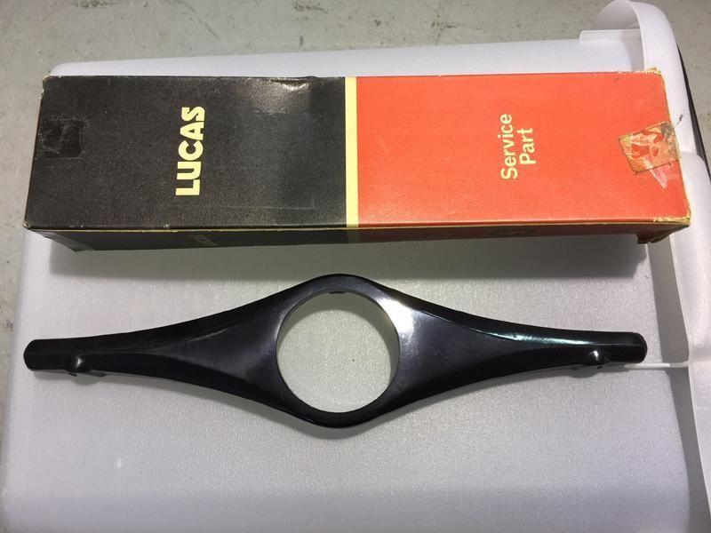

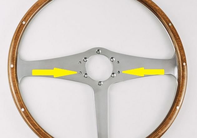

Original early standard Horn.
Later Derrington Horn.

Here is something to puzzle over. You must have to take off the nut's first even though I think it's been fiddled with. If this is an original.

One of the problems is that there are genuine Vic Derrington originals out there (not that many) and there is the Moto Lita copy that you can buy to this day that takes the B33C hub. Which are we actually talking about??? Bill has a genuine Derrington to my knowledge.
What makes me wonder is that the horn ring appears to sit proud of the lower spoke.
This has always been the standard Jaguar access to the horn cover & Vic always worked with Lyons. He even made the standard Jaguar woodrim for Lyons which are as rare as rocking horse droppings.

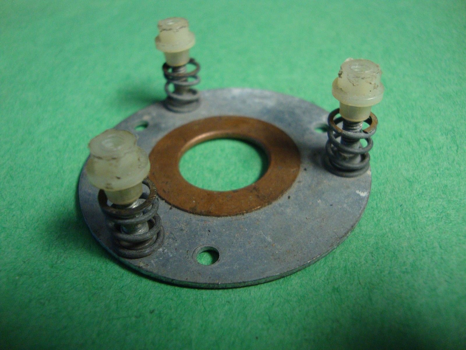

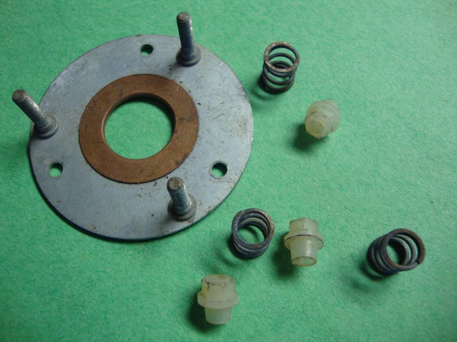

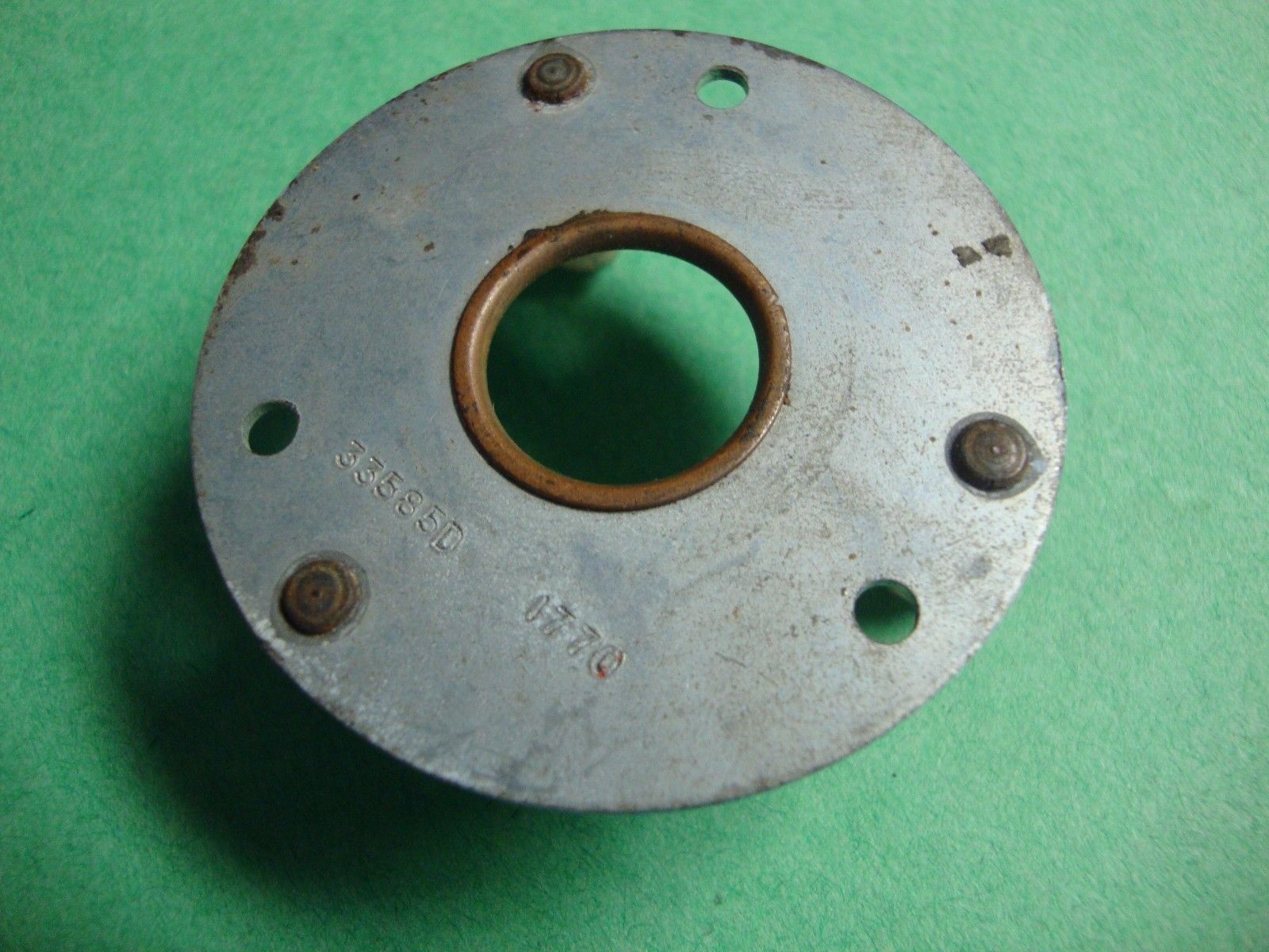

That looks to me like the early steering wheel centre that just pulls off rather than being screwed in from the back, my 1959 car has one of these and I recall its on two spring loaded clips, have a look at this which is what mine was and what I think you have:
https://www.ebay.co.uk/itm/185148027...iABEgL3DvD_BwE
Old Jan 22, 2023 | 07:11 AM
Posts: 5,546
Likes: 1,493
You may have just hit the nail on the head Homer. See standard later mount in my post above. Those very early covers the rubber? and/or steel clip would rot & they simply fell off. No doubt the reason for the move to the 4 screw mount. That was a very, very early cover on the old style fatter & flatter spoke wheel.
