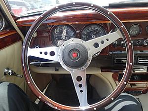

Hi everybody,
Ive got a nice dark blue 1963 3.4 Mark 2 Manual with no Power Steering. It lives with me in Sydney. While the steering is heavy on parking I have found that by using thin tyres (185) and keeping the tyres firmly pumped up (36psi) the steering is not so heavy.
Anyway I'm looking to replace the standard steering wheel with a 16 inch Moto Lita wood wheel. The ones I like are the E-type wood rimmed wheels. I have seen them on several cars though I'm not sure they were Moto Lita. Does anyone have this sort of wheel on their car? I'm finding it hard to get information on what Boss I would need, or even if it might fit. Surprisingly the people at Moto Lita are not sure either!
Thanks,
john

yes the E-type will fit. This website has a good overview text and pics
British Autowood > Steering Wheels
I just purchased mine from Ebay years ago, I do not know if it was Moto Lita or not but there are many similar ones sold at Ebay & Amazon that will work on a MK2. I attached the pic of the one I have on my 3.8s it was only about $175

John not sure how much of a purist you are but there was an optional wood wheel for the MK2--look for a Derrington. You may like the look Jaguar seemed to.

Tell those idiots at Moto-Lita that you need their B33 Boss available polished or black ~ its even on their web page. They can even supply you with their E Type horn push. SMH
Or you can go to SNG Barratts & they can supply you the Moto-Lita hub (Same hub) & accessories. They carry Moto-Lita. If you go to Barratts you can be assured of the correct hub & accessories. They will supply it as a B33H (thats the boss kit) I have one in front of me. It fit's my S Type perfectly. It will fit your Mk2 equally well.
Don't buy cheap. Buy quality. It could mean your life. Moto-Lita & Nardi (Itally) provide quality. I have a larger (second circle) Jaguar Coventry badge for mine.
Note Derrinton wheels require a special hub.

Note in the Motto Lita range. Derrington OE wheels require the following hub/boss kit. Available Black or polished.
Jag Derrington OEM B33C
£175.00 Excl VAT £210.00 Inc VAT
